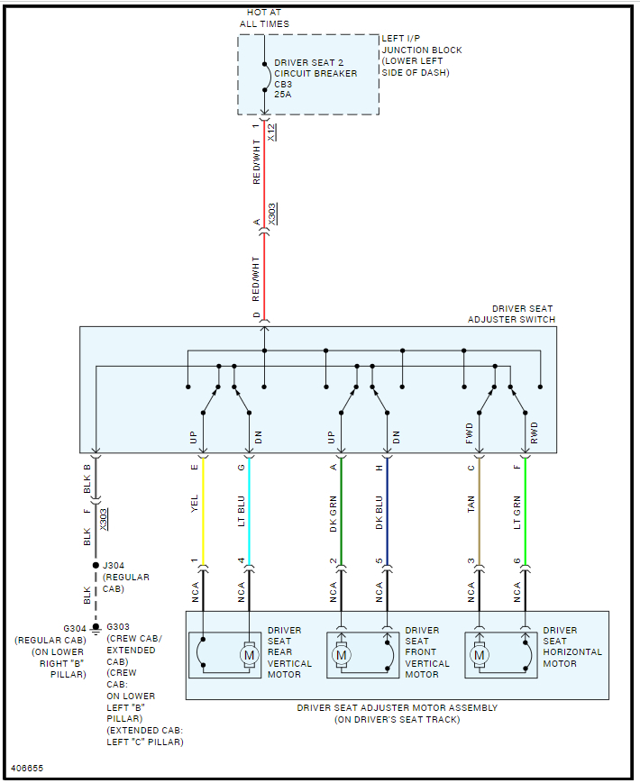

The front seat will not move forward or backward, can the seat motor be replaced?
2013 GMC SIERRA
115,487 MILES • 6.0L • V8 • 4WD • AUTOMATIC
RONALD DEVOLD
  • 134 POSTS
I removed it and tested the wiring and it’s good. The motor just makes a clicking noise when moving the switch backwards and nothing moving it forward. Can the motor be replaced?
Dec 7, 2023 at 6:37 AM
  • 55,399 POSTS

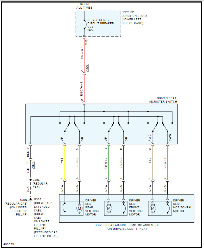

At the switch I would test the ground and power outputs when the switch is in the forward position. Here is a guide to help you with the testing. You may have a bad switch or motor as well.
Here are the seat motor and switch wiring diagrams to help. Check out the images (below). Please let us know what happens.
