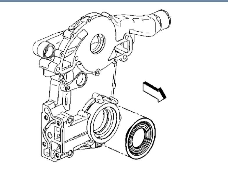

Do I have to relearn the crank if I replace the front oil seal?
Oct 19, 2020 at 10:29 PM
Good morning,
Since you will be removing the harmonic balancer, yes, it will need to be relearned.
I attached the procedure below for you to follow for the re-learn.
