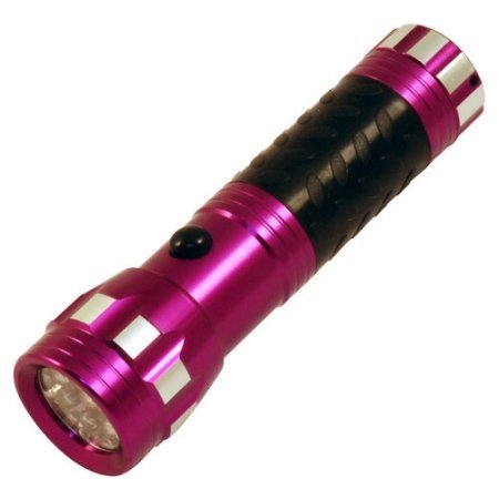

The 3.9 is known for bad crank seals, valve cover gaskets, oil filter adapter and oil pump drive oil leaks. Somewhat easier way to fin the leak is to get a bottle of UV dye from the parts store. Or online. Then get a UV light, these are handy for more than just oil leaks. One good one I've found that is much less expensive than most is a Rayovac 9 LED UV Flashlight it was 10 bucks at walmart! Wash/wipe the old oil off. Add the dye to the oil. Start it up and see what the UV shows. Just don't try looking out in bright sunlight.

This is what the light looks like.
