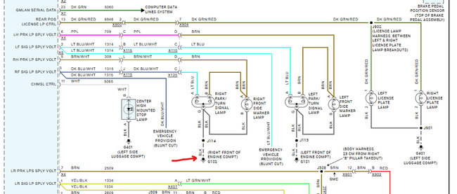

Hi I recently had my exhaust manifold replaced and when I got the vehicle back I had dtc for front right turn signal short to battery and my front right signal doesn't work and the rear hyper flashes when I did research it shows possible bad or lost ground I just need to know where that ground is located so I can find the issue wires to repair them?

Yep, that sounds like the problem. If it is the ground, then the right front running lights (both) will not work either FYI. The ground is a G102 and it is at the right front of the engine compartment. You should be able to follow the wiring harness to find it. Here is the wiring diagrams for the right front lights so you can see how the system works. Check out the images (below). Please upload pictures or videos in your response.
