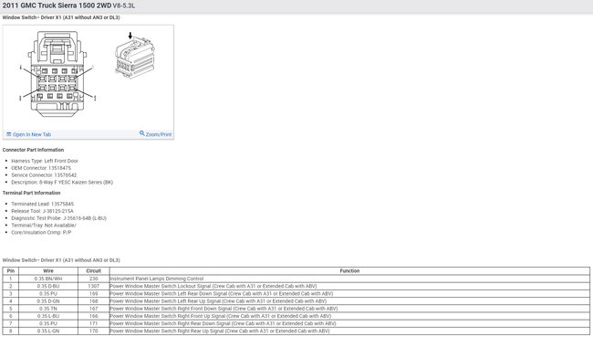

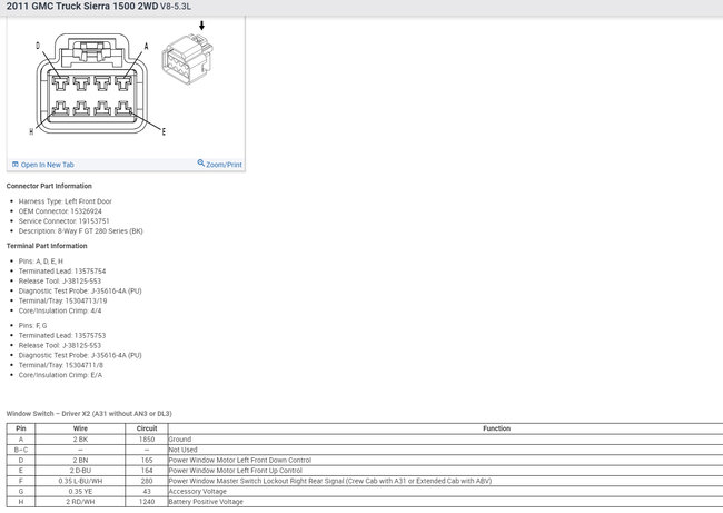

See attached for the power window switch pinout diagram. It shows each wire's location and color.
Let me know if you have any questions.

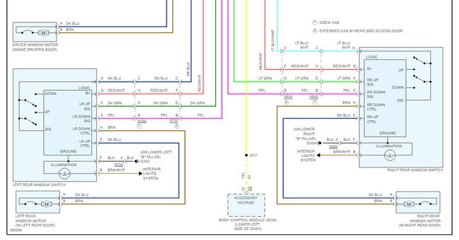

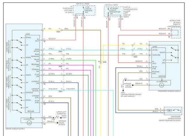

See attached for the wiring diagram for the power windows. This should help determining any wiring issue.
Here is a helpful guide on how to check wiring:
Let us know of any questions.
