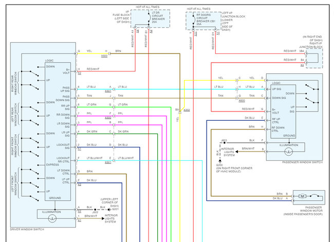

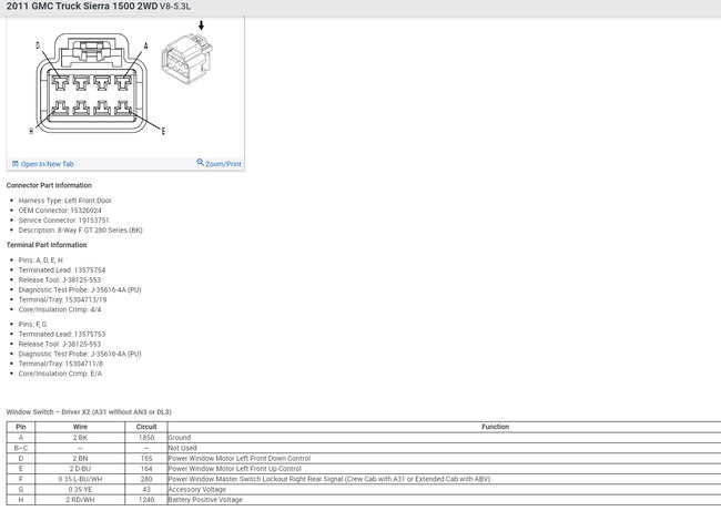

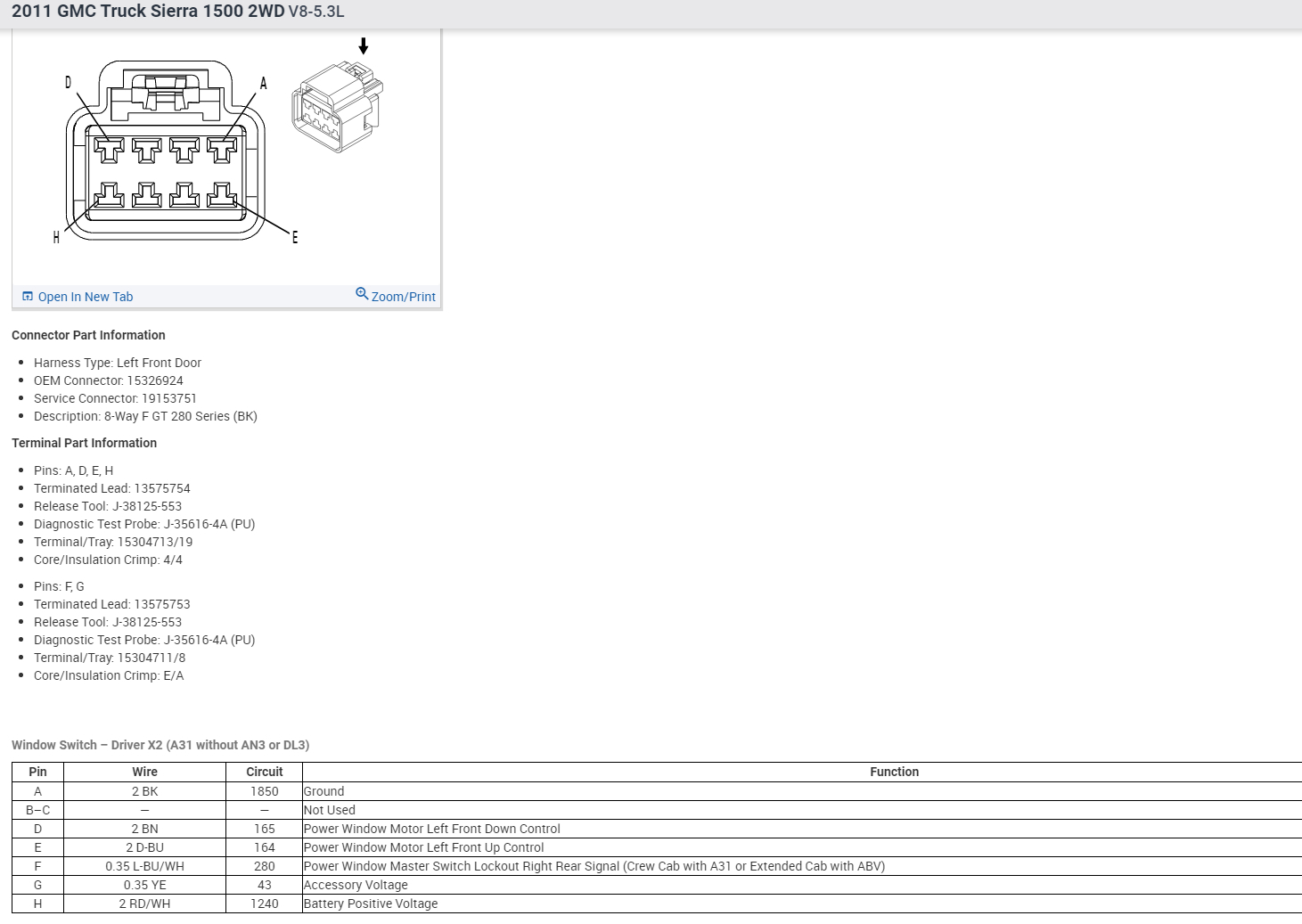

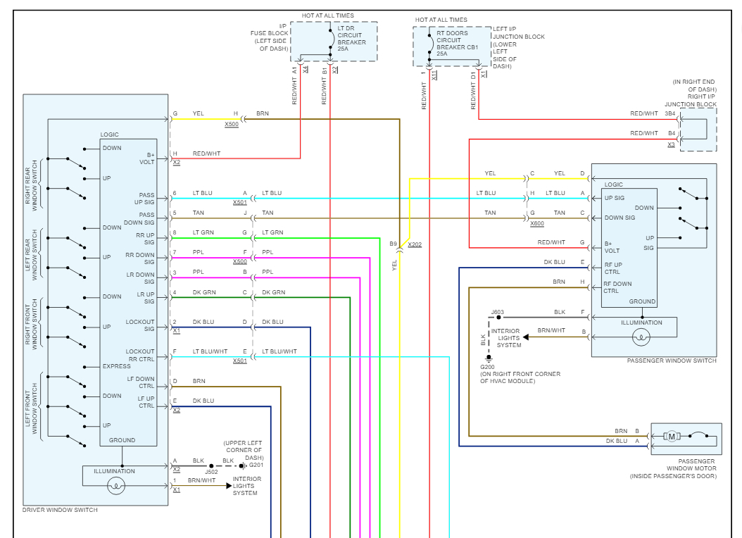

The red wire connected to the front right window switch connector broke. I disconnected it from the wire harness to fix it and disconnected the other wires and don’t know the correct way to reconnect all the wires back into the power window switch.
Feb 28, 2022 at 11:20 AM
SQM
  • 6,383 POSTS

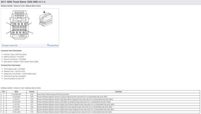

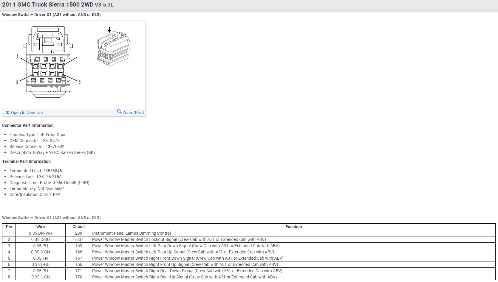

See attached for the power window switch pinout diagram. It shows each wire's location and color.
Let me know if you have any questions.

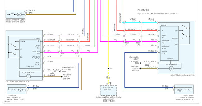

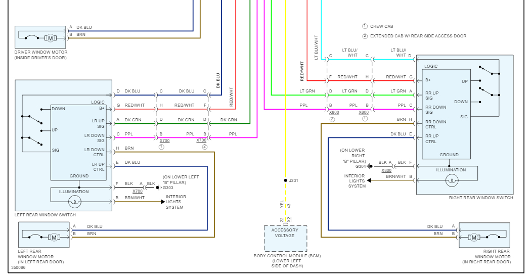

See attached for the wiring diagram for the power windows. This should help determining any wiring issue.
Here is a helpful guide on how to check wiring:
Let us know of any questions.
