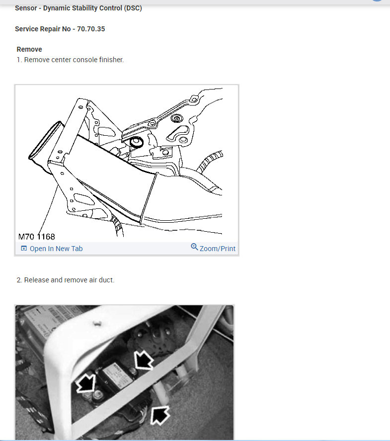

Front right and front rear air suspension not working
2004 LAND ROVER RANGE ROVER
262,572 MILES • 4.2L • V8 • 4WD • AUTOMATIC
ELIJAHADEGAHI
  • 22 POSTS

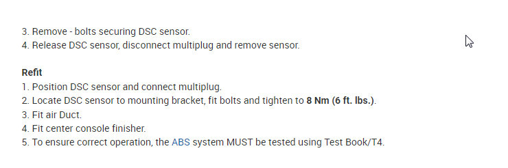

Please can you tell me or show me the diagram on how to fix my front right and front rear air suspension? when I diagnosed the air suspension system is showing me CAN Bus fault and reservoir valve fault. ABS is showing me CAN Bus transfer box time out and yaw rate sensor open circuit . so please I need the image and diagram of the yaw rate sensor also.
Nov 24, 2020 at 9:50 PM
I attached the info on this sensor. Let us know if you need more assistance in repairing this and we will be happy to assist. Make sure you are disconnecting the battery if you are going to disconnect this. You could set off the air bags if the battery is still connected.
