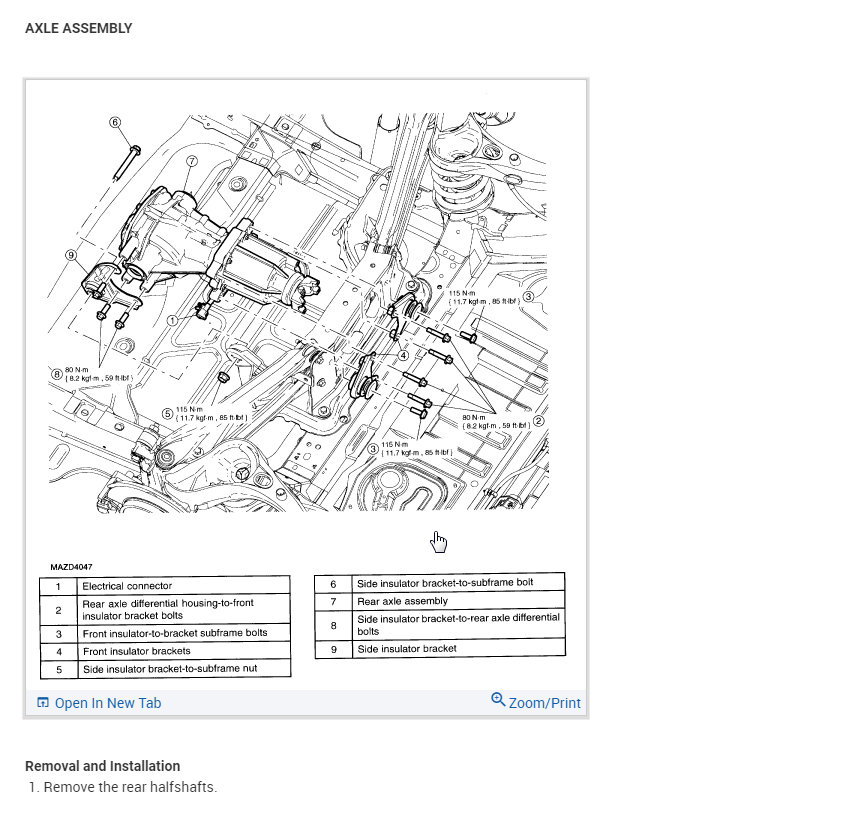

Front rear torque coupling is shot. Can it be replaced?
Jul 28, 2019 at 8:14 PM
Hi Robert,

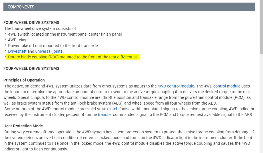

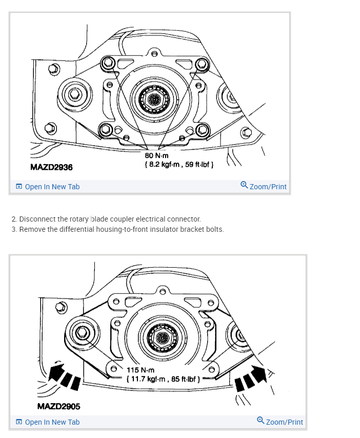

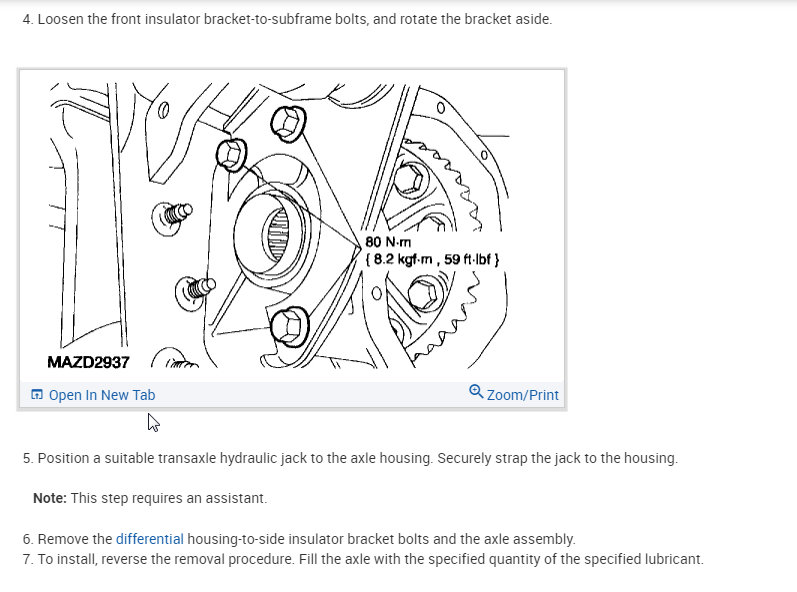

The item you are referring to is called the Rotary Blade Coupling (RBC) and it is part of the the differential. Here is the replacement procedure.
Please let me know if you have questions. Thanks
