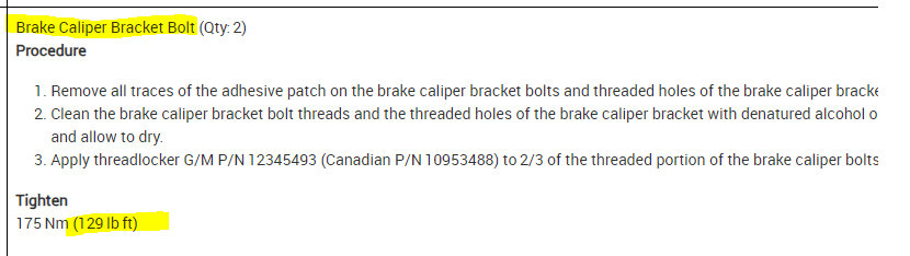

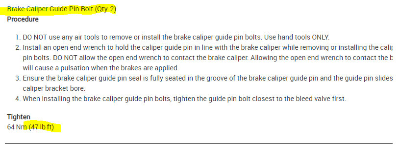

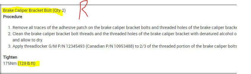

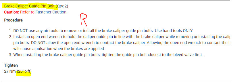

I'm looking to change the rotors on my vehicle listed above and I was hoping to get the front and rear brake torque specs.
Thanks!
May 22, 2024 at 12:12 AM
  • 110,241 POSTS
The brakes, in and of themselves, don't have torque specs. The caliper bolts, caliper mount, and brake hose will have torque specifications.
Below, I attached the specifications. The last two pictures (have an R in red) are the rear brakes. The other pictures are for the front brakes.
See pics below
