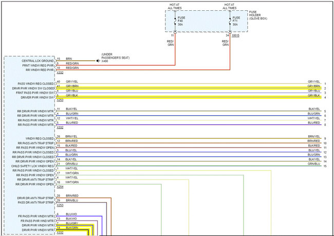

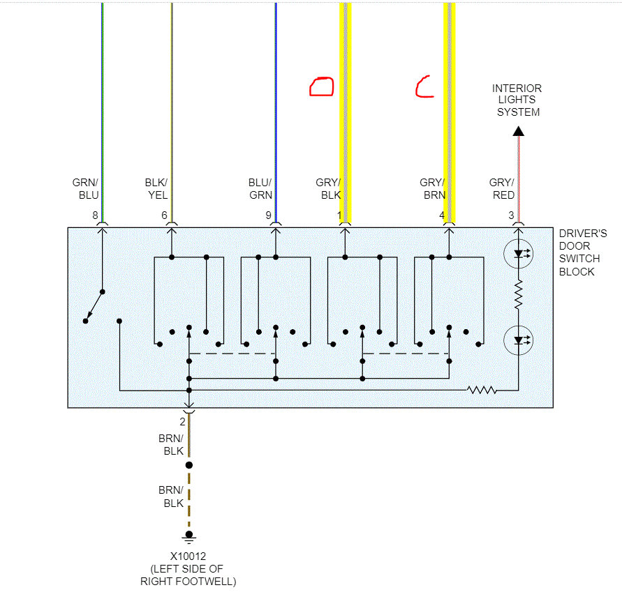

Here is how this works: Power from fuses 48 and 71 in the glove box fuse box powers the general module control unit behind the glove box. When power is on at the fuse (key on), power goes to the general module and is sent to the driver's door switch via a gray wire with a brown tracer and a gray with a black tracer. When you select up or down (open/close) a ground path is provided via one of the two wires which then prompts the module to turn the window motor on in the direction requested by switching the polarity to the motor.
I need you to locate those wires at the switch and check them for power. This should be done with the key on.
If there is no power, then we need to test two other things. First, confirm the brown wire with a black tracer has continuity to ground. If it doesn't that is the problem. If it does, then we need to go to the module.
Do this and let me know what you find. Also, let me know if the other windows are working.

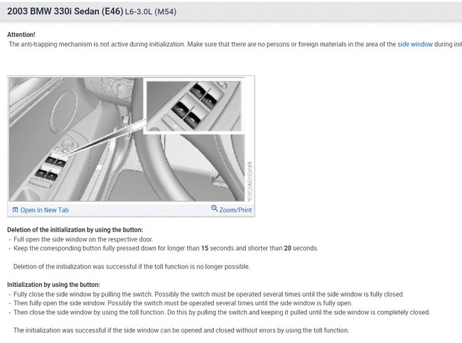

Do me a favor. I went through the manual and found the initialization procedure after repairs were done. It's worth a try at this point.
See pic below.

I tried the initialization procedure with no success, but it was still worth a try.

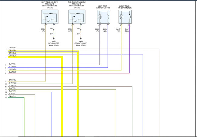

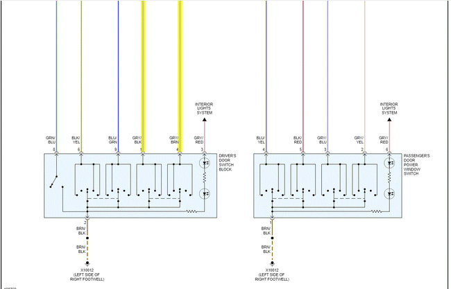

I attached the entire wiring schematic below and highlighted the related wires. Please note that the schematic was two pages. I had to cut each page in half to make them readable for you. I did overlap them.
The wires go from the switch to the GM module and then from there, power is sent to the motor.
Take a look through the schematics and let me know if you have questions.

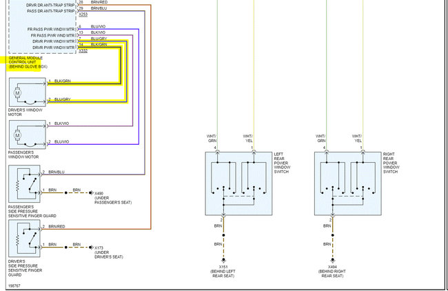

Hi Joe,
While toggling switch checked for power at the window motor, power on the black/green, no power on the blue/grey.
Checked at Gm module block x332 power out of black/green, no power out of blue/grey.
I can hear a relay sound when powering up the driver's window but not when pressing for down.
When I use all the other windows, I can hear the relay sound up or down.
Do you know if the relays are on board the Gm module or somewhere else?
Many thanks for the wiring diagram.
Geoff
May 2, 2022 at 10:48 PM
  • 110,248 POSTS

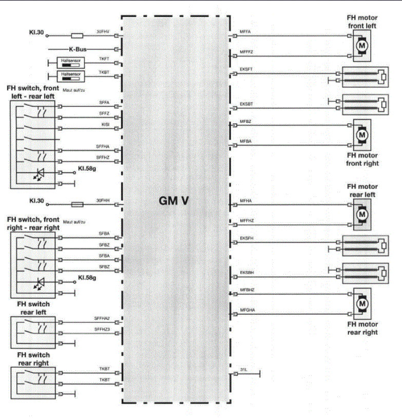

I did some digging and found the OEM schematic for the windows. It doesn't show remote relays. With that, I assume it is integral with the GM V.
Take a look at the attached pic and let me know if you see anything different or have questions.
You indicate hearing the relay with the other windows. Can you tell where the clicking is coming from?
See pic below.
May 3, 2022 at 10:20 AM

Hi Joe,
Should I maybe remove the terminal blocks from the GM5 Module and check for continuity between the driver's door switch 41/5 wires to the block. And the 7/14 wires to the driver's window motor? The schematics you sent over have been very helpful.
I felt the module but couldn't feel the relay firing but the sound appears to come from it.
The switch wires 41/5 that are showing 5v are very small gauge, do they perhaps trigger the relay which sends 12v on the larger gauge 7/14 wires going to the window motor?
Geoff
May 3, 2022 at 11:35 PM
  • 110,248 POSTS
That would be a good idea to check. As far as the GM V, I suspect the 5v is what is triggering an integral relay. If you confirm that all wiring is good, I have a feeling the GM V has failed.

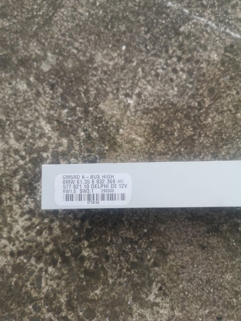

Unfortunately, a new GM5 and coding would be more than the cars worth, do you know if a secondhand unit would work?
I have seen secondhand modules on eBay, do I need a module identical to the one on the car? I attached a picture of my module.
Geoff
May 5, 2022 at 5:49 AM
  • 110,248 POSTS
You need to get the same one. Have you checked online for places that rebuild them? I've gotten remanufactured PCMs and other modules that were plug-and-play. So far, they have worked perfectly.
