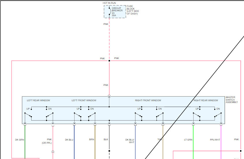

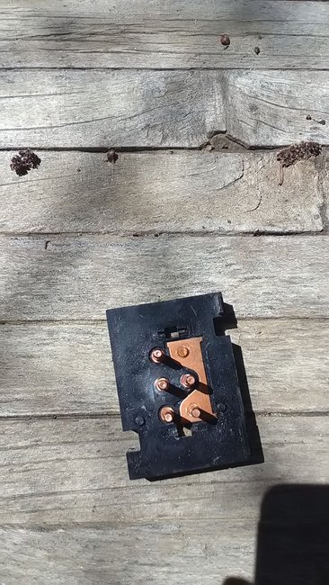

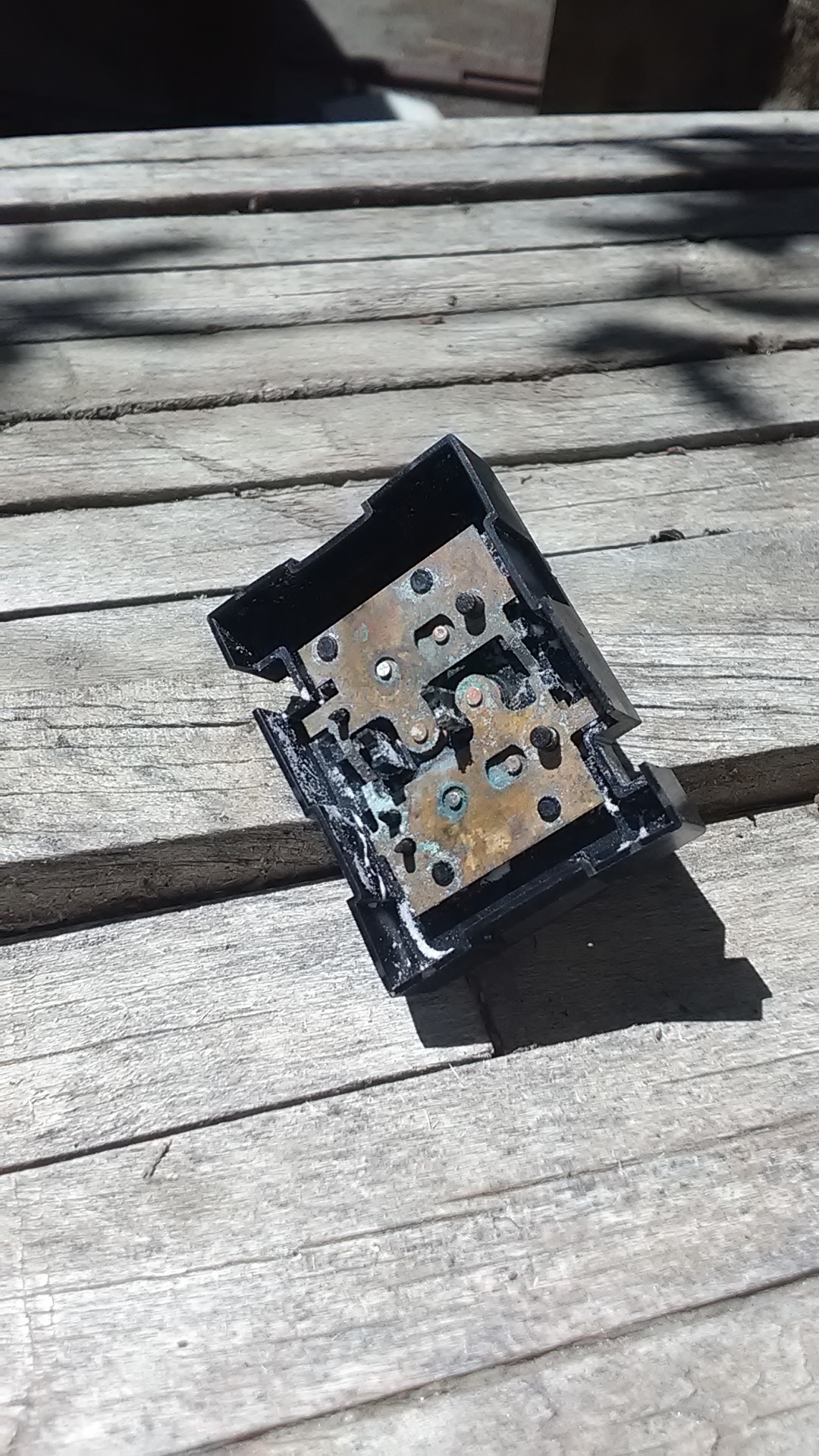

Anyone have the color coded diagram and function? Trying to get that window to roll up. Switch is toast.

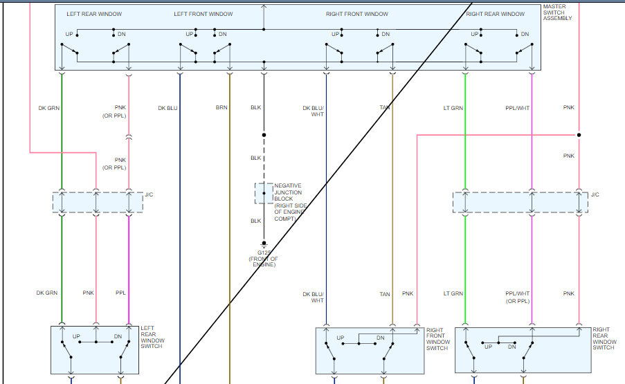

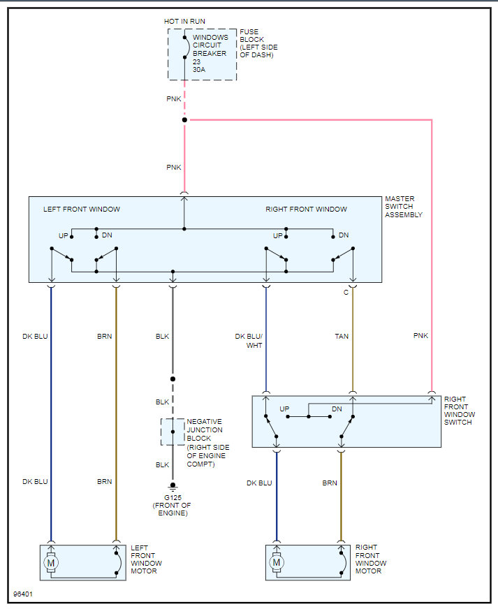

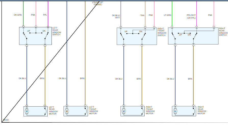

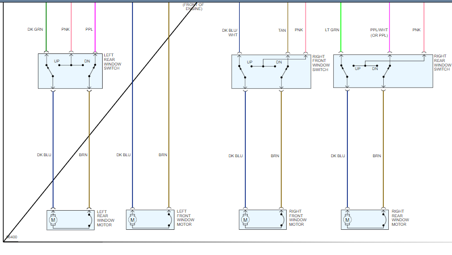

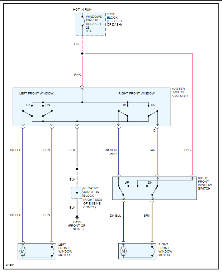

Just to help I've included the 4 door version power window diagram. I've attached the pictures below.However, I've cut the picture in 3 pieces so you can view larger.Hope this and thanks again for using 2CarPros.

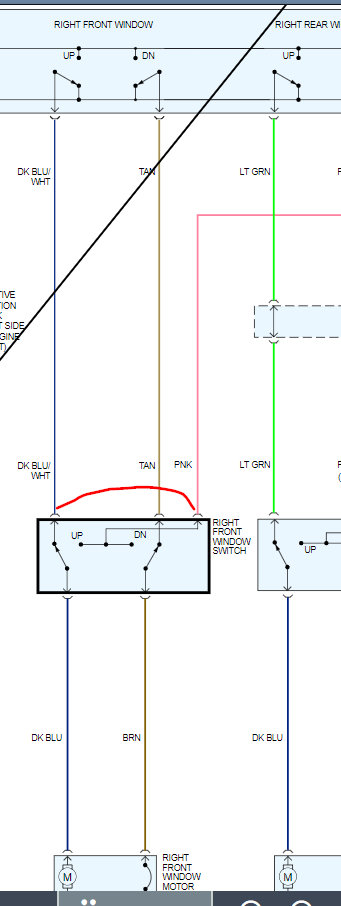

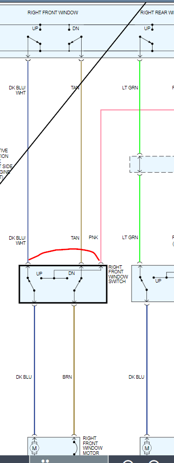

Okay, thanks. to be honest I have no training in reading schematics, wish I would of kept my basic electronics books. So I assume the pink is power, black is ground. My question is, does the master switch play a part in the passenger switch working? I would be manually jumping the blue/white and pink wire on the passenger door switch plug to make the motor go up and if when I do, would the master switch not working play a part in not allowing that wire jump on the passenger door to work?
It is a little hard to explain, please let me know if I can explain more.
Apr 12, 2020 at 6:46 PM
You are correct that the pink is power. You need to jump pink to blue/white to make it go up. The master switch does play a part in this because the control is feed through the master switch. However, it will not affect you jumping the switch as long as you have power on the pink wire. By doing this you are bypassing both switches.
Hopefully that answers your questions. Let us know if you need more info. Thanks

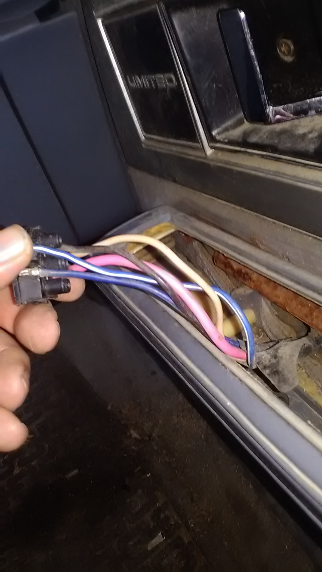

Got sparks. Motor is toast. I will check fuse tomorrow. And see my options.
