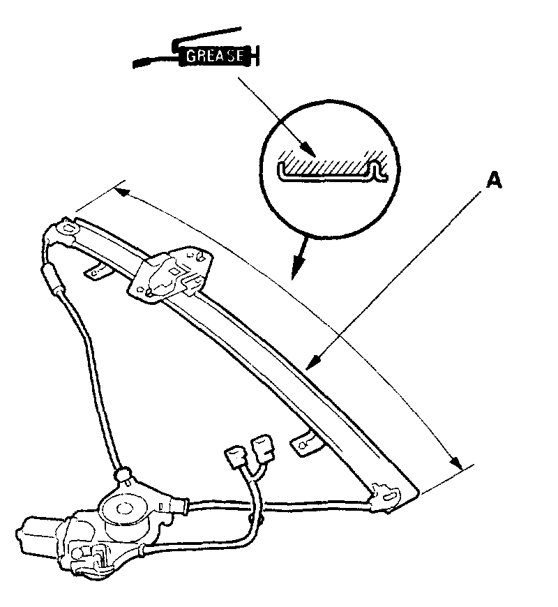

window is in down position. when I try to raise the window, it does not appear, however I hear the motor.

It sounds like the window regulator has failed. On this vehicle, the regulator contains a cable and I suspect it has broken or something has come disconnected.
What you need to do is remove the door panel and inspect the regulator to make sure nothing has become disconnected.
Here are the directions for replacing the regulator. The attached pics correlate with the directions.

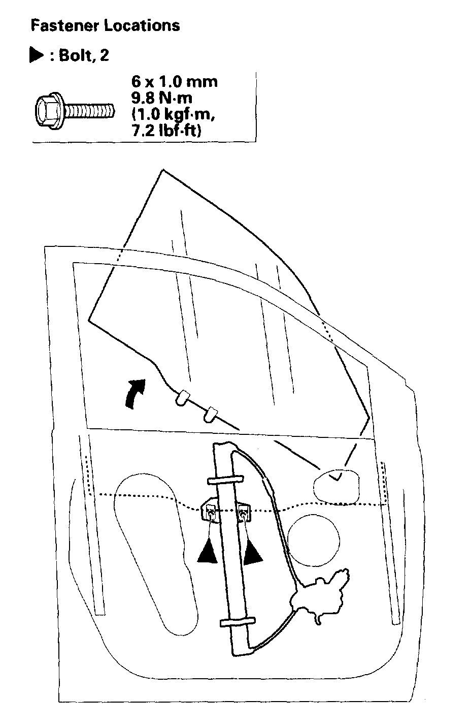

2. Carefully raise the glass until you can see the bolts, then remove them. Carefully pull the glass out through the window slot. Take care not to drop the glass inside the door.
pic 2

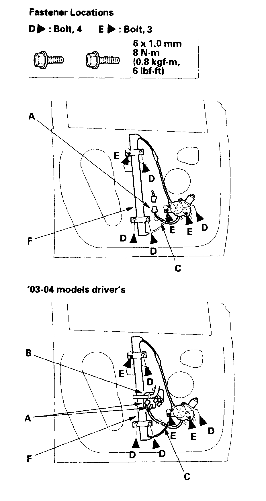

3. Disconnect and detach the connectors (A), and for '03-04 models driver's door, detach the connectors from the door harness bracket (B). Detach the harness clip (C) from the door. Remove the bolts (D) and loosen the bolts (E), then remove the regulator (F) through the hole in the door.
pic 3
4. Apply multipurpose grease to all the sliding surfaces of the regulator (A) where shown.
5. Install the glass and regulator in the reverse order of removal, and note these items:

Since you hear the motor running but the window isn't moving, this is my first suspect. Let me know if this helps or if you have other questions.
