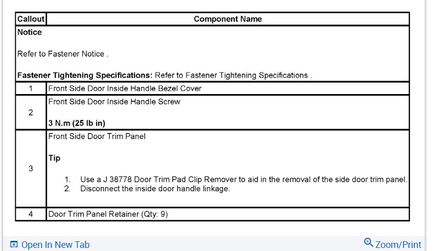

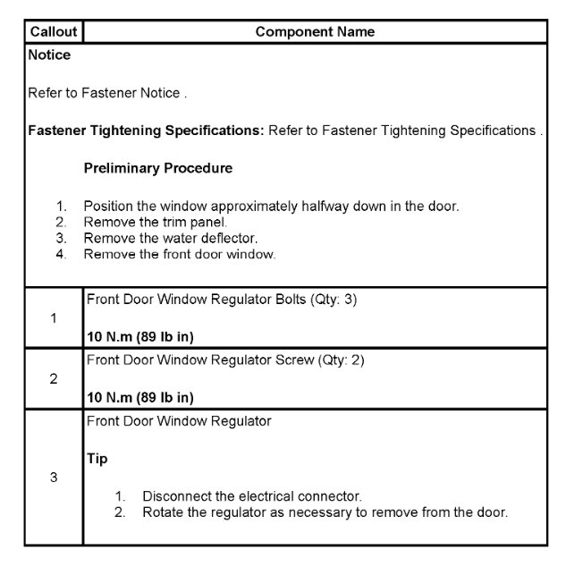

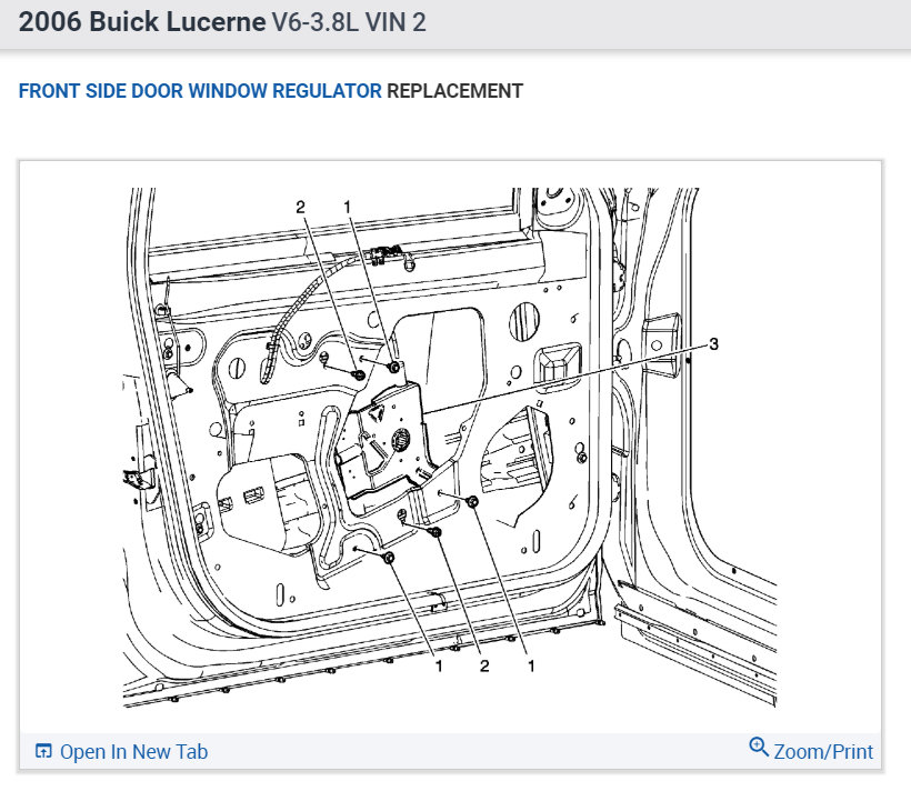

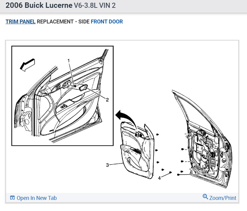

How do I replaced the front passenger window? The old one is still in, but is cracked really bad.
Oct 15, 2018 at 9:20 AM
  • 55,423 POSTS
You will need to remove the door panel and window regulator to get the glass out. Once the regulator is out tilt the window down in the front and up in the rear and the glass will come out. Here is a guide on how to take the door panel off step by step with a video showing the regulator being removed (different car but the process is the same) with diagrams below to show you how on your car:
https://www.2carpros.com/articles/door-panel-removal
and
https://youtu.be/Wp7Ak9IGs4o
