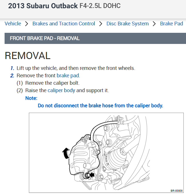

As I was coming home yesterday, I noticed a squealing/grinding sound coming from the front passenger side wheel. It is a consistent noise. As soon as you apply the brakes, the noise stops. Any idea of what the issue could be?

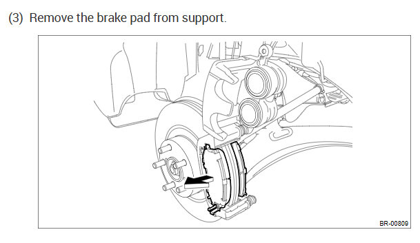

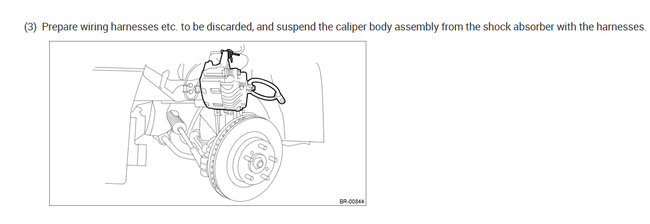

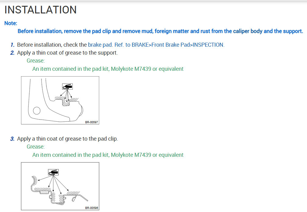

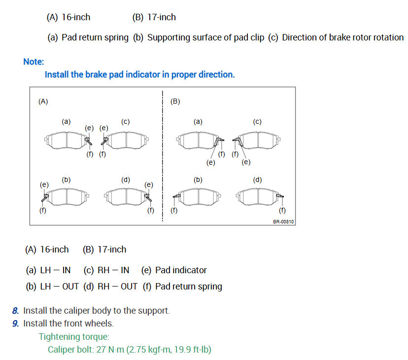

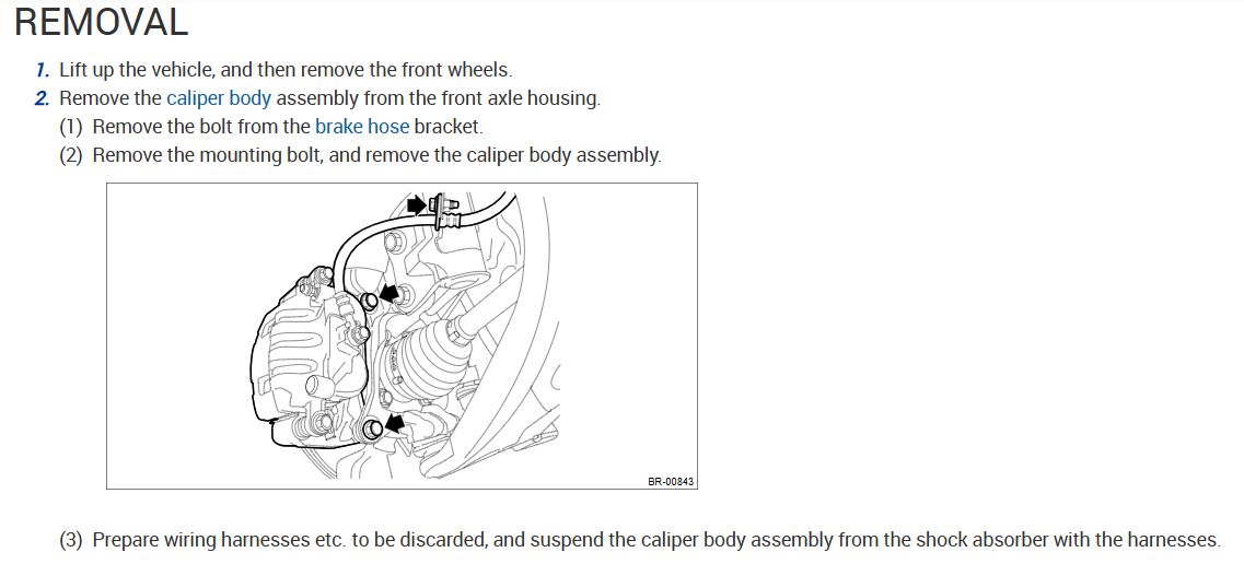

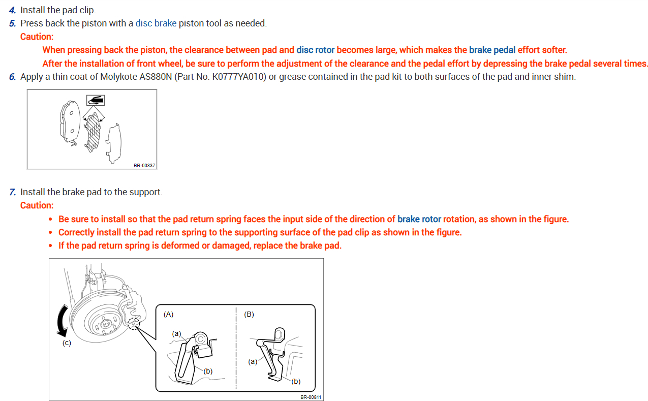

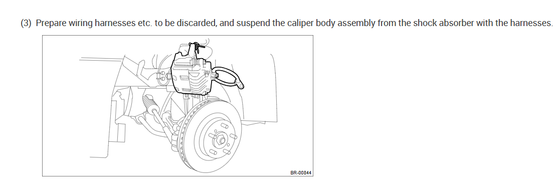

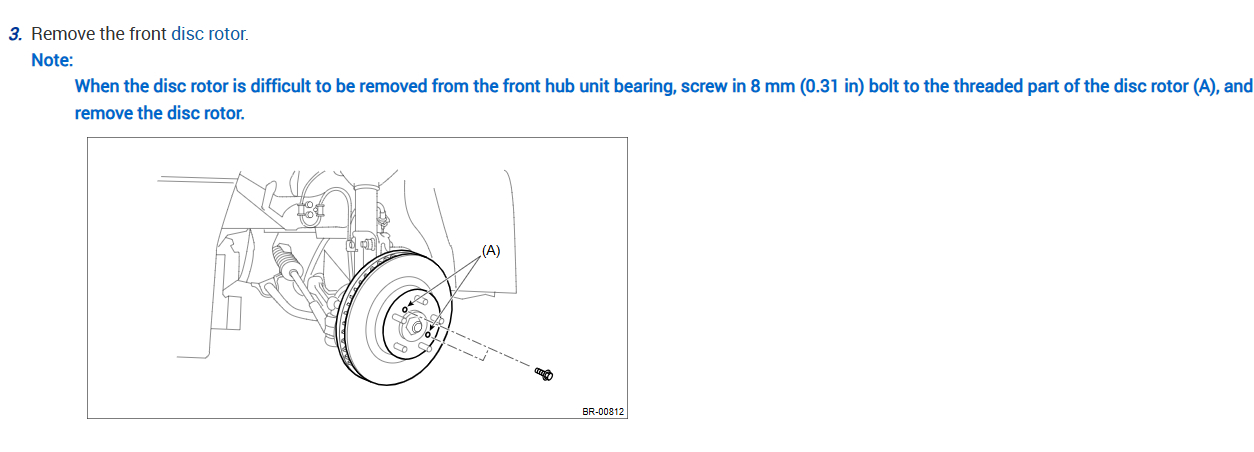

This sounds like the brake pads need to be replaced, here is how if you want to do the job yourself. Here is a video of the job being done on a similar Subaru; the procedure is the same.
https://www.youtube.com/watch?v=osNe-F0JLaU
You will need to do brake rotors as well. Let me know if the pads are okay because a bad bearing hub can cause this noise as well. Check out the images (below). Let us know if you need anything else.
