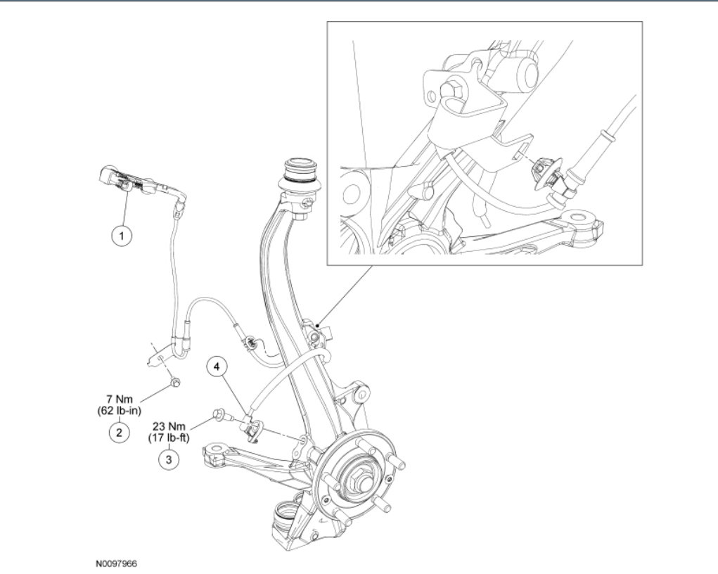

My car front passenger side wheel sensor needs to be replaced can you help?
Aug 20, 2020 at 2:13 PM
Good morning,
I attached the procedure below for you for the repair.
https://www.2carpros.com/articles/how-to-replace-an-abs-wheel-speed-sensor
Removal and Installation
With the vehicle in NEUTRAL, position it on a hoist. For additional information, refer to Section 100-02 .
Remove the fender splash shield. For additional information, refer to Section 501-02 .
Disconnect the wheel speed sensor electrical connector.
Remove the wheel speed sensor harness bracket-to-body bolt.
To install, tighten to 7 Nm (62 lb-in).
Detach the wheel speed sensor harness from the wheel knuckle bracket.
Remove the wheel speed sensor bolt and the wheel speed sensor.
To install, tighten to 23 Nm (17 lb-ft).
To install, reverse the removal procedure.

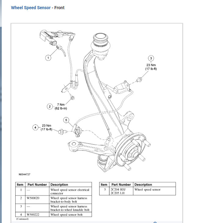

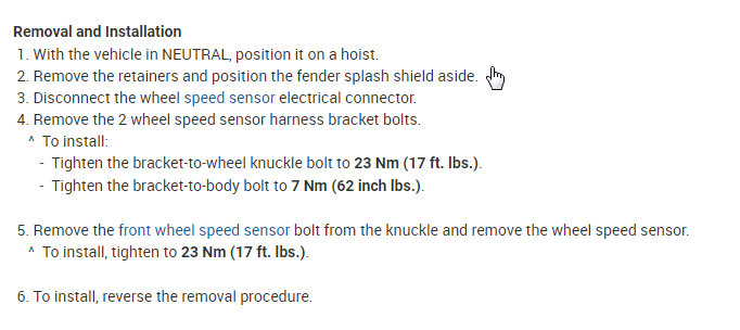

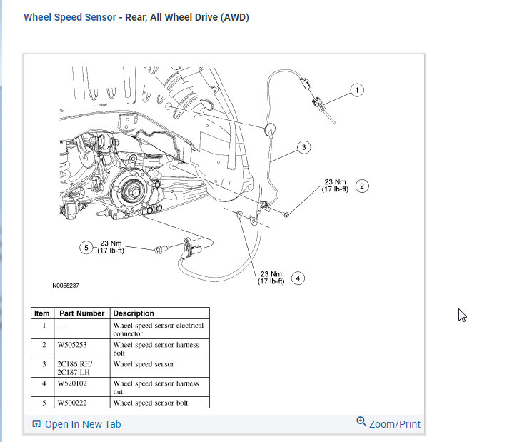

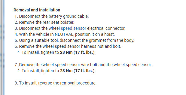

Ok, so recently I got a new left rear tire speed sensor, for my last one was broke, and my ABS and tracking would not kick in. Got it fixed at a local Ford Garage Saturday, everything seemed good. Today, driving home from work the light went back on, I want to do the job myself this time, I want to do all the wheel sensors
Mar 29, 2021 at 10:31 AM (Merged)
Here is a guide that will help with this:
https://www.2carpros.com/articles/abs-wheel-speed-sensor-test
Below you will find the process from the manual that will help with getting the front and rear sensors replaced.
Please let us know if you have other questions. Thanks
