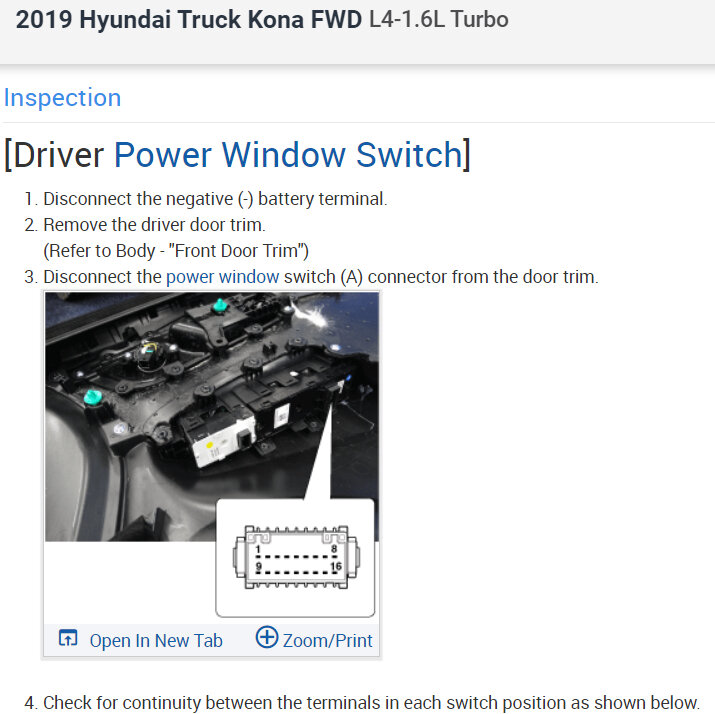

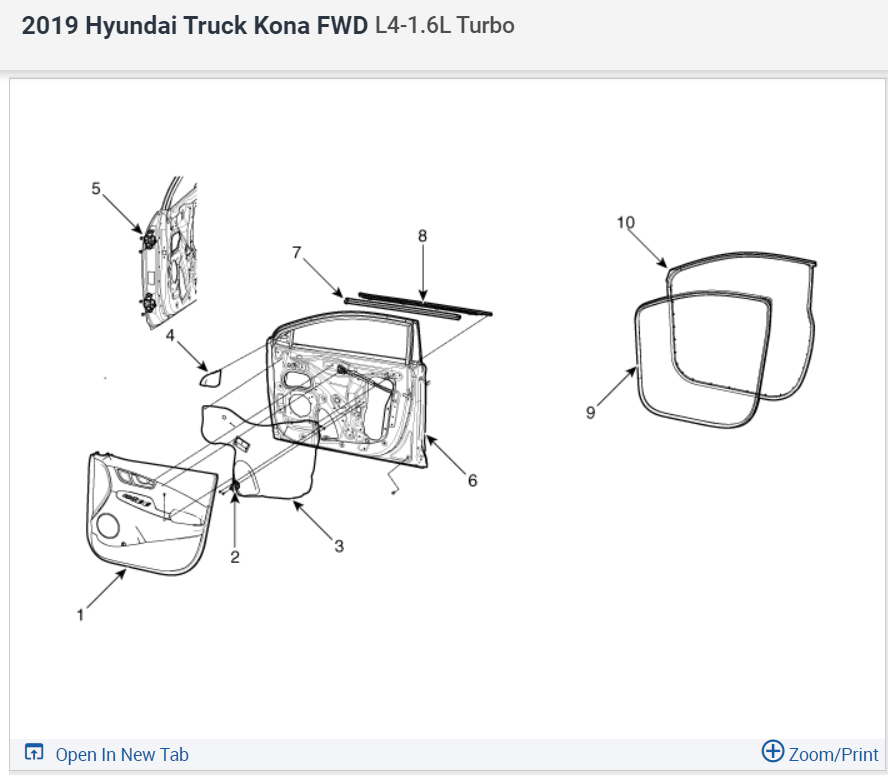

Front passenger power window will go down but not up?
Sep 28, 2024 at 3:24 AM
  • 55,402 POSTS

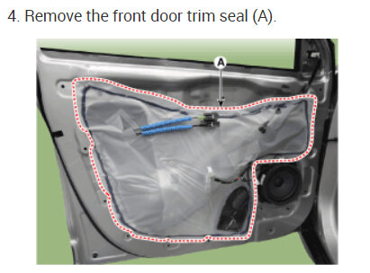

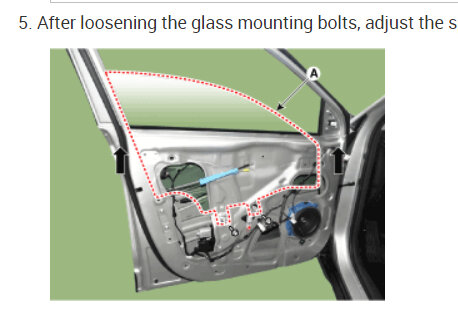

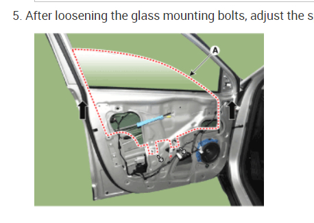

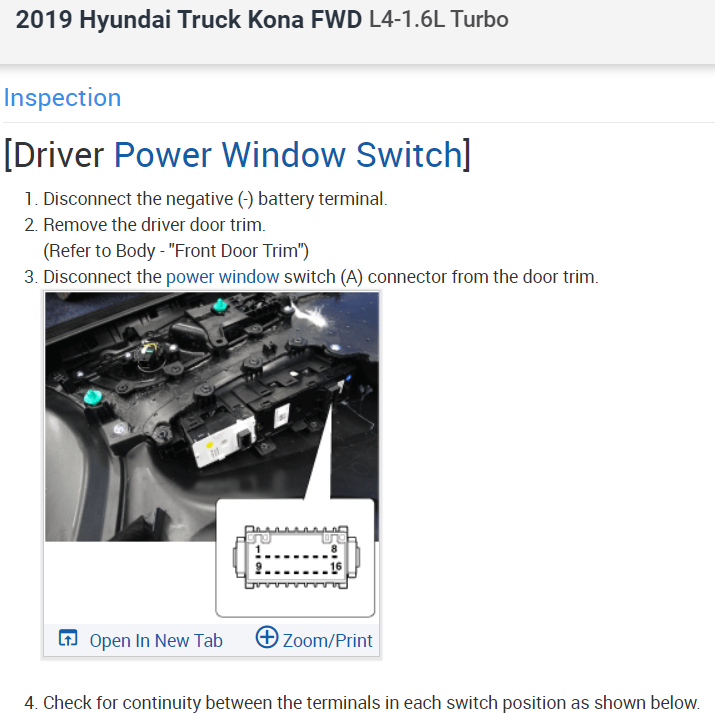

Can you hear the window making noise when you try to roll it up? If so, the window regulator is bad and needs replacement, if not the main window switch is probably bad which is common. Here is how to change out the regulator and a guide to help test the switch operation.
https://www.2carpros.com/articles/electric-window-repair
The instructions are not very clear so please go over this video of the job being done on a similar car; the procedure is the same.
https://youtu.be/Wp7Ak9IGs4o?si=kD-w1om93llMRZf5
Check out the images (below). Please upload pictures or videos in your response of any problems so we can see what to help you with.
