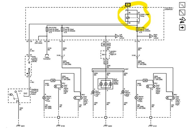

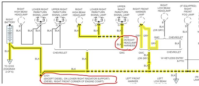

The truck listed above is 2500. Everything was fine. I drove home from work. No lights were on when parked. When I let the dogs out around 9:30pm the front passenger marker light was on and couldn’t get it to turn off. Drained the battery. I changed all bulbs and fuses are good. Any help would be really appreciated a lot!!
Feb 27, 2022 at 1:57 AM
WENDY W
  • 86 POSTS
Hello!

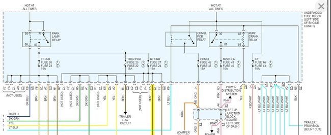

It sounds like the park lamp relay in the under-hood fuse block may be malfunctioning. Please check out the diagram (below). These repair guides may help you track down the fault:
https://youtu.be/Hlna_kUt7As
Please let us know what you find or if you need any further assistance, and we would be happy to help.
Thanks, Wendy W

Hi Wendy, yes, I did replace that and all fuses and it’s still on there is constant power going to that one side. I took the assembly off yesterday and there is power going to that passenger side front only. Any other ideas?

I'm curious, if you pull the right parking light fuse, are you still getting power at the passenger side front marker lamp?

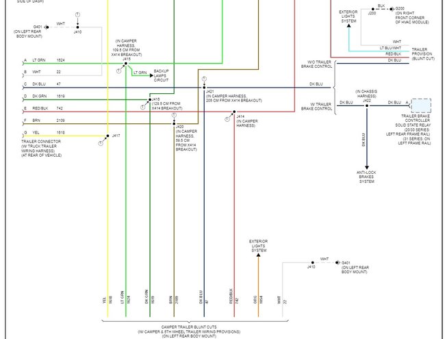

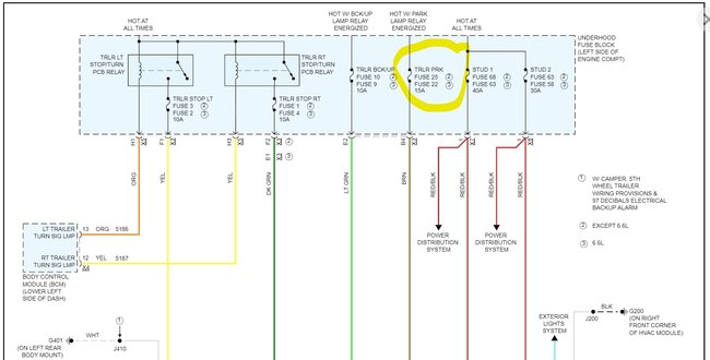

When you wiggle the harness, nothing happens, they look good I took out both light assembly’s yesterday and it looked good. Could it have something to do with the trailer wiring? Just a question. I haven’t tried pulling that fuse yet just to see what happens.
Feb 27, 2022 at 11:47 PM
WENDY W
  • 86 POSTS
Yes, it's possible there could be a short in the trailer wiring harness. I've attached those schematics for you (below).
Thanks! Wendy W.
Feb 28, 2022 at 12:01 AM
JFAFARD86
  • 7 POSTS
Try pulling those fuses and it still is on. Ugh

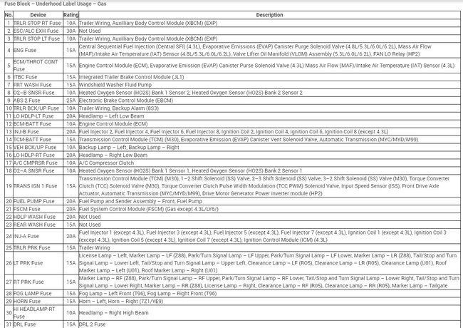

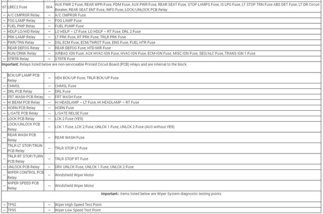

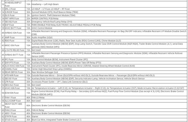

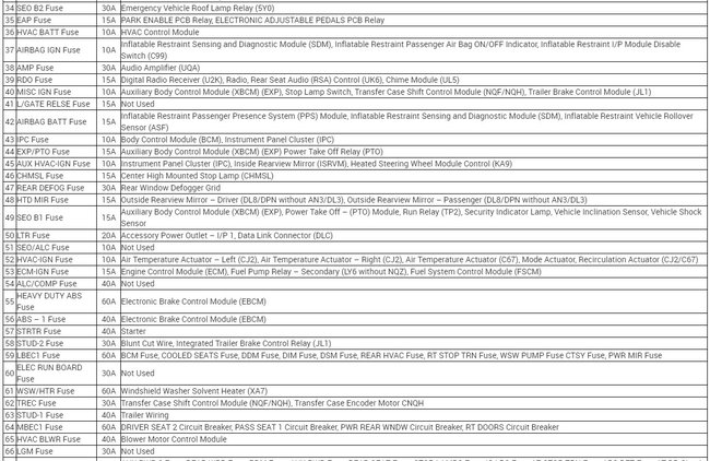

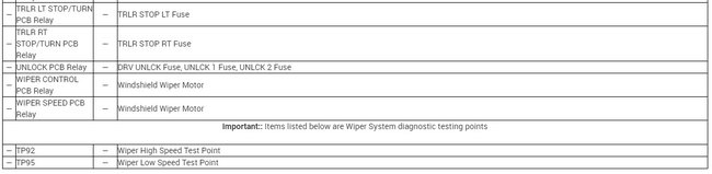

With the key on, are the rest of the exterior lights functioning properly?
Has the vehicle set any OBD II codes that you know of?

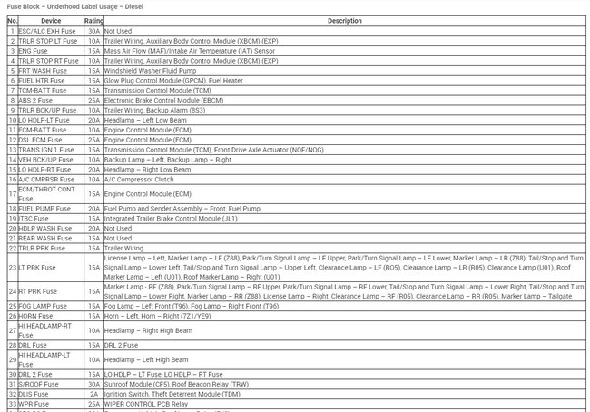

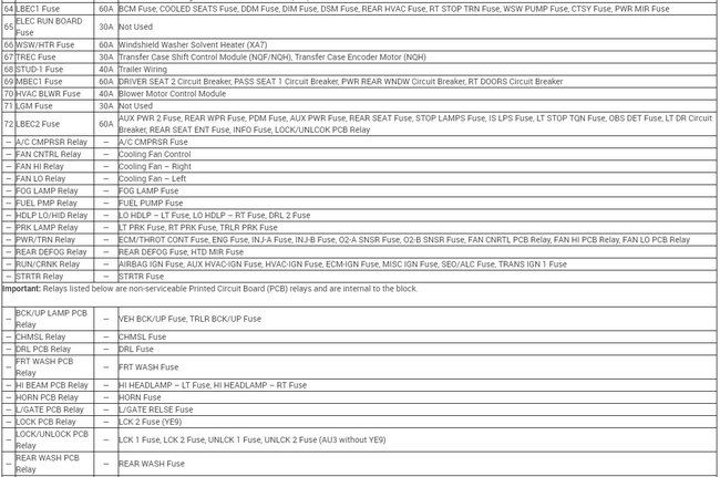

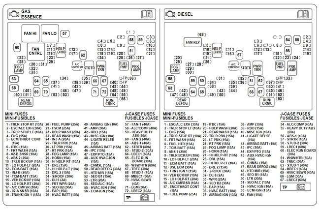

If the circuit is cross-feeding with another circuit, you may be able to remove fuses, one at a time, to see if the light goes out. That might help narrow down which circuits are involved. I've attached detailed descriptions of the under-hood fuse block so you can see which ones involve the exterior lights.

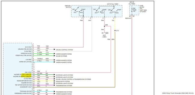

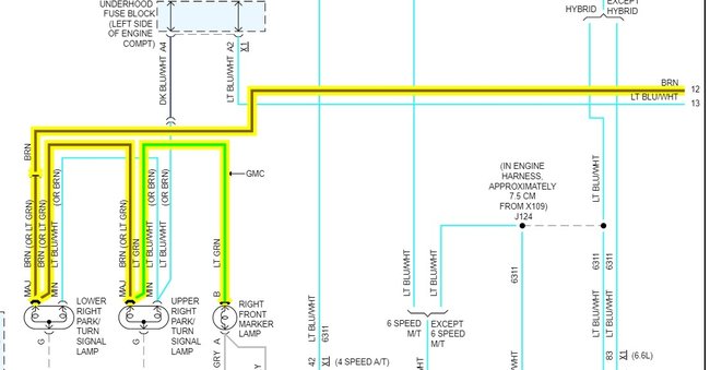

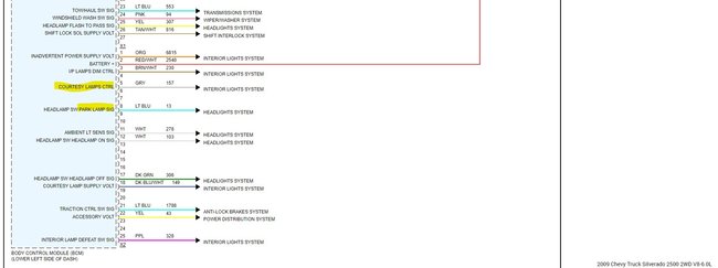

There are two grounds in the exterior lighting wiring harness that you might want to check. They're circled in red on the schematic below.

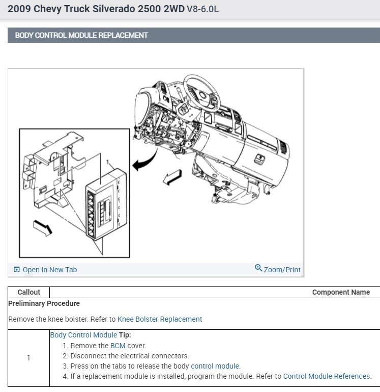

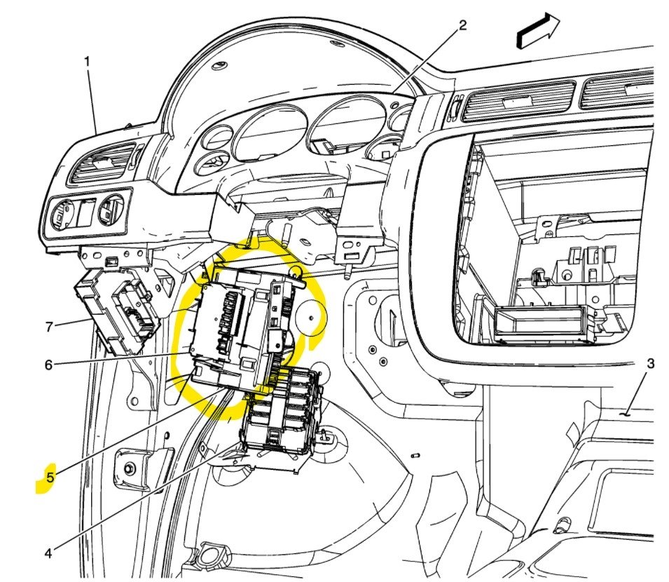

Another possibility is that there is a fault in the BCM (body control module). Please see the schematic below. Notice that the courtesy light, turn signal, and parking lamps all communicate with the BCM. Please note that the negative battery cable should be disconnected before unplugging the BCM to avoid possible damage to the unit.
Here's a repair guide on what to expect when replacing a BCM:
https://www.2carpros.com/articles/how-to-replace-a-bcm-body-control-module
