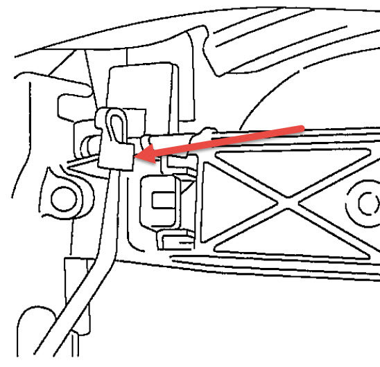

you can remove the panel when this happens albeit not very easily. you probably have a broken door rod clip or clips causing your problem. they are available at auto parts in the help section usually. there are left hand and right hand. see picture. unfortunately we do not have pictures of door panels. also it could be a broken cable for inner door handle.

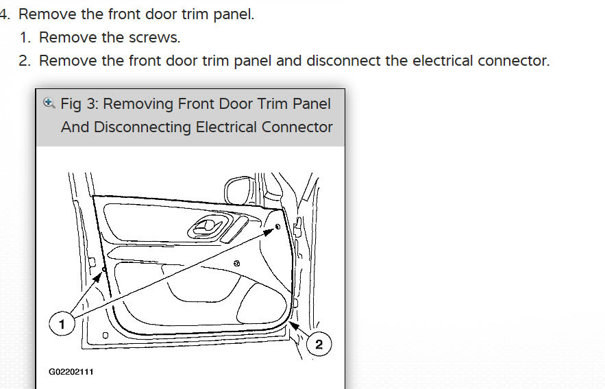

Does anyone have a step by step process on how to remove the door panel enough to replace this part with the door closed?
Nov 15, 2016 at 1:29 AM
HMAC300
  • 48,601 POSTS

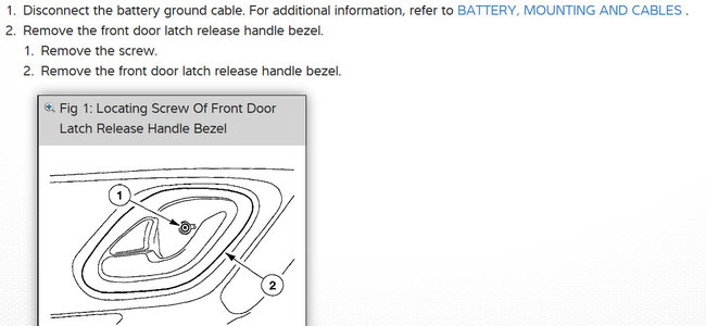

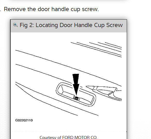

I found this from a 03escape so yours will be very similar, once panel is loose lift up normally to remove it. assembly is reverse of removal. see pics. try moving seat all the way back as well and it may require you moving it forward if something is hard to reach.
Nov 15, 2016 at 1:41 AM
NICHOLE2098
Will I need to disconnect the car battery before doing this?
Nov 15, 2016 at 4:08 AM
HMAC300
  • 48,601 POSTS
it says to on first picture. I guess you better take the negative terminal off.
