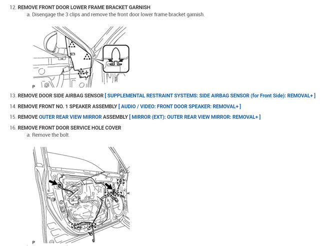

I have been having a particularly annoying clicking/rattling issue with my front passenger side door panel for the better part of a year now. The car was just at the local Toyota dealership for this issue and for the 5th time I have been told they could not “duplicate” the issue. Within 4 hours of getting the car back the same sounds continued very frequently and duplicate easily. I am wondering what could be the root cause of this noise. I have included videos of me manually duplicating the sound and the sound naturally occurring while driving through a parking lot at low speed.

  • 55,770 POSTS

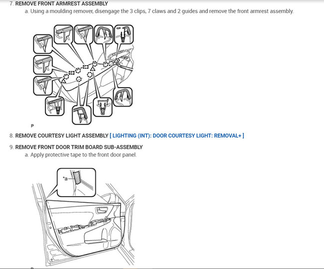

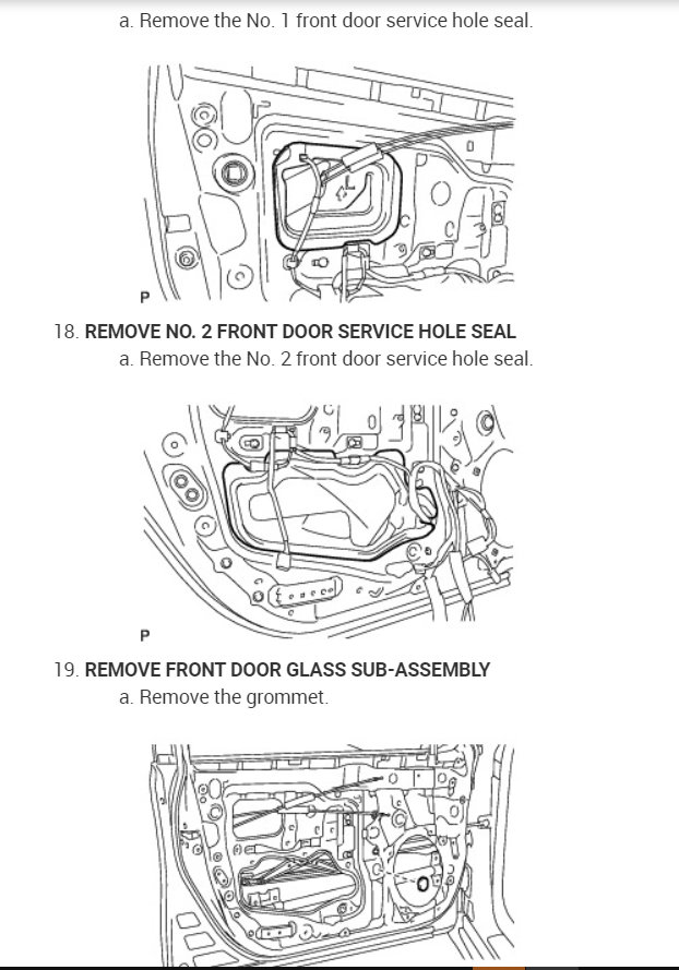

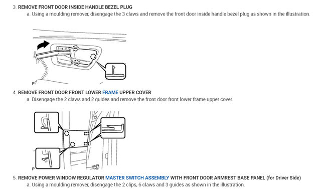

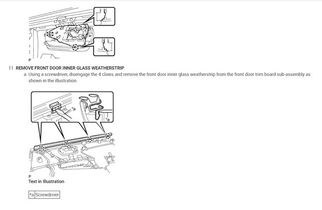

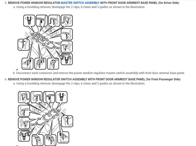

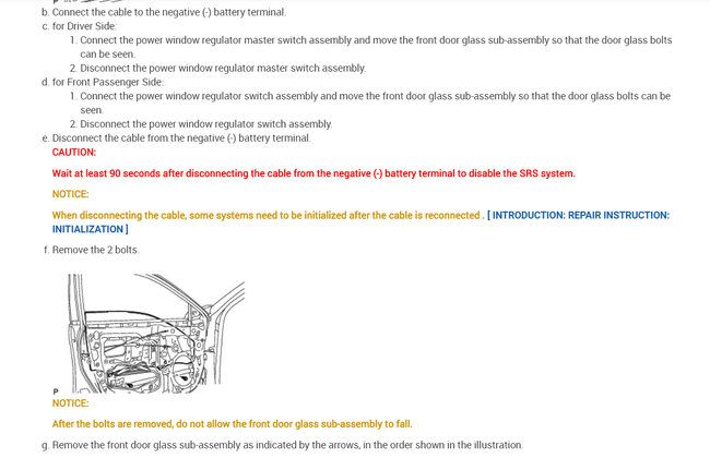

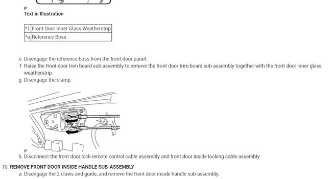

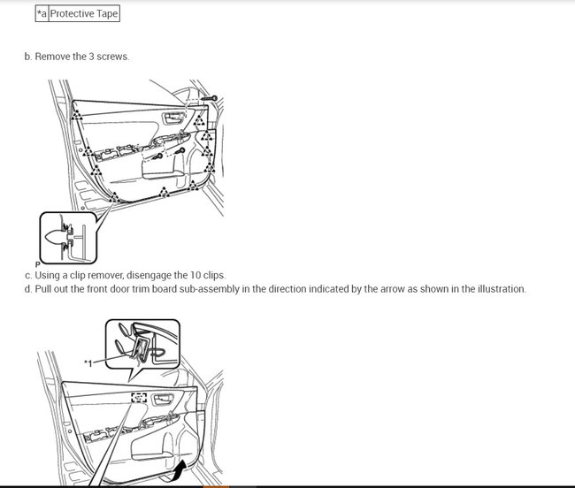

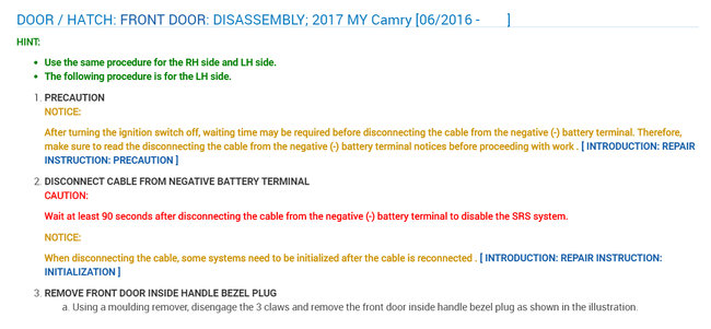

We need to remove the front door panel to confirm the source of the noise, it could be the door latch shorting out. Here is how you remove the panel in the diagrams below. Check out the diagrams (below). Please let us know if you need anything else to get the problem fixed.

  • 5,700 POSTS
If you do decide to take the door panel off yourself, make sure you disconnect the negative battery cable first, and wait at least 5 minutes, because you have to disconnect the door side airbag sensor. You don't want to accidentally set off an airbag. It's part of the supplement restraint system.
