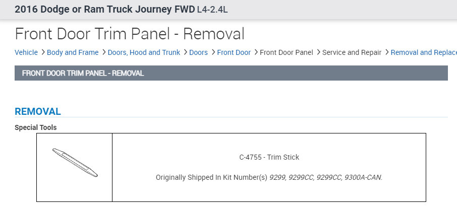

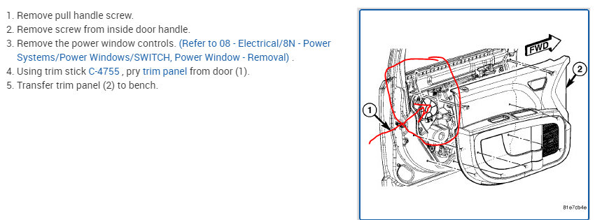

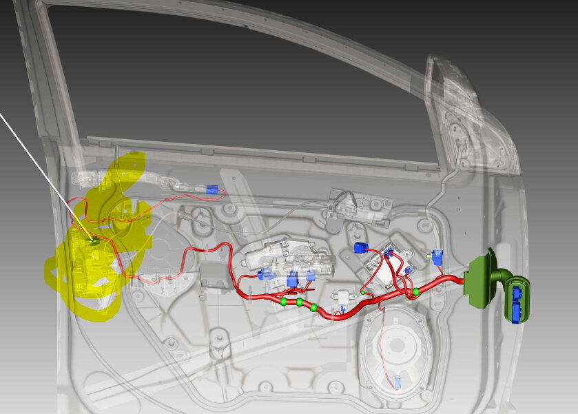

Let me know. Also, I feel we will need to remove the door panel to inspect the actuator motor and the steel linkages related to the lock. I attached a picture below and highlighted the area where everything is located. (see pic 1)
Pics 2 and 3 are the directions for removing the door trim panel.
Let me know what you find.

Thanks much for your answer! And answering yours, it does make a noise; see attached video. Thanks!
Sep 26, 2023 at 8:37 PM
  • 110,240 POSTS
Wow!!! That sounds like a machine gun. LOL
Okay, this could be the switch itself or a faulty actuator. I would disconnect the actuator and check from the switch with a test light for power. If the light flashes really fast, suspect the switch. If it seems to be working properly, then I would suspect the actuator.
Let me know what you find or if you have questions.
