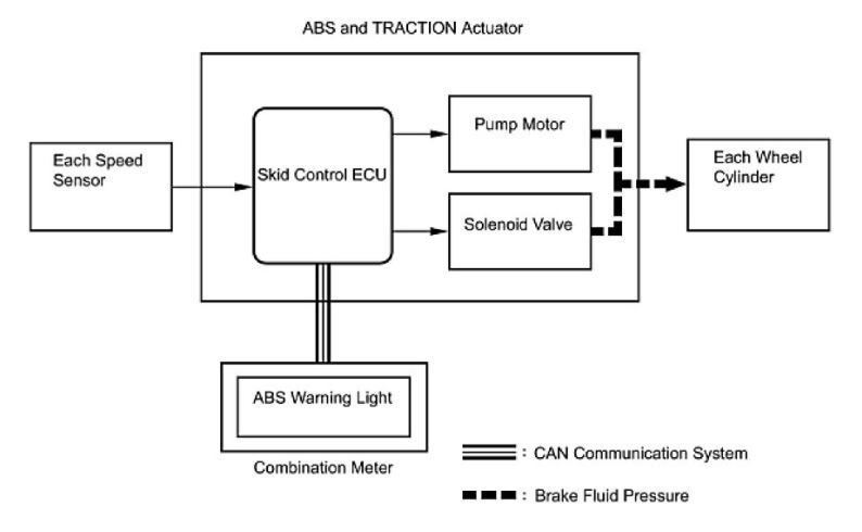

Sorry for the delay so Ive uploaded the basic system that involved I think you should have CAN system scanned and see if anything comes but since this all started with a fender bender it looks like the speed control sensors are easily damaged.You should do a good inspection as well near the dent, look for wires that could have been compromised but here is what to check out according to the data
BRAKE CONTROL: SKID CONTROL SENSOR (for 2WD): INSPECTION
INSPECTION
1. INSPECT SKID CONTROL SENSOR
(a)Check the speed sensor. If any of the following occurs, replace the speed sensor with a new one.
- The surface of the speed sensor is cracked, dented, or chipped.
- The speed sensor has been dropped.
2. INSPECT SKID CONTROL SENSOR WIRE
(a)Check the sensor wire. If any of the following occurs, replace the sensor wire with a new one. The connector or wire harness is scratched, cracked, or damaged.
I'm thinking the system is getting bad data and making the anti skid circuit engage from the little bump it got. Scanning the CAN will let us know maybe. Probably a wheel speed sensor. Interesting that the left side was hit but the right side is engaging. we need to make sure the modules are communicating with each other correctly. the fact that dropping a sensor can cause it to fail leads me to believe it's going to be one of them tell the computer that a tire is turning at a different rate.

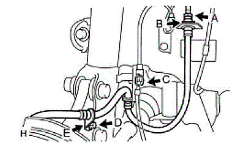

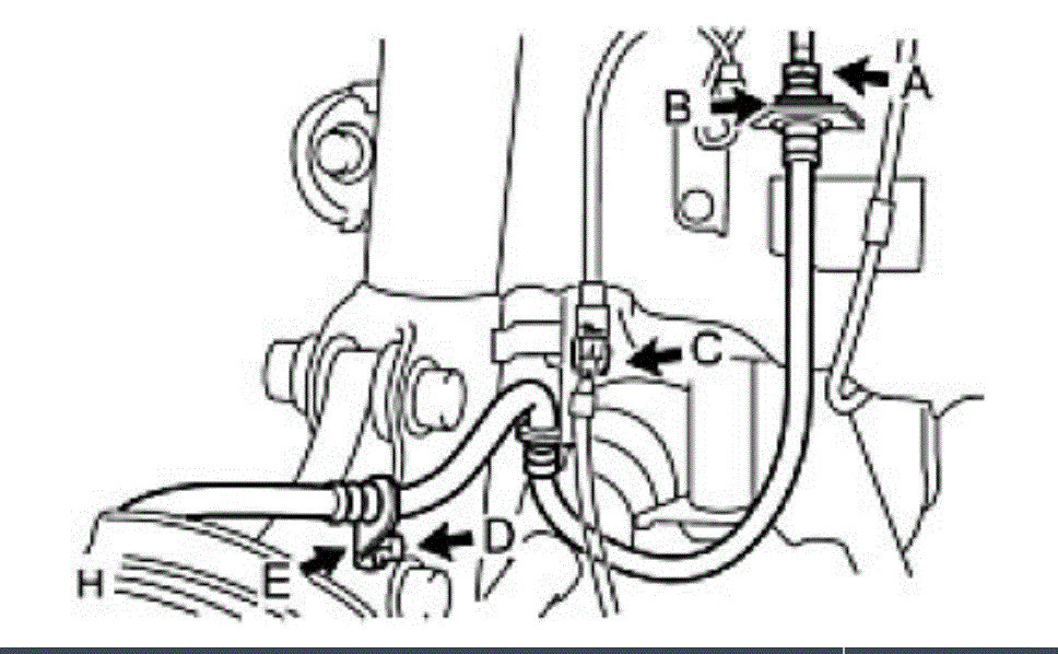

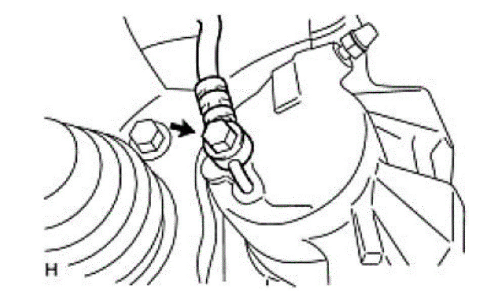

Did you have the codes checked for the ABS system? There is a fault code stored in the system for the light and that will help us narrow the area of failure.
https://www.2carpros.com/articles/abs-warning-light-on-easy-repair-guide
As far as the pulling, that most likely has nothing to do with the light. That is basic hydraulics. You changed the caliper but the more common reason for the pulling is the brake hose that collapses and does not release the caliper. After you stopped in the video and then moved forward, the caliper was still applied.
I would replace the brake hose and flush the brake fluid system with new fluid.
https://www.2carpros.com/articles/how-to-bleed-or-flush-a-car-brake-system

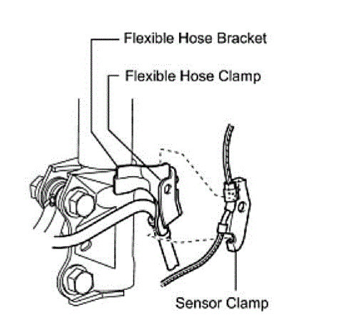

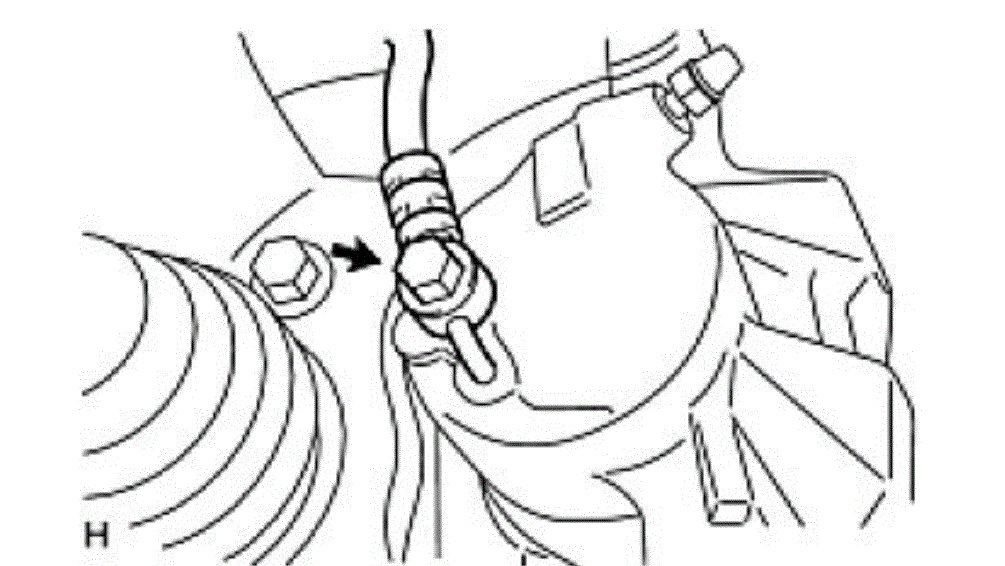

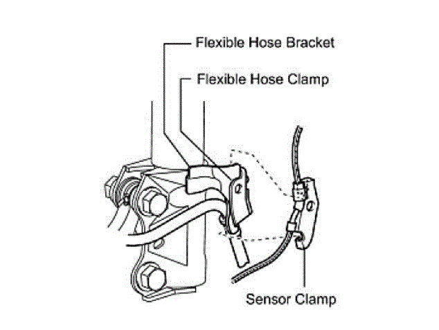

BRAKE: FRONT BRAKE FLEXIBLE HOSE: REMOVAL
REMOVAL
HINT:
Use the same procedures for the LH side and RH side.
The procedures listed below are for the LH side.
1. REMOVE FRONT WHEEL
2. DRAIN BRAKE FLUID
NOTE: Wash off brake fluid immediately if it comes in contact with any painted surface.
3. REMOVE FRONT FLEXIBLE HOSE
(a)Disconnect the brake tube (labeled A) from the flexible hose with SST while holding the flexible hose with a wrench.
SST: 09023-00101
Do not bend or damage the brake tube.
Do not allow any foreign matter such as dirt and dust to enter the brake tube from the connecting point.
(b)Remove the clip (labeled B).
(c)Remove the 2 bolts (labeled C, D) and then remove the flexible hose clamp (labeled E) from the knuckle.
(d)Remove the sensor clamp and flexible hose clamp from the flexible hose bracket.
(e)Remove the union bolt and gasket(s), and then remove the flexible hose from the disc brake cylinder.
