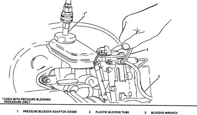

I have put 5 calipers on this car along with a brake hose and rotors and pads and now a master cylinder. it has a Kelsey Hayes ABS system that is attached to the master cylinder. after the master cylinder was replaced now I can't get a brake pedal at all. please help

Here are the directions for bleeding the system specific to your vehicle. Take a look through them and see if anything was missed.

Hydraulic Modulator/Master Cylinder Assembly
Attaching Bleeder Tube
Pic 1
1. Prime hydraulic modulator/master cylinder assembly.
2. Attach bleeder hose to rearward bleeder valve and submerge opposite hose end in clean container partially filled with brake fluid.
3. Slowly open rearward bleeder valve 1/2 to 3/4 turns.
4. Depress brake pedal and hold until fluid begins to flow.
5. Close valve and release brake pedal. Repeat procedure until no air bubbles are present.
6. Repeat procedure for forward bleeder valve until fluids begins to flow.
Note:Once fluid is seen to flow from both modulator bleeder valves, the hydraulic modulator/master cylinder assembly is sufficiently full of fluid. However, it may not be completely purged of air. At this point move to the wheel brakes and bleed them. This ensures that the lowest points in the system are completely free of air and then the hydraulic modulator/master cylinder assembly can be purged of any remaining air.
