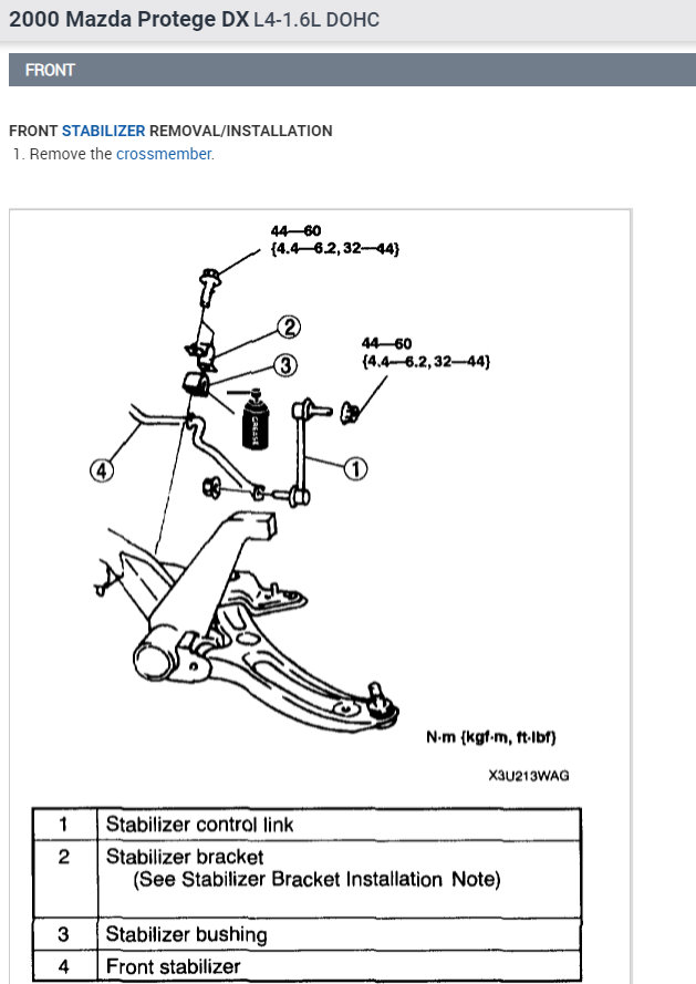

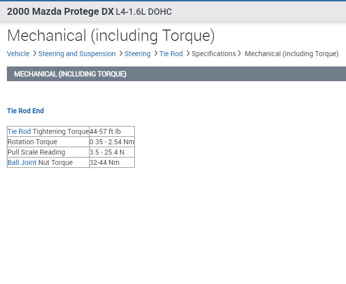

Are there torque specs for the Front Outer Tie Rods and Sway Bar End Links?
200,000 MILES • 1.6L • 4 CYL • 2WD • AUTOMATIC
NOFACE
  • 21 POSTS
I usually see recommendations of between 22-30 Ft-Lbs. for the outer tie rods but haven't seen anything specific for the Sway Bar End Link torque specs.

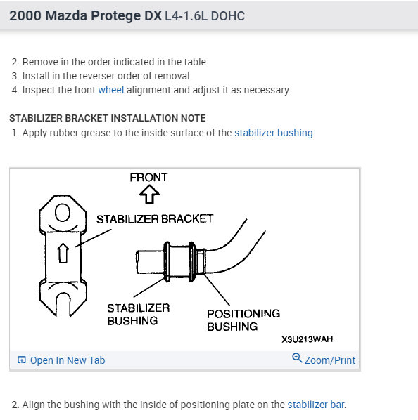

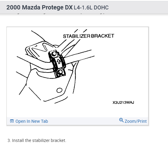

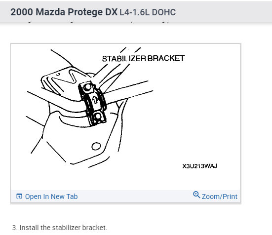

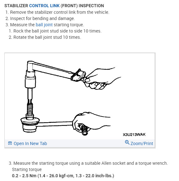

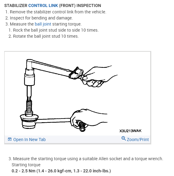

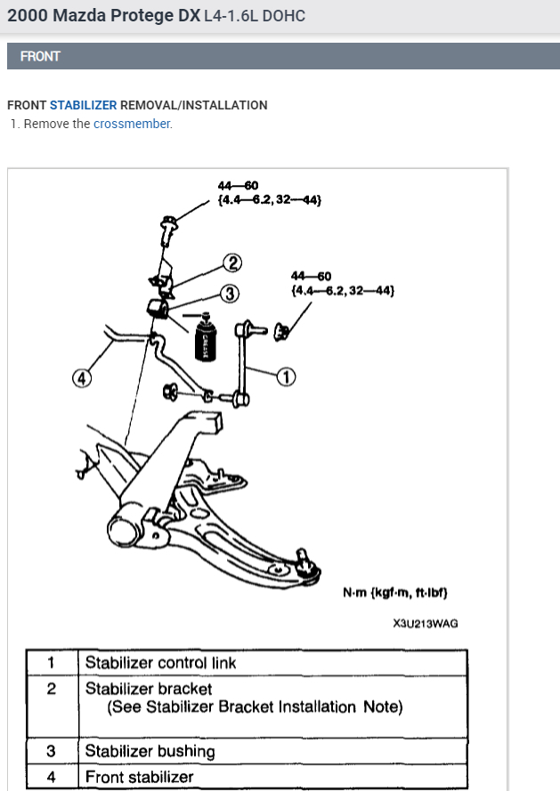

Please see attached for the torque specifications.
https://www.2carpros.com/articles/how-to-replace-a-sway-bar-link
Let me know of any questions.
