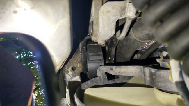

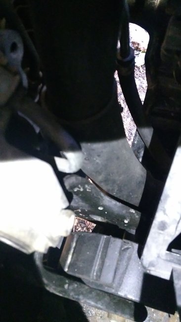

These are the best I could get.

is the replacement mount exactly the same size? is the transmission mount okay? The engine looks as if it has shifted side ways onto the mount bracket.

The mount is the same size and the transmission mount looks okay.

i would just start again, remove mount and make sure nothing looks out of place. i have access to the data base again. i will see if i can find anything relevant.

Okay, I do not have time right now to do it but will as soon as I can. do you think the bolt going through mount would get bent from the engine shift like it appears it did? I hope not.

i doubt it, it is a fairly substantial attach point. my problem is that it is very hard to visualize this concern, it just looks as if the mount is incorrect, fitted wrong or the engine has shifted due to other mount problems.
