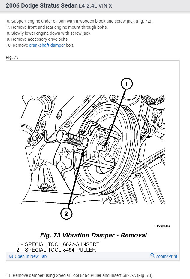

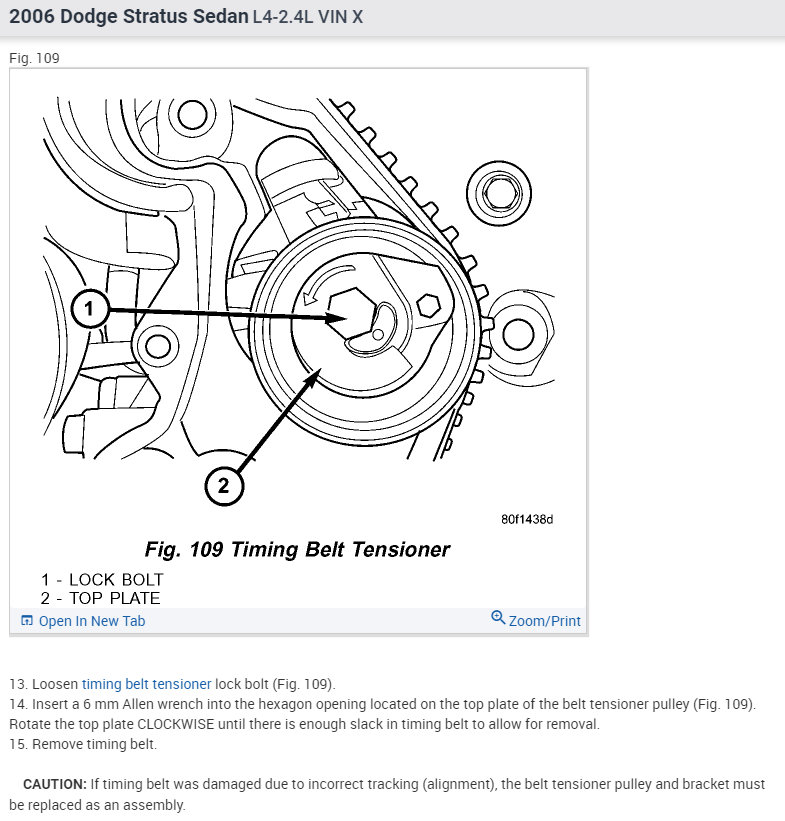

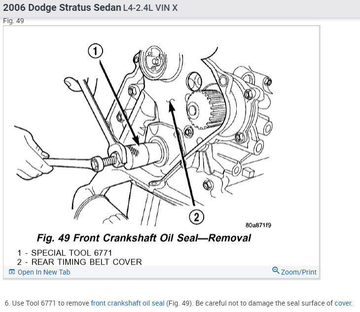

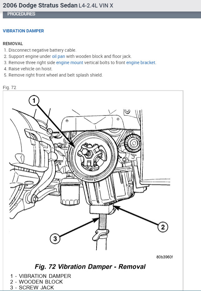

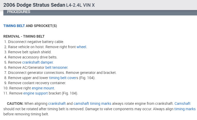

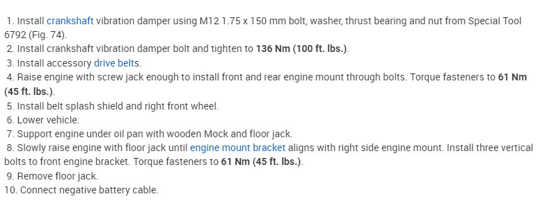

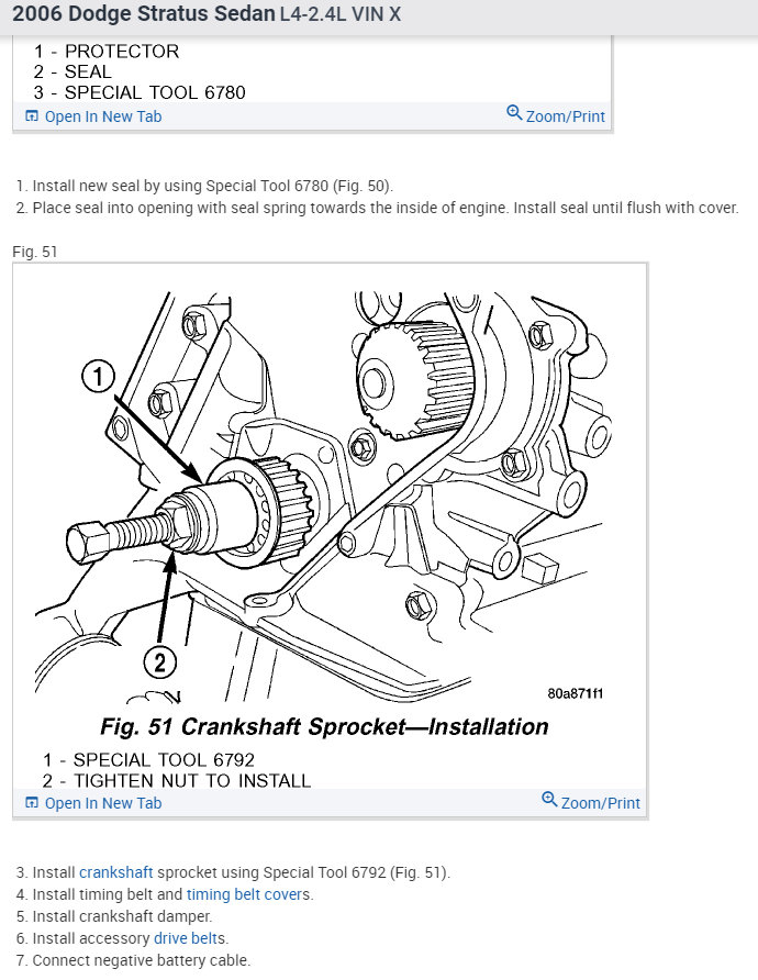

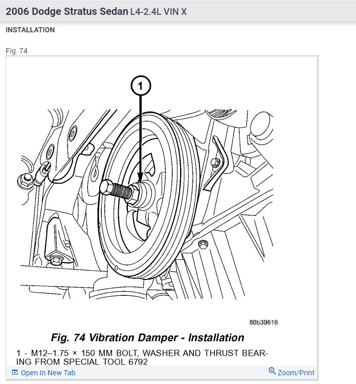

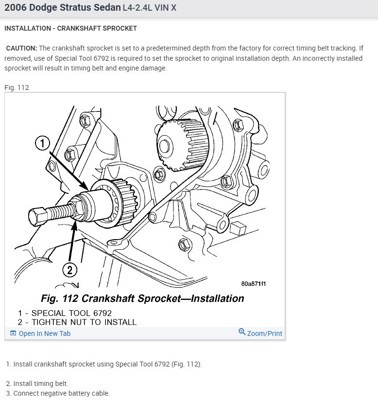

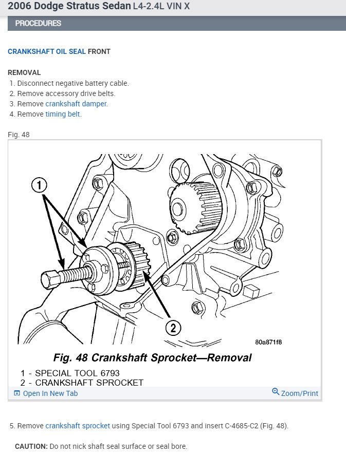

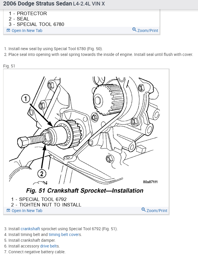

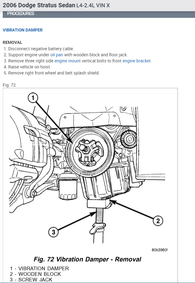

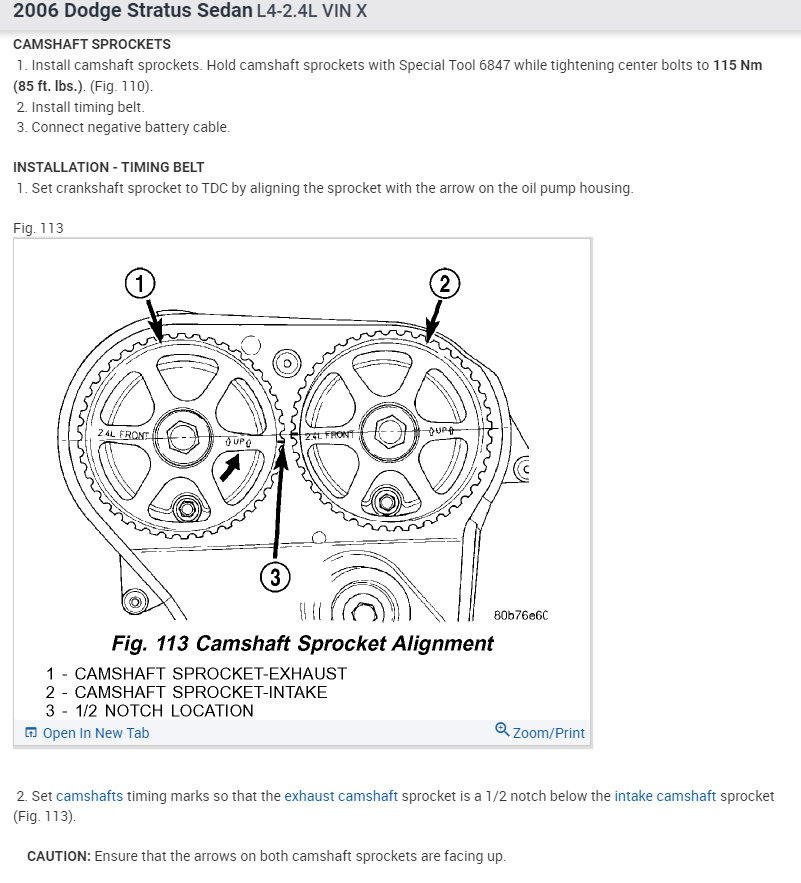

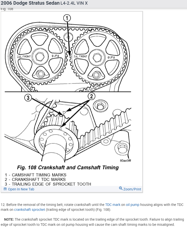

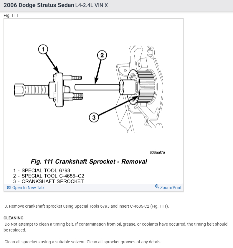

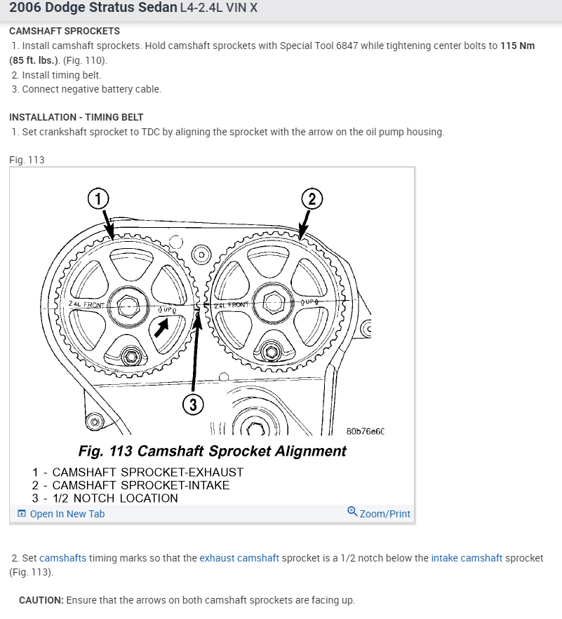

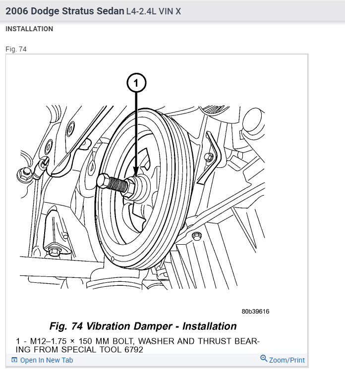

Need to replace front main seal? But don't have knowledge of where to find it or How To get to it. Please help....
Mar 13, 2019 at 10:14 AM
SQM
  • 6,383 POSTS

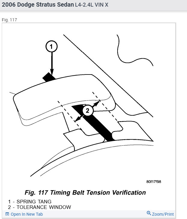

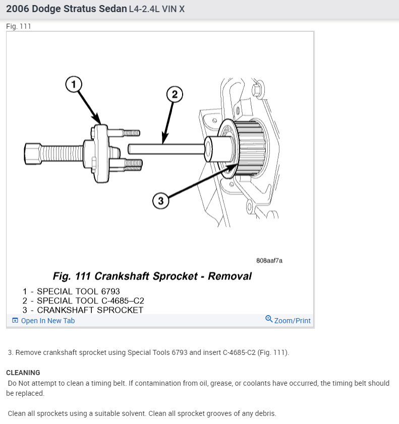

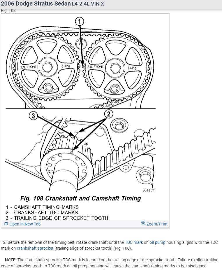

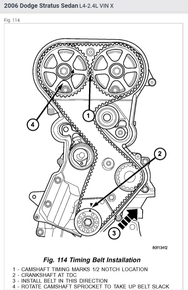

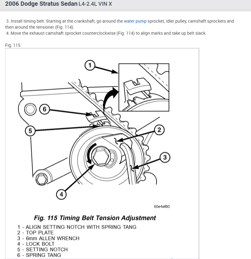

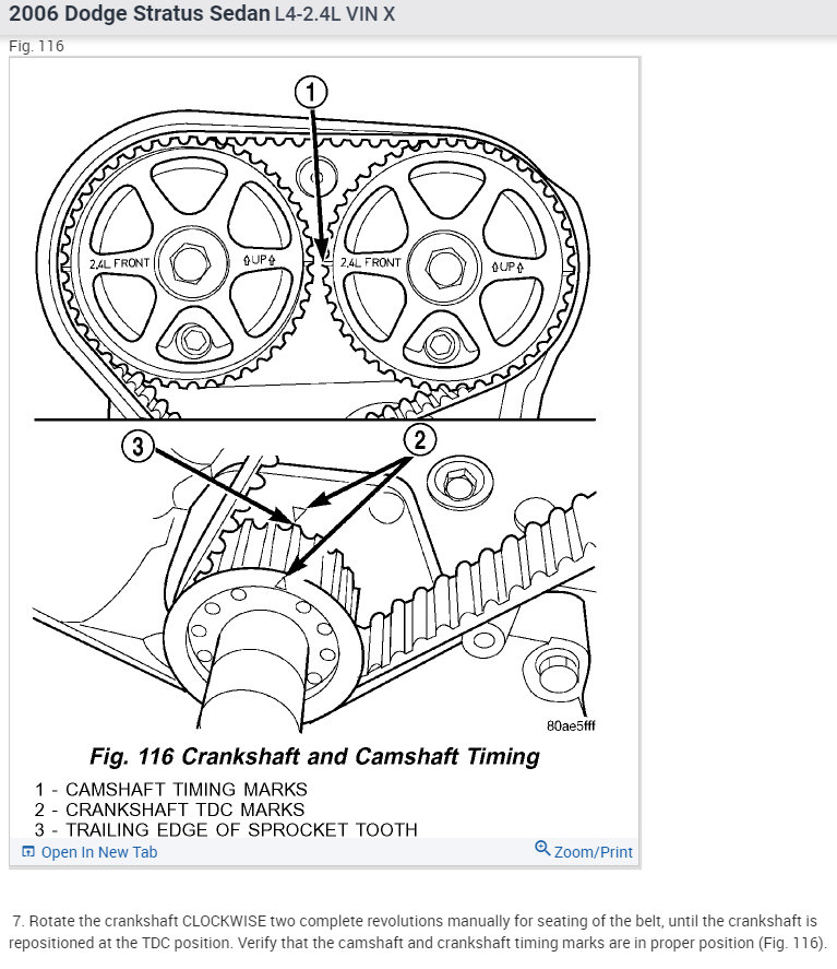

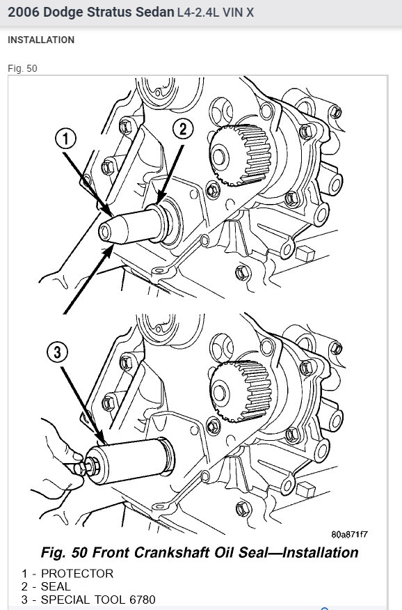

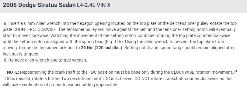

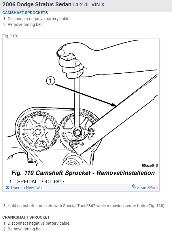

The front main seal or the crankshaft seal is located behind the crankshaft pulley.
In order to replace that seal you will have to first remove the serpentine belt, crank pulley then the timing belt.
Here is a helpful guide:
https://www.2carpros.com/articles/front-main-seal-replacement
I have attached diagrams for all those components replacement procedure below.
