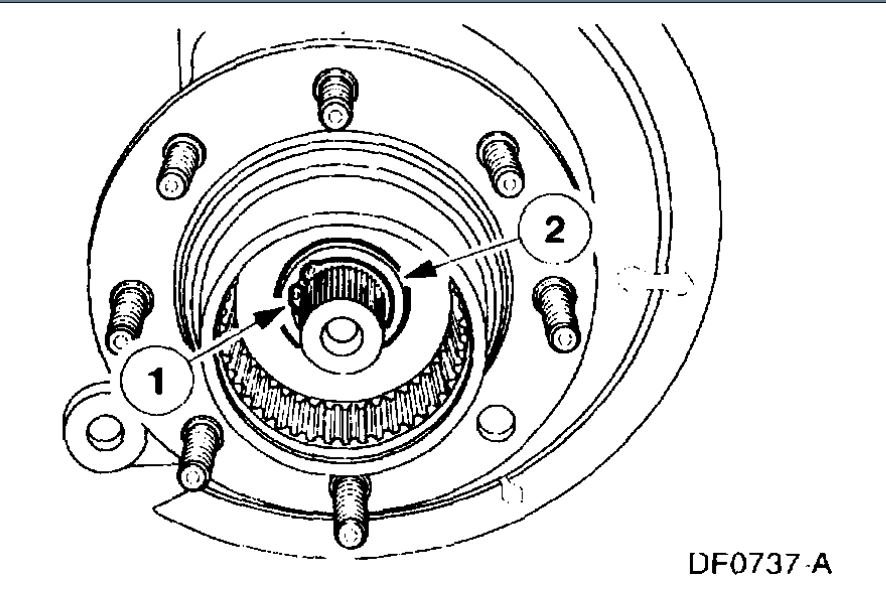

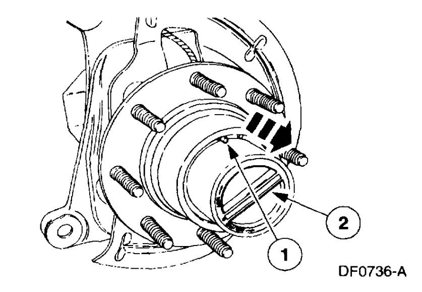

i am looking for a diagram of the front locking hub/bearing assembly and axle exploded view so i can see how it goes together. thank you.

Good morning,
I attached the procedure and the pictures for you of the locking hub.
What repair are you doing?
https://www.2carpros.com/articles/how-to-replace-front-wheel-bearings-and-seals
Removal
1. Raise and support the vehicle.
2. Remove the wheel and tire assembly.
3. Remove the front brake rotor.
4. Remove the hub lock.
1 Remove the retainer ring.
2 Pull outward and remove the hub lock.
5. Remove the axle shaft thrust washers.
1 Remove the snap ring.
2 Remove the three thrust washers.
6. NOTE: The following step is for vehicles equipped with ABS only.
Disconnect the ABS wheel sensor harness.
1 Disconnect the connector.
2 Disconnect the harness routing clips.
7. NOTE: The wheel hub and bearing is a slip fit design and should not require a puller to remove it.
Remove the wheel hub and bearing.
1 Remove the four lock nuts.
2 Remove the wheel hub and bearing.
