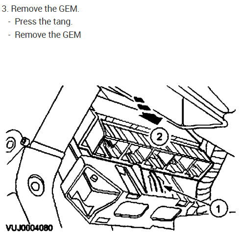

Yes, the car could have a bad fuse.
Here is a guide to help check fuses:

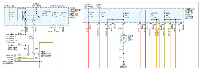

Does this car have a trailer tow package? If the fuses are okay this car has a GEM module that can go out and cause this issue, but I would repair the wiring before replacing it, so it does not blow out again. Here are the fuses and the location of the GEM which is under the dash so you can check it out. The GEM is plug and play so there is no programming needed. Check out the images (below). Let us know what you find.

In the diagram you provided that behind the dash are you saying fuses 29, 38, 47, 48, 55 Some or all go to the lights? One problem I'm having is directing me to the correct fuse that controls the Lights or Flashers / Turn signals. I have not yet checked the cover on the fuse box but the book that came with the car does not tell me anything. Thanks again.

You are welcome, yes these fuses run the GEM which runs the lights etc., but I made a booboo and got the diagrams for a 2005, there is only one fuse that runs the GEM which is fuse #35 in the fuse panel on the left side on the dash. But there are other fuses that run the lighting which I have updated the information below, I would turn the systems on and use the guide above to test the fuses. Yes, the GEM is plug and play. Let me know how it goes.
May 11, 2025 at 4:38 AM

Ken L , just to let you know, I finally got back to the 2007 Jaguar X Type with the turn signal and headlight problem, you were correct fuse #35 was bad and after replacing I now have turn signals again! Thank you so much! I bought some other used headlights and replaced what I had and now instead of having only parking lights on both sides I have one running light and one parking light on the Left side Only! I noticed if I hold in the turn signal stick on the steering column the bright lights will come on but I'm having to hold the stick if I let it go the bright lights go off, does that mean I have a problem with my bright and dim switch on my steering column? Thanks for your help and any more advice you can provide!
Jun 11, 2025 at 4:03 AM
  • 55,688 POSTS
Yep, the switch sounds like it is bad. I would swap it out; glad we got the blinkers working. Let me know if that fixes it.

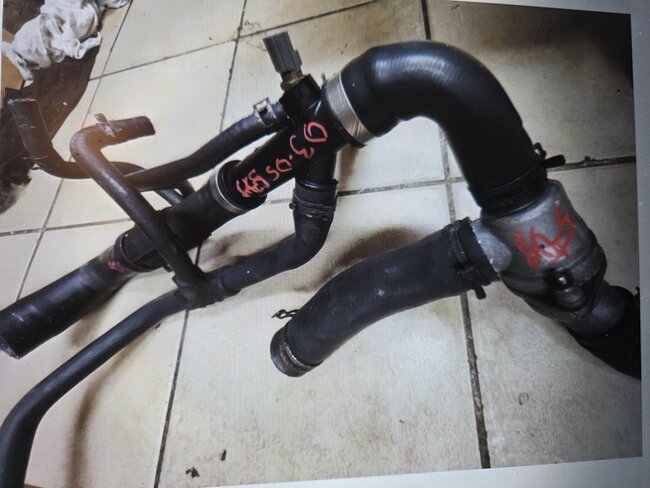

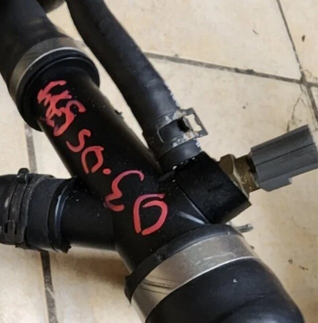

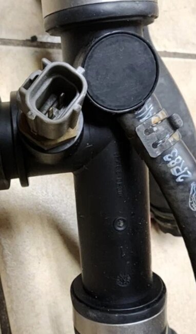

KEN L, My wife has a 2004, Jaguar S-Type, 3.0 , 6cyl. I'm trying to find a part that broke but I'm not sure what it is. I will send a picture of this part , It seems to be part of the Heating piping. the part that broke goes the Coolant Reservoir Tank. I found a complete system on E-bay but I only need the one part or can I block this line off without hurting the car ? Pictures I'll try to attach to this message is from the one on e-bay. Thanks for any info you could provide !
Jun 19, 2025 at 2:29 AM
  • 55,688 POSTS
Sorry, we only handle one problem per thread, please post your new question here, you must be logged in.
