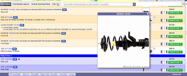

My shock absorber/spring(?) Would make a sound when I moved the steering wheel left/right, sort of like a popping as if it was popping in and out of place? Now it’s making a sound when I drive as well, although a bit of a different one, also a popping/slight banging? What could this be and how do I fix it? I’ve given it to a mechanic who fixed it, I got it back and maybe 3 weeks later it started up again. Could it be a bushing that’s now gone? I’ve attached a video of the sound it makes while I’m driving, near the end I reverse and turn the wheel And you can hear it making a slightly different sound to when I’m just driving.

I would replace the strut assemblies with the complete units.
https://www.2carpros.com/articles/popping-noise
Your issue is the spring is turning inside the strut instead of staying stationary.
I attached the struts for you from Rock Auto. They are easy to change and will take care of the issue.

Yes sorry it said the message sent but it didn’t show up, i said thanks I’ll try it, I’ll have to look on eBay or something for the part since I live in the UK. :)
Aug 28, 2020 at 12:29 AM
Rock Auto may deliver to you. Send them an email and see what they charge.
