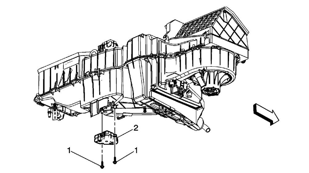

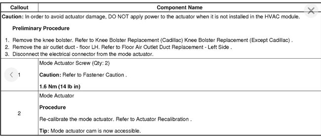

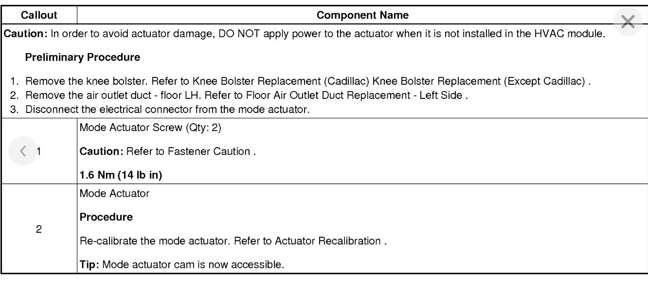

With the heater on full blast set to 90 degrees, I am only getting cold air out of the front vents. When selecting where you want the air to come from defrost, front, and flow. There is no switching between them. The rear heat blows hot air. I think it is my blended air control actuator, but I also know there are two more, one for the modes, one for the temperature and one to blend the air from each side. I just do not know which one could be the culprit.
Sep 25, 2018 at 3:32 PM
Good afternoon.

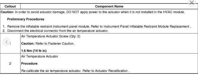

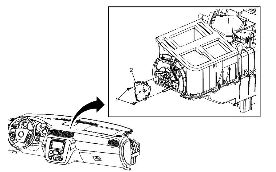

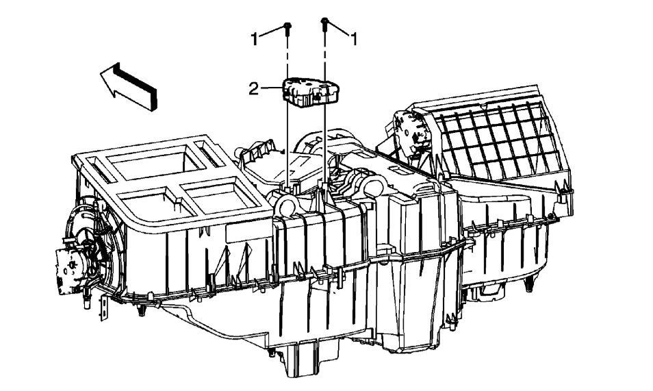

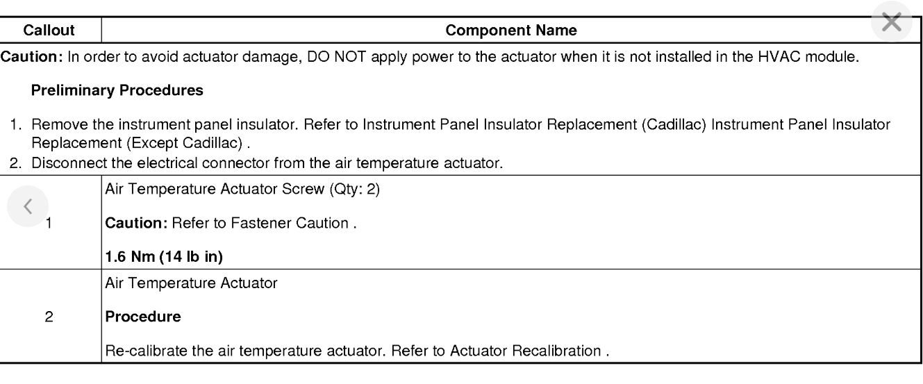

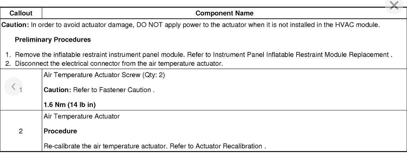

Yes, it sounds like the blend door has failed. It is odd that the mode door has failed as well but I will post the information.

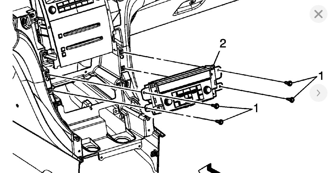

It turns out, the fuse was blown.
Sep 29, 2018 at 8:04 PM
That is even better. a simple repair.
Remember, fuses blow for a reason. It will blow again. Make sure you check the components for good clean tight connections.
Sep 30, 2018 at 4:30 AM
KBALL318
Will do and it was the HVAC IGN fuse that had blown.
Sep 30, 2018 at 7:00 AM
That is the one that feeds the control head. Make sure the connection at the control head is clean and tight.
