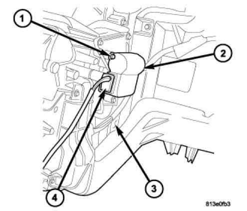

I have hot water going into and out of the front heater core connections at the firewall. Rear heat, on the same plumbing, works fine. I have removed both left and right blend door actuators and manually move the doors to both extremes. Nothing but cold air comes out.
I have not used the heater since the core was replaced two years ago as I was living in Florida. Back in Alaska now and heat would be nice!
At this point I fear I need to remove the dash to see what is wrong. Coolant is full, engine temp is normal, and the blower fan seems to have adequate airflow. I sure would like a simple fix if you have one!
Dec 2, 2019 at 10:51 AM
  • 110,241 POSTS

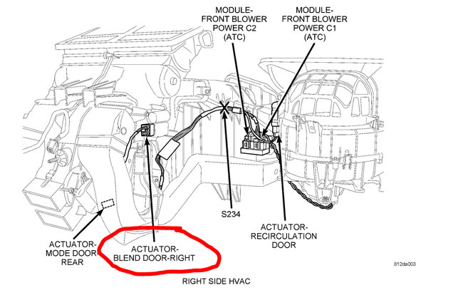

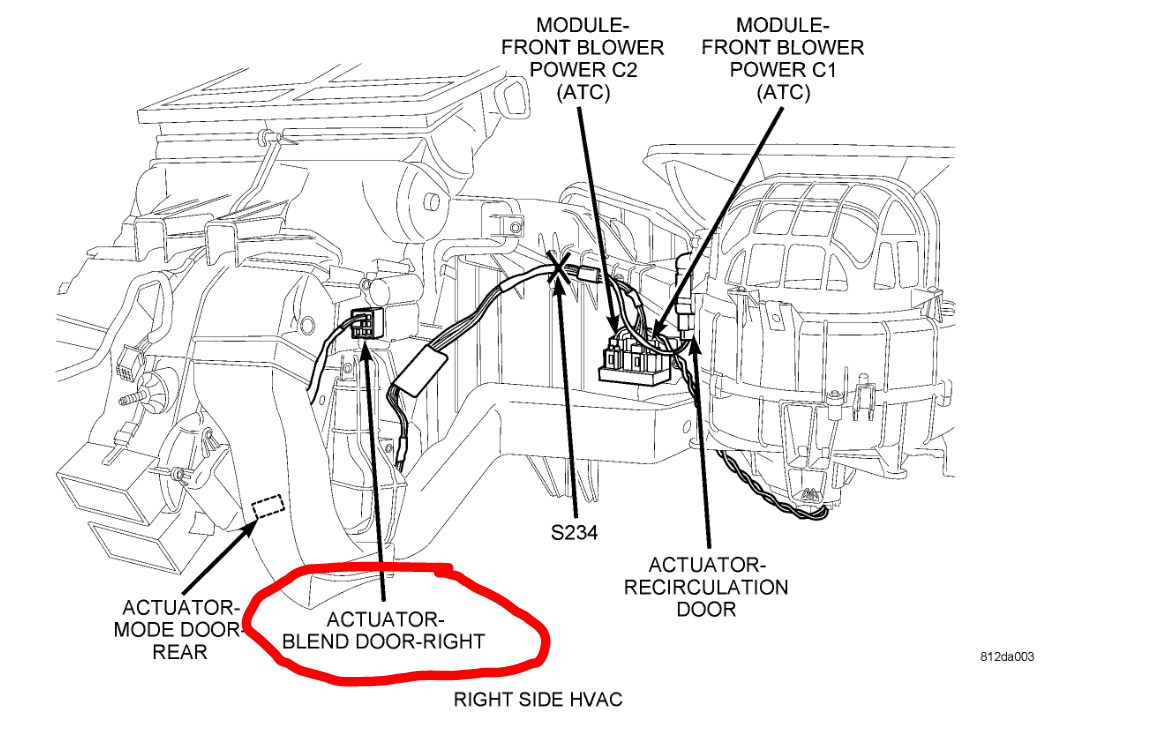

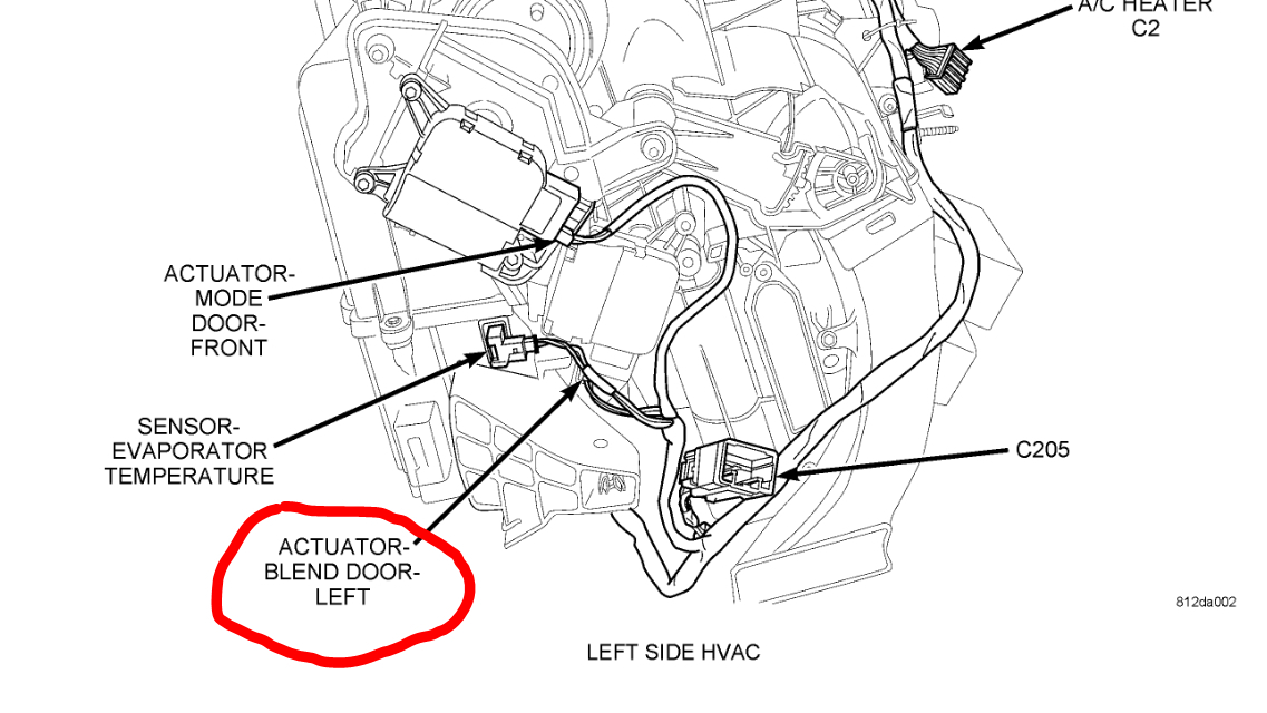

If you manually moved the blend air doors and no heat comes out, you need to recheck the heater core. Air flow is directed either through or around the heater core. This is done by adjusting the position of the blend-air door. My first suspect would have been the actuators, but you indicated they were checked. That only leaves the heater core. If you could, recheck flow through the front heater core. Confirm the hoses are not just getting warm from the engine compartment. If you are certain there is flow, then something is preventing air flow direction or the blend door from working.
This guide can help confirm the issue

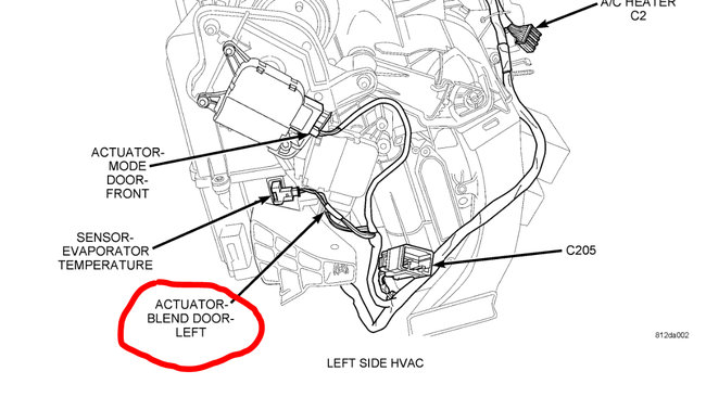

I attached a pics below of actuators. Confirm those are the ones you checked. Check out the diagrams (Below). Please let us know what happens.

Those are the two actuators I removed and the blend doors moved freely stop to stop. I also know hot water is flowing through the core. I retired Dodge mechanic told me they had challenges getting adequate water through the front heater core because the straight run past the "t" had less resistance than going through the front core. What he used to do was eliminate the "t". He said to run from the engine outlet to the front core inlet directly. Then from the front core outlet to the rear core inlet. Finally from the rear core outlet back to the return on the engine. I did this and it didn't change anything. I still have rear heat, which means the water has to be passing through the front core as it is plumbed now.
I know it goes against all logic but there it is. I believe it is a parallel type core. If so, is it possible a large portion of it is plugged up but enough open to let water pass to the rear? The rear heat showed 96 degrees today when it was 13 degrees outside.

One more question if I may. In your diagram, left side, there is an actuator mode door front. What does that one do? I can see any way to get the hardware off without pulling the dash pad.

Based on how you have it plumed, it has to flow through that core for it to be that hot on the rear. As far as there being a partial plugging in the front core, you would at least get some heat. Now, you moved the doors manually and it made no difference. Something had to have been put together wrong.
Additionally, the mode actuator is what is responsible for air flow direction. It does nothing with temp.
At this point, you have done everything right. However, what is next? Here is what I would do. There is a cover over the heater core and tubes. Remove the cover, confirm the heater core is hot, inspect blend air door function (actually see what is happening), and hopefully, there will be an answer. I'm starting to question if something was put in backwards such as one of the doors. Something is blocking the heat.

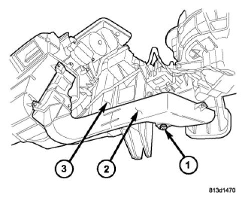

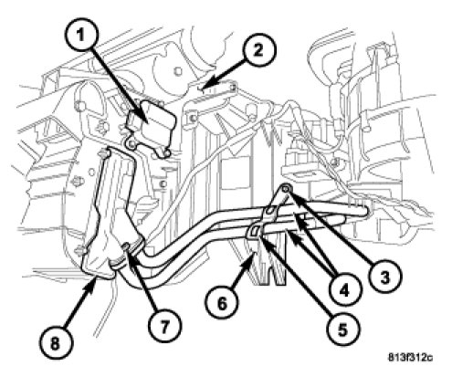

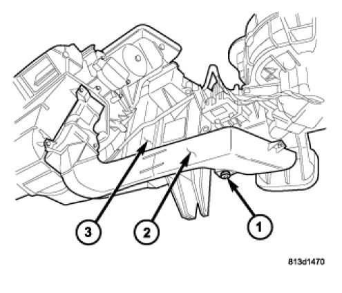

Here are directions for removal of heater core. You won't need to complete the entire list. Just go far enough to see what may be happening.
______________________________________
2007 Jeep Truck Commander 4WD V8-5.7L VIN 2
Front Heater Core - Removal
Vehicle Heating and Air Conditioning Heater Core Service and Repair Removal and Replacement Front Heater Core - Removal
FRONT HEATER CORE - REMOVAL
REMOVAL
WARNING: Refer to the applicable warnings and cautions for this system before performing the following operation. Failure to follow the warnings and cautions could result in possible personal injury or death.
WARNING: Disable the airbag system before attempting any steering wheel, steering column, or instrument panel component diagnosis or service. Disconnect and isolate the negative battery (ground) cable, then wait two minutes for the airbag system capacitor to discharge before performing further diagnosis or service. This is the only sure way to disable the airbag system. Failure to take the proper precautions could result in accidental airbag deployment and possible personal injury or death.
NOTE: Take the proper precautions to protect the front face of the instrument panel from cosmetic damage while performing this procedure.
NOTE: LHD model shown in illustrations. RHD model similar.
pic 1
1. Disconnect and isolate the negative battery cable.
2. Drain the engine cooling system.
3. If required, disconnect the heater hoses from the heater core tubes in the engine compartment.
4. Remove the instrument panel.
5. Remove the five screws (1) that secure the heater core and tube cover (2) to the HVAC housing (3).
6. Remove the heater core and tube cover from the HVAC housing.
pic 2
7. If equipped with dual zone heating-A/C, remove the blend door actuator (1) from the passenger side of the HVAC air distribution housing (2).
8. Remove the screw (3) that secure the heater core tubes (4) and retaining bracket (5) to the HVAC housing (6).
NOTE: Take proper precautions to protect the carpeting from engine coolant. Have absorbent toweling readily available to clean up any spills.
9. Remove the bolt (7) that secures the heater tubes to the heater core (8).
10.Disconnect the heater core tubes from the heater core and remove and discard the O-ring seals.
11.Install plugs in, or tape over the opened heater core ports.
12.Carefully pull the heater core out of the HVAC air distribution housing.
13.If required, remove the heater core tubes from the vehicle.
You will not be able to see the entire core, but you will be able to touch it to confirm heat and hopefully see if one if the doors is not properly installed.

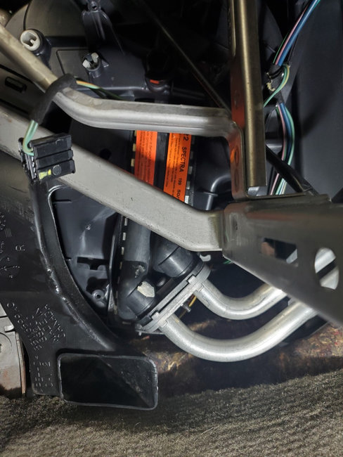

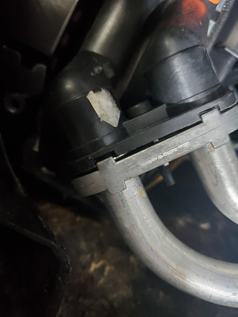

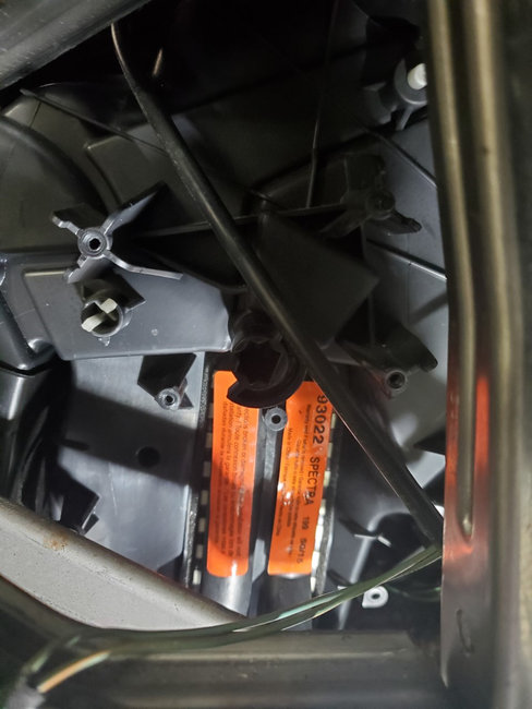

Well, I have enough of the dash apart to see the end of the core but that's about it. I did find the occasional coolant smell. The connection to the pipes is not flush at both ends. Slight drip at the bottom. Trying to upload pictures but i may need to go to my laptop to do it.
Dec 7, 2019 at 5:17 AM
PIPERPUP
  • 10 POSTS
I tightened up the fitting and stopped the leak. Ran the car and both the inlet and outlet pipes at the core are hot. The end of the core is hot, but perhaps not as hot as the pipes.
Opening and closing the blend door makes a very minor change in temperature, but not nearly what you would call hot. Keep in mind the car is in a heated garage (70 degrees) as I am doing this.

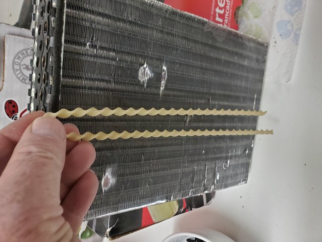

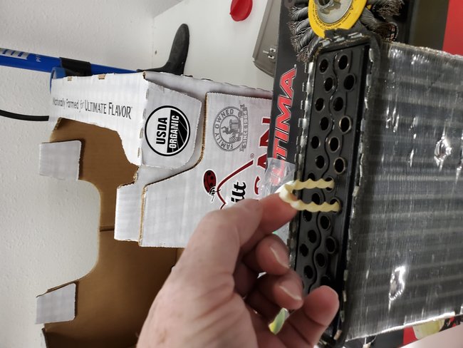

Update:
So I had some heat when it was 20 degrees or warmer out. At 20 below zero I only had heat for about 1 minute. Googling suggested a partially blocked heater core that could not keep up with demand. So I ordered an OEM heater core and installed it. 27 below zero yesterday and it was so hot on max that I could actually turn it down!
Curiosity was killing me so I opened up the aftermarket core I paid a large sum of money to have installed two years ago. I discovered the blockage was by design. Every tube had the plastic rods in them. I do not know if these exist in the OEM core or not but since it works great now I would doubt it. Sure is nice to have heat!
Jan 4, 2020 at 1:10 AM
  • 110,241 POSTS
I never had one apart. That looks more like pasta. Was that in every tube?
Jan 4, 2020 at 10:33 AM
PIPERPUP
  • 10 POSTS
Yes, every tube. They had to reduce flow significantly.
