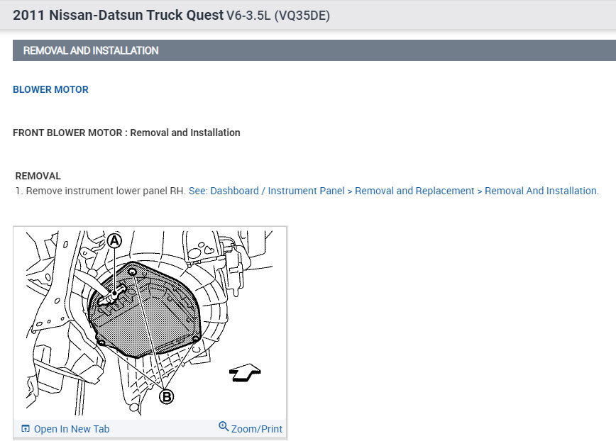

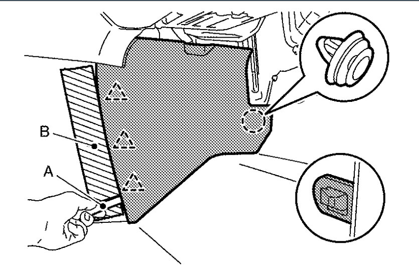

The blower motor is under the dash on the passenger side of the vehicle. You will need to remove the RH lower instrument panel cover which is very easy. It is held in with clips. See pic 1 below.

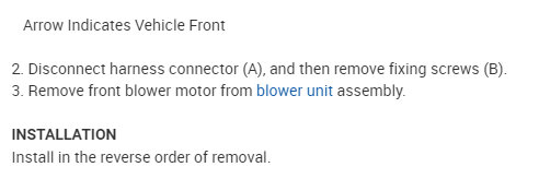

Once you remove that, look up and you will see the fan.
Here is a link you may find helpful simply because it is more descriptive. Take a look at it.
https://www.2carpros.com/articles/blower-fan-motor-works-on-high-speed-only
Pics 2 and 3 are the directions from the manual.
