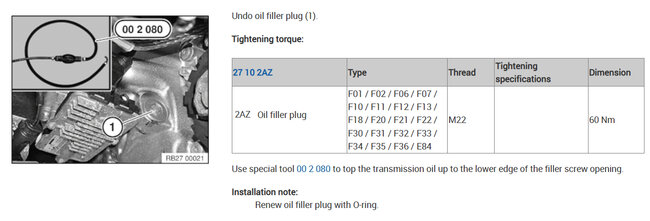

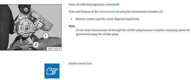

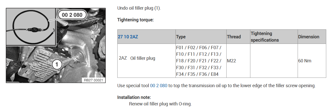

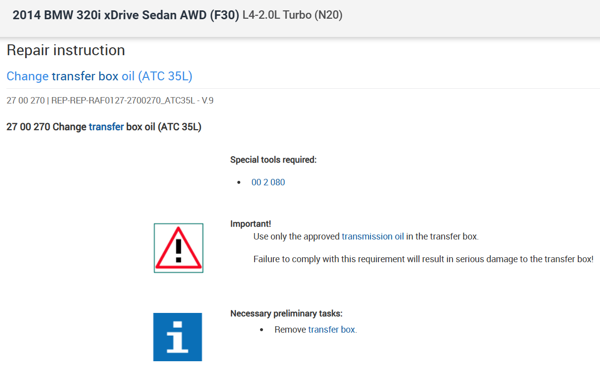

What happens is the fluid inside the transfer case wears out and allows the clutches to not lubricate as needed which causes the car to vibrate as you have described. I would do a fluid change, but you need to use the BWM fluid, it might be expensive, but it is worth it. I just went through this problem in an AWD Mercedes Benz, $70 a quart but it worked.
Transfer box
Capacity .................... 0.44 liters
Transmission oil must flow/drip gently out of the oil filler opening. If necessary, pour in oil to lower edge of filler screw opening.
Note: Only change oil when transfer box is at normal operating temperature. Check out the images (below). Please let us know what happens.

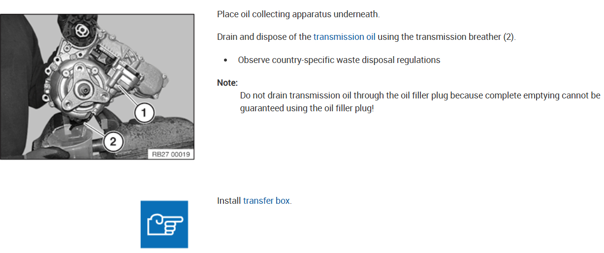

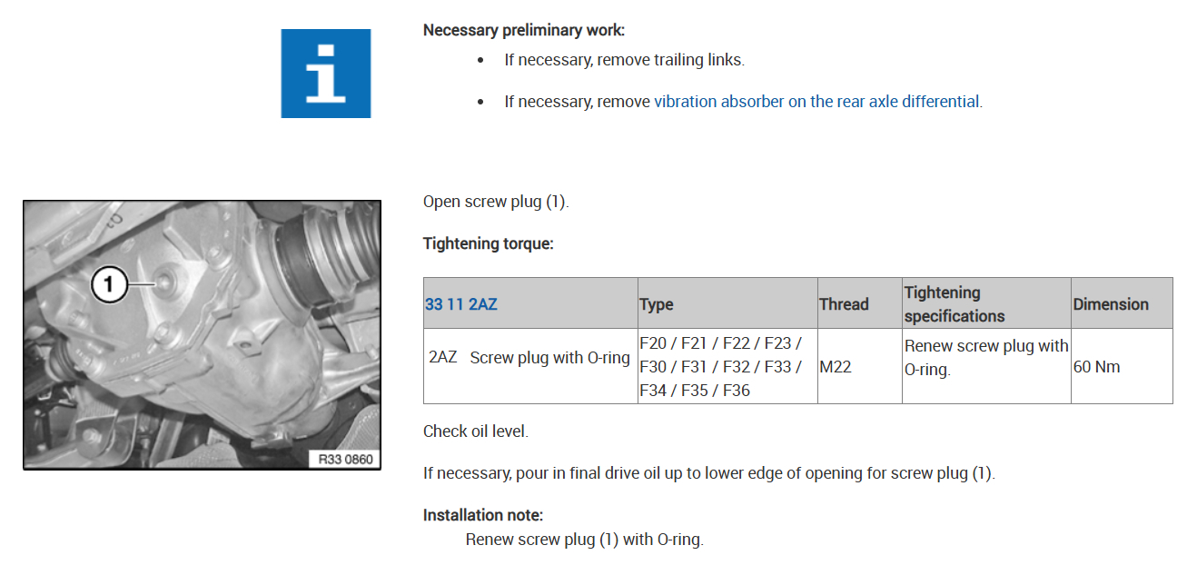

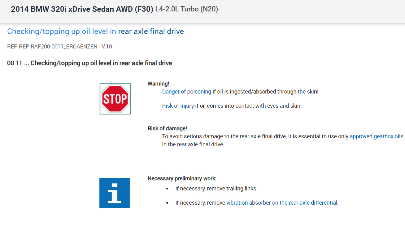

It is hard to say if the vibration is caused by that, I would change the fluid in the rear differential first, it has clutches that will "chatter" when the fluid wears out. To me it is worth a try before diving into the axle/diff. Suck the fluid out for replacement.
Hypoid Axle Oil G3 (Fuchs Titan EG 4218)

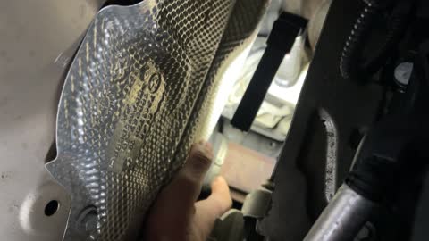

Yes anything is possible, but from my experience with these cars I have never seen a bad rear diff, usually front or the transfer case. I found the lower control arm has a lot of free play, and part of one of the engine mounts is broken I believe so will change those too.

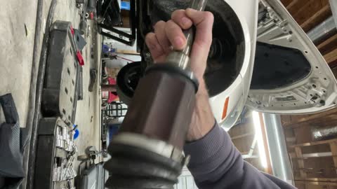

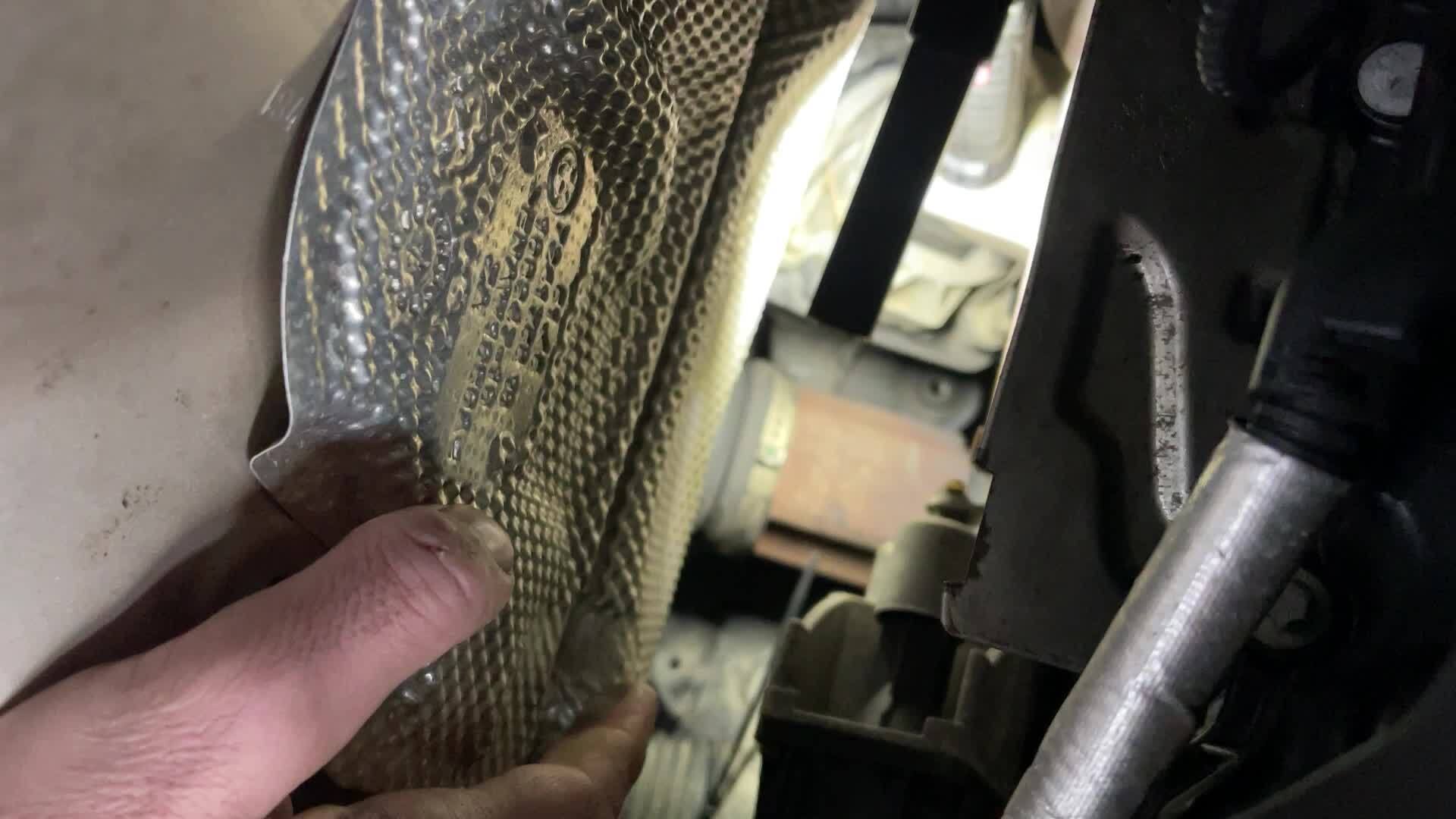

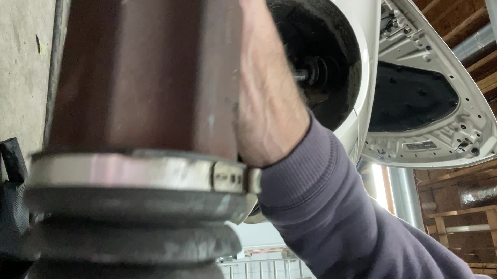

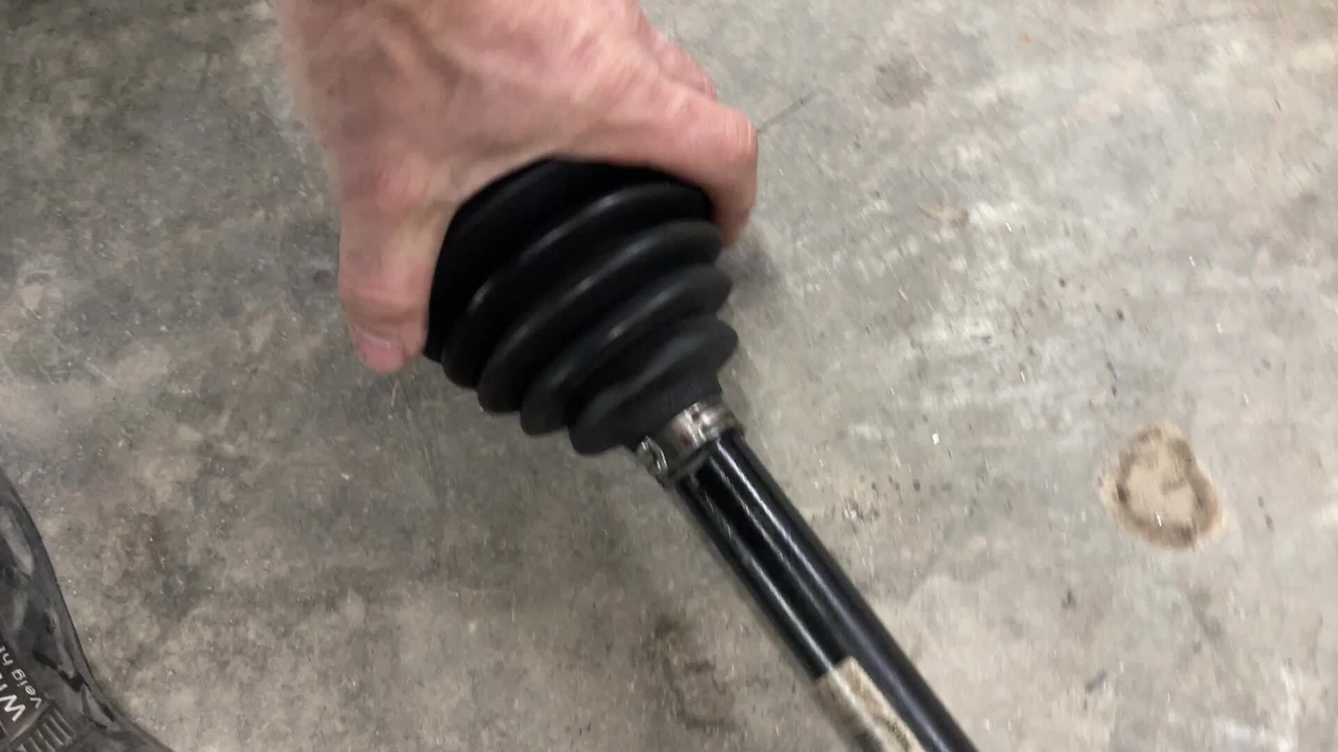

Attached videos. I removed it to check it out anyways since i was replacing the lower control arm.

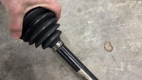

I know they always say there should be very minimal play when moving the axle up and down, where will the play be? inside the boot? Hard to tell if there is anything wrong with it while out. The fluid out of the front diff looks good, not dark and clean. I also balanced the front wheel on that side and its fine, moved it to the back, ordered a used axle, mounts and the control arm.
Jan 17, 2025 at 3:56 AM
  • 55,711 POSTS
Yep, you are correct it is hard to tell if the CV axle is the problem unless you take it apart and inspect the cage or inner race for wear. Let me know if this fixes the problem I am interested.
