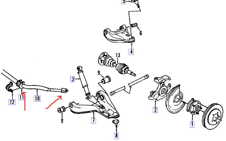

I been hearing a noise sounds like a slight knocking sound coming from the passenger side front end when i go over bumps. I have checked the ball joints and the lower control arm. The control arm has about 1/8 inch play in the bushings. Does it need to be changed if that much slack is there? And there is a shaft that goes into the transmission that the CV Axle hooks on to. When I go at low speeds I can hear the shaft knock. Is this normal or what can I do to fix this problem? Thank you for your time in helping me out.

Sure, I can help you, to me there are two main causes of this kind of noise, either the sway bar bushings are bad or a strut itself is bad, can you see any leaks at the strut shaft seal? If so this is a sign the strut needs to be replaced. To check the sway bar bushing you might need to remove them or use a pry bar to work the links while checking for play. This guide may help as well.
https://2carpros.com/articles/popping-noise/
Please upload a short video of the noise if you can.

Here is what I am tanking about for the sway bar mounts.
