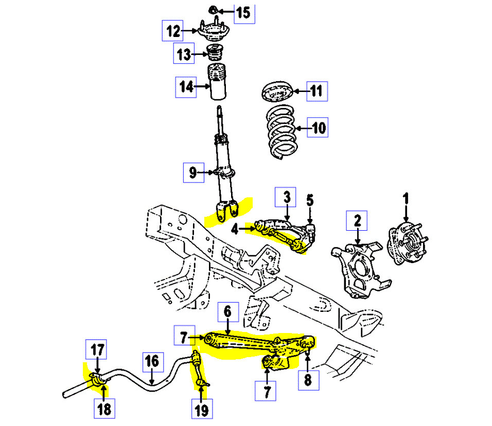

I have replaced the front end suspension with the exception of the struts. I have lubricated all the fittings. I still have a loud squeak on the drivers side that I just can’t silence.
Aug 25, 2021 at 11:10 AM
  • 110,194 POSTS
Is it loud enough for you to record and upload for me to hear? Also, what all was replaced? Were ball joints inspected or replaced, bushings, stabilizer links, control arm bushings, and so on?
Let me know. Also, I attached a pic below of the suspension. I highlighted areas that can cause noise. Keep in mind, it could be the strut as well. The lower strut bolt goes through a rubber grommet which can be bad as well.
Take a look at the pic and let me know if you have inspected or replaced the parts highlighted.
See pic below.
