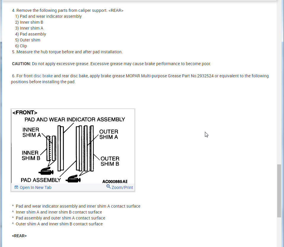

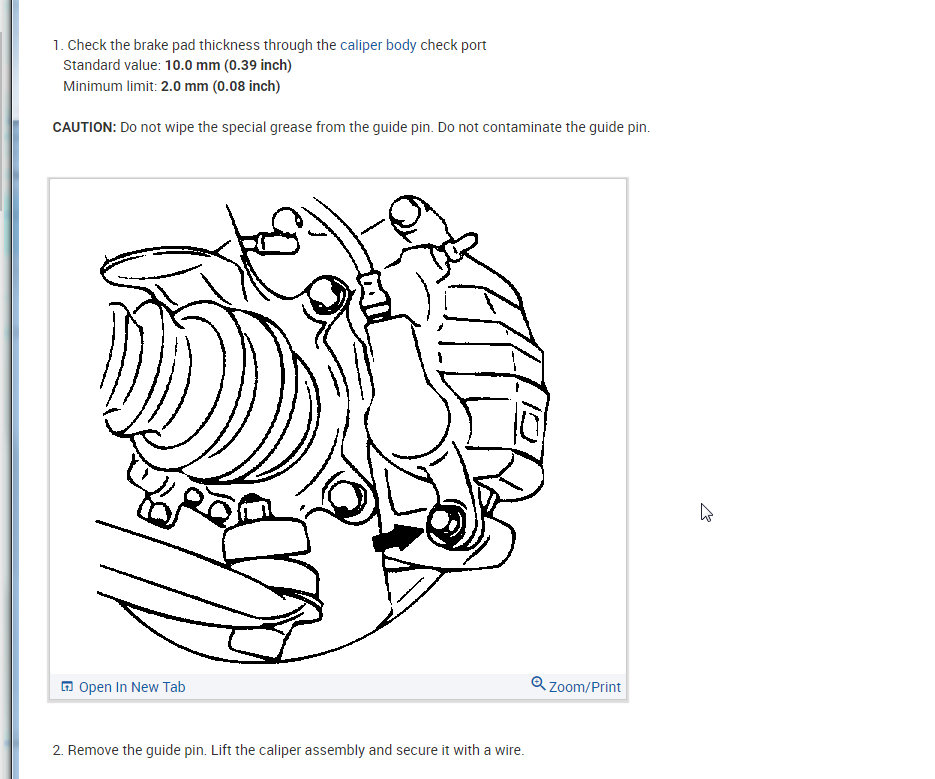

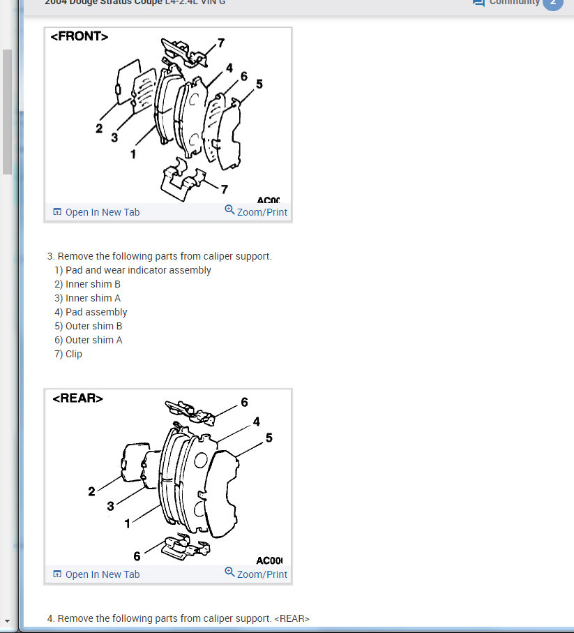

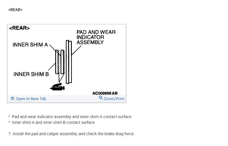

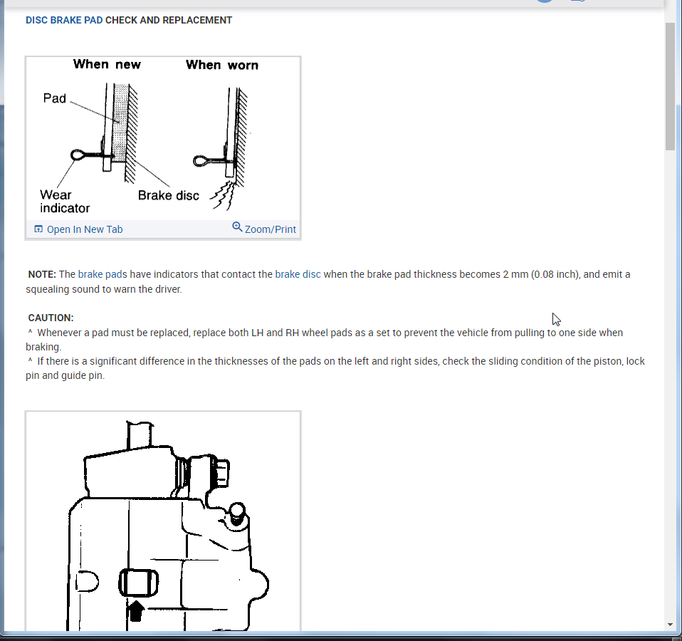

This is pretty typical when you have warped rotors which happens from heat due to excessive hard braking or normal wear. Basically the metal heats and cools as the brakes are used and after enough time the metal just warps so they require replacement or turned if you have enough metal left on the thickness of the rotor.
I attached the info needed to replace the brakes as you will want to replace the pads if you replace rotors because the pads already have a wear pattern from the old rotors so you want to start fresh. If the pads are new you can sand them flat but that is not recommended in most cases.
Here is a guide that will help:
Lastly here is the process out of the manual for the replacement of these which will help as well. Thanks
