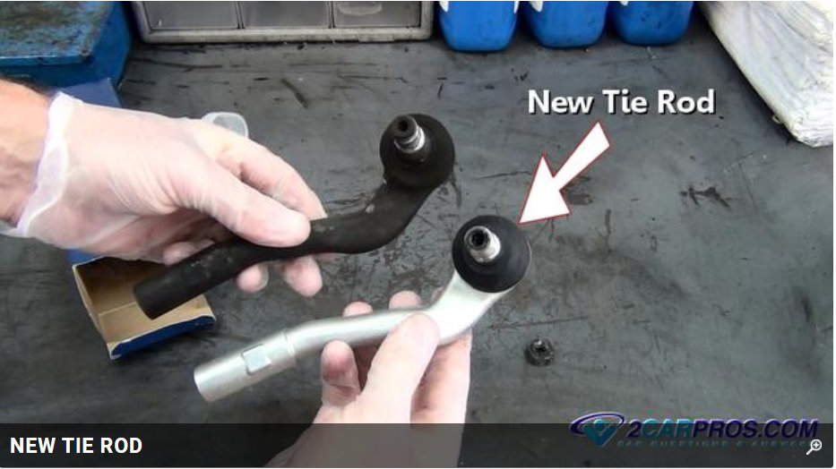

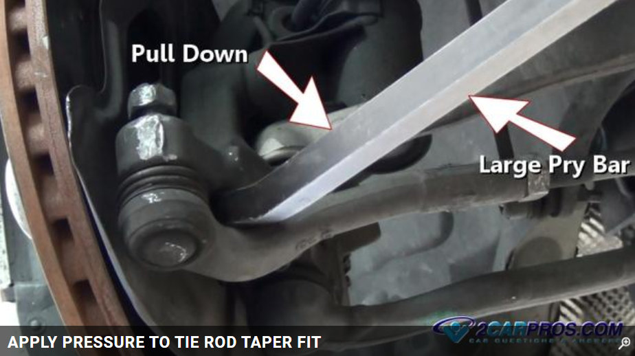

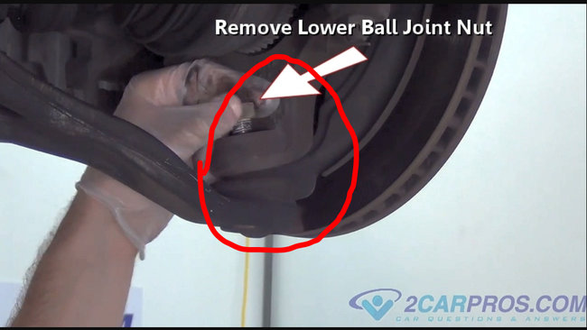

There's a fairly rough shake in the front end of my car while driving 40 mph and up, almost feels like the wheels wobble from time to time and the car kind of lightly shifts to the side for a split second.

While the vehicle is up, place your hands at 3 and 9 o'clock and with pressure, see if there is excessive play back and forth. If there is, have a helper watch the tie rods to see if one is worn and moving without the rest of the steering components. If you find play in a tie rod, here is a link that explains how an outer tie rod is replaced. Also, I attached two pics below (pics 1 and 2) so you know what to look for. Please remember, the pics show an outer tie rod. There is one attached to the outer one which goes into the rack and pinion gear (under the rubber boot) which can also go bad.
https://www.2carpros.com/articles/tie-rod-end-replacement
Next, place your hands a 12 and 6 o'clock and do the same thing. With pressure, see if there is excessive play or if you feel a clicking or clunk. If you do, have a helper watch the ball joints as well as the wheel hub to see if there is play in the bearing. If you look at pic 3, I circled a ball joint to help you locate it.
