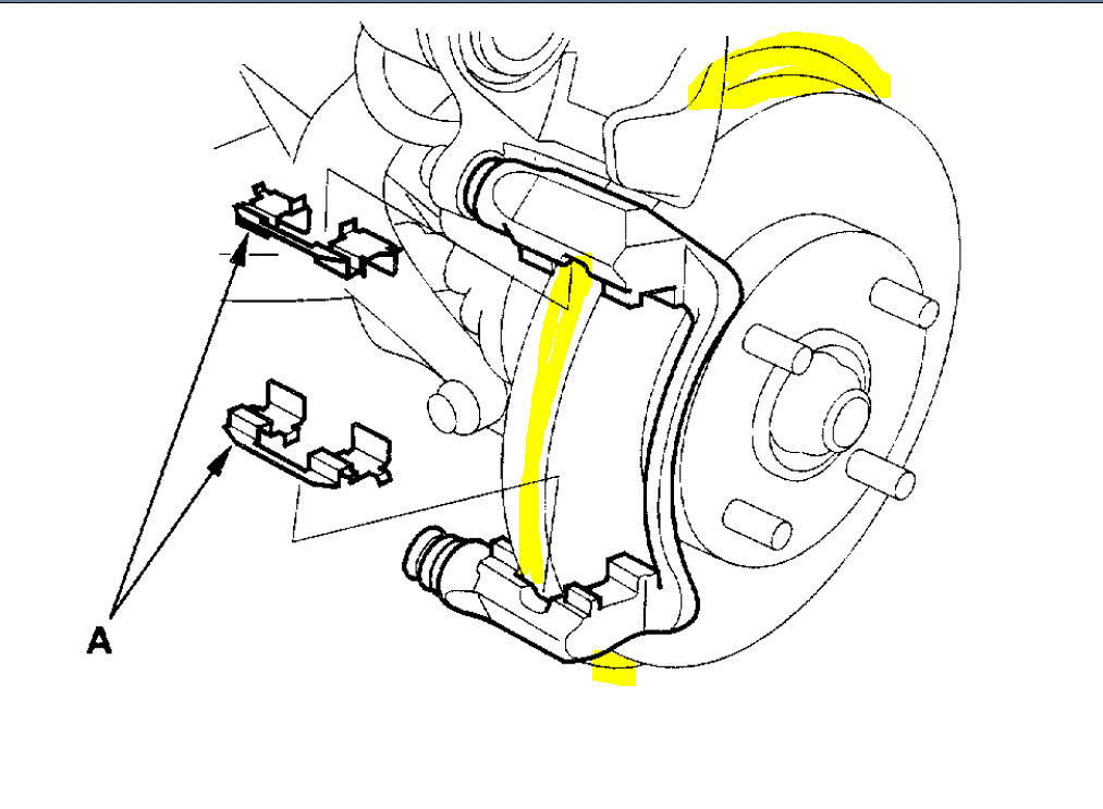

Rattling noise around 30 MPH. stops if I press on the gas or brake. Brand new tires balanced twice. Brand new CV axles DS and PS.
May 15, 2021 at 9:30 AM
  • 110,244 POSTS
Do you need to be moving for the sound to appear? If you have the vehicle in park and rev the engine, do you ever hear it? Is it loud enough for you to record and upload it for me to hear? Are there any other symptoms that seem to tie into the noise? Have the backing plates behind the brake rotors been checked to make sure nothing is bent and touching or if they are coming apart due to rust? I attached a pic below and highlighted where the backing plate is located.

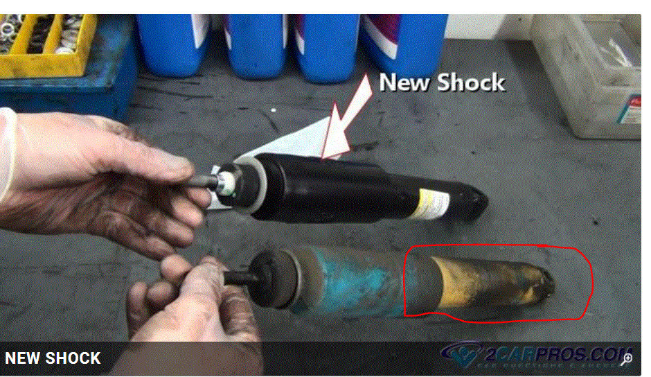

Ryan,
If you feel it in the floor and not steering, chances are it is a rear wheel. Did you check the tires, rims, and you indicated it starts when hitting a bump, so did you check the shocks?
Most times when it is a front-end issue, you feel it in the steering wheel. Rear-wheel issues are mostly from the rear.
Bounce the rear of the vehicle and see how many bounces it takes for it to stop. More than three is an issue. Also, inspect the shocks for leaks. If you take a look at the attached pic, I circled where you may see oil from a blown shock.
