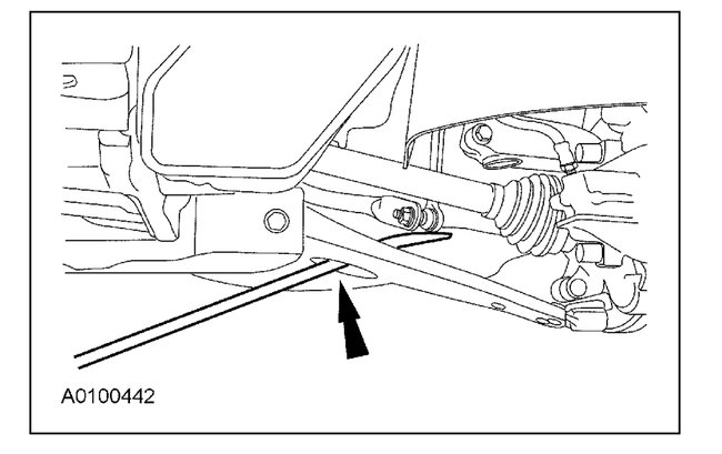

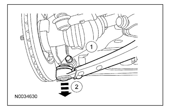

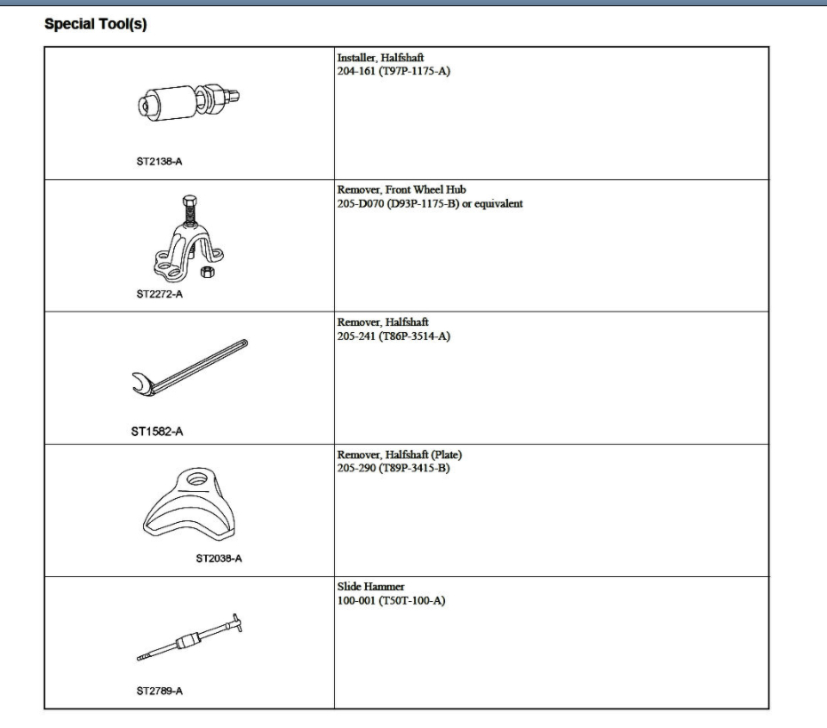

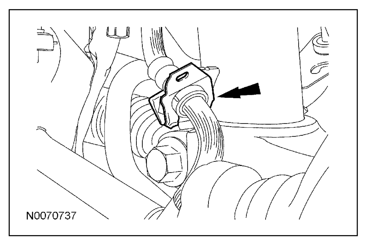

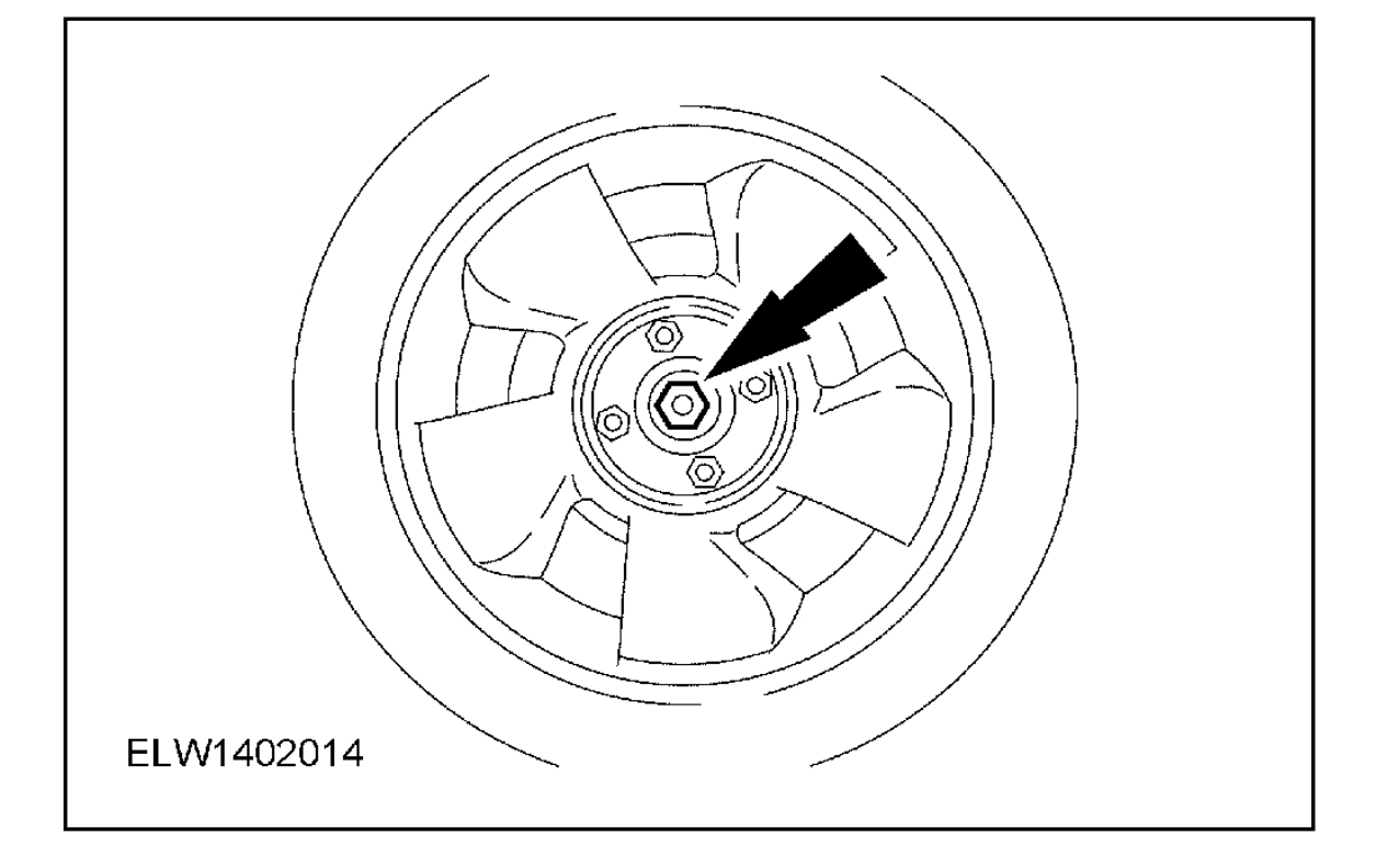

I attached the procedure for the axle replacement below for you.

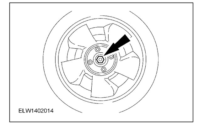

3. Remove the LH wheel and tire.

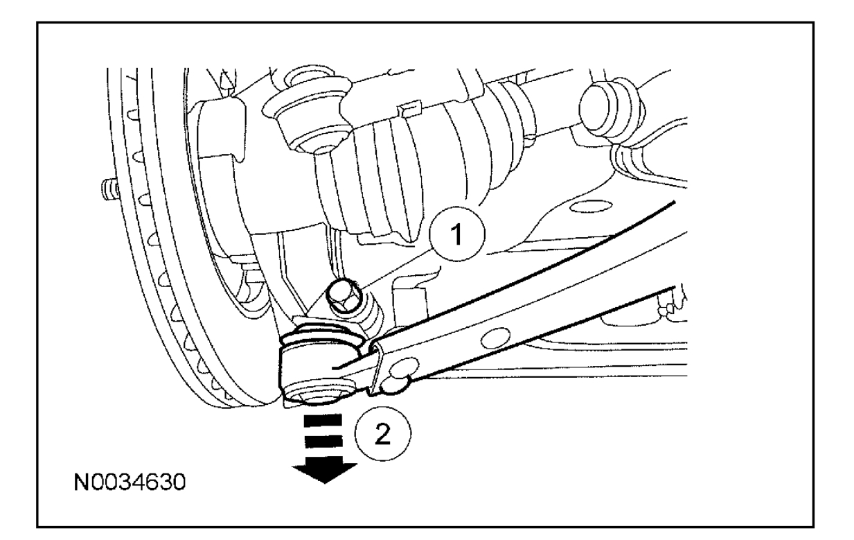

4. CAUTION: Do not use a prying device or separator fork between the lower arm ball joint and the knuckle. Damage to the ball joint or ball joint dust boot may result. Only use the pry bar by inserting it into the lower control arm body opening.
Detach the lower arm ball joint.
1 Remove the lower arm ball joint nut and bolt.
2 Detach the ball joint.
Insert a pry bar in the lower control arm body opening to separate the ball joint.

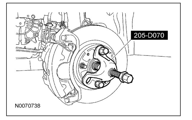

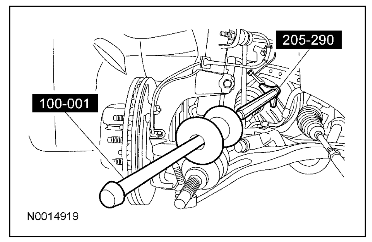

5. Press out the halfshaft stub from the wheel hub and detach the LH halfshaft from the wheel hub.

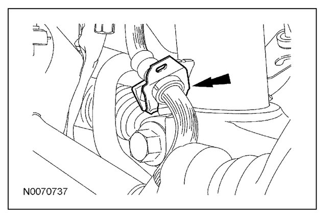

6. Remove the retainer holding the brake tube in the strut bracket.

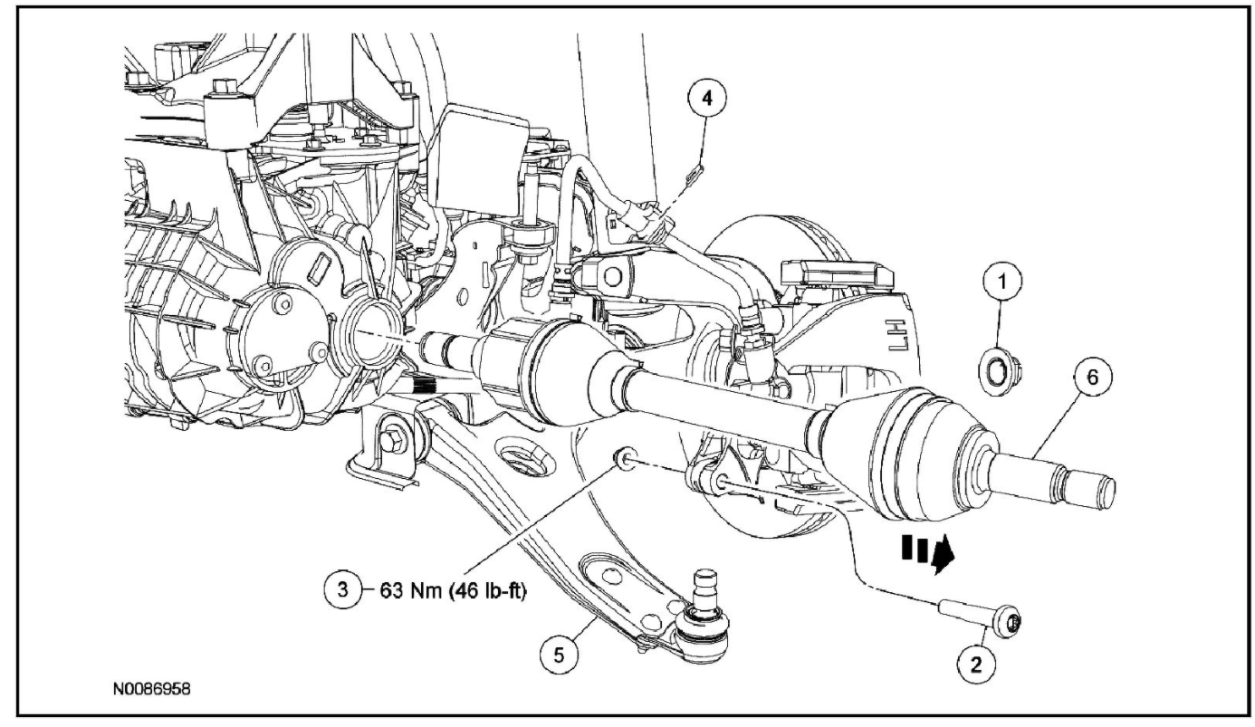

7. NOTE: Support the halfshaft. The inner joint must not be bent at more than 18 degrees.
Remove the LH halfshaft from the transaxle.
8. Remove and discard the halfshaft circlip.
Installation
1. Install a new halfshaft circlip.
2. NOTE: Make sure the snap ring is fully engaged by pulling on the joint housing.
Install the LH halfshaft into the transaxle.
3. Using the special tool, install the LH halfshaft stub into the wheel hub.

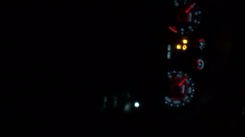

Here is the video. Thanks
Dec 21, 2020 at 11:34 AM

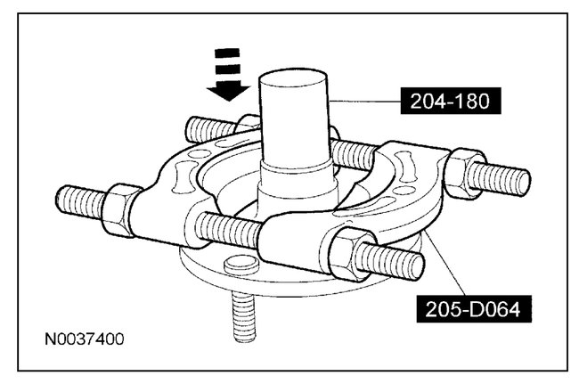

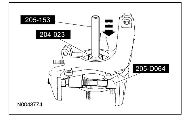

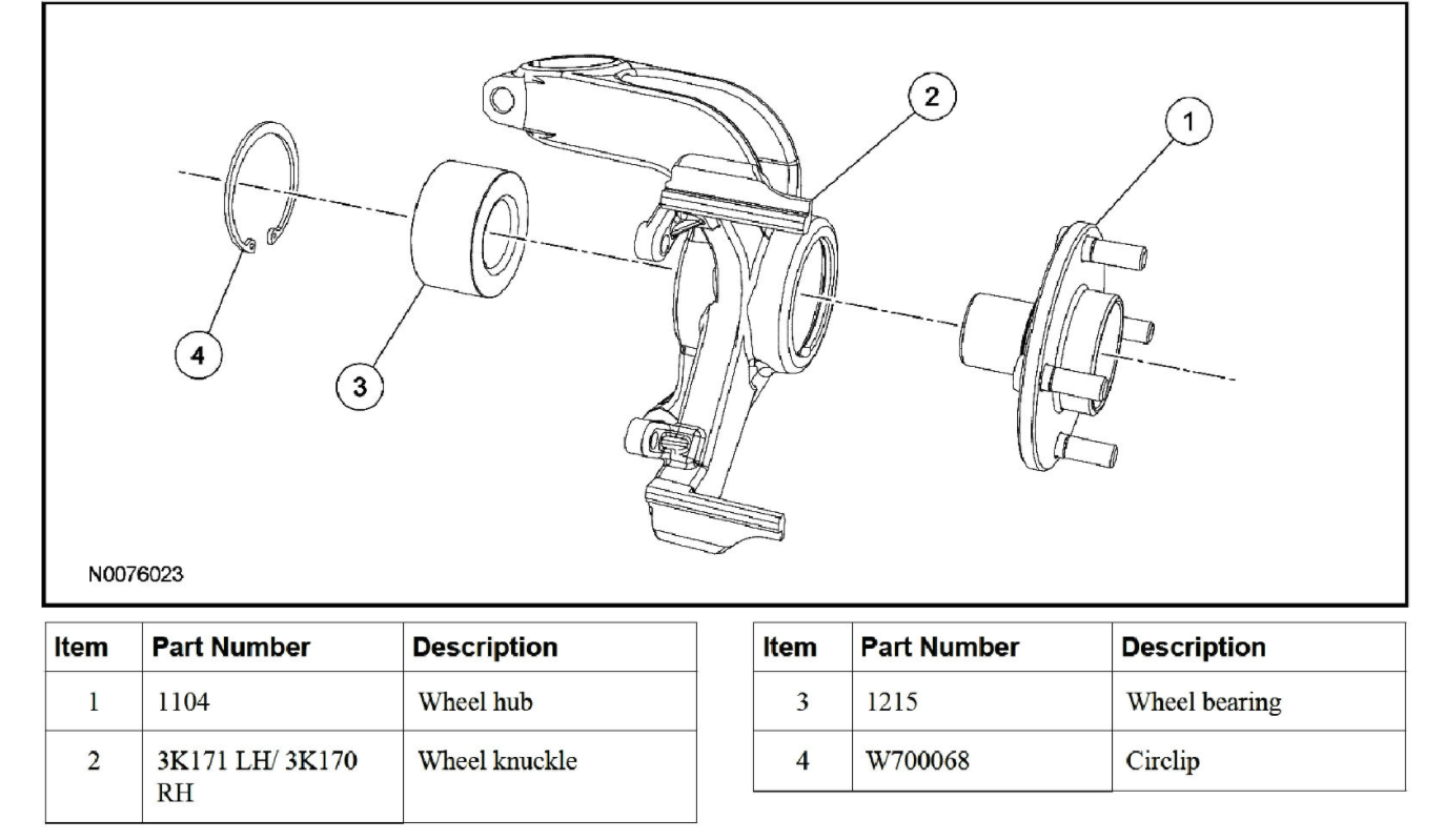

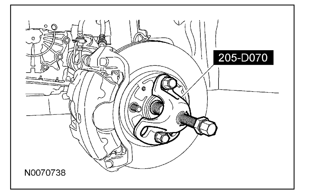

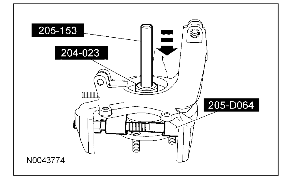

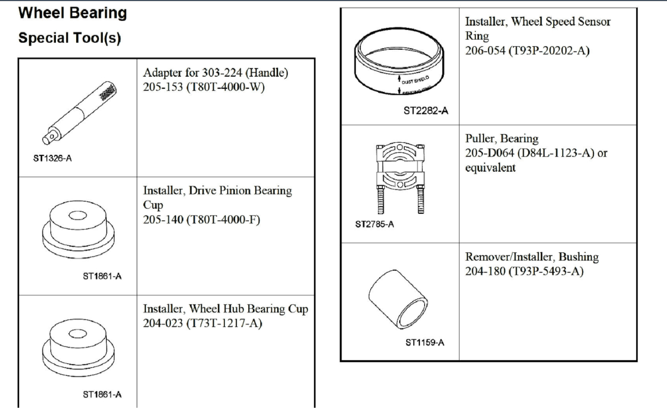

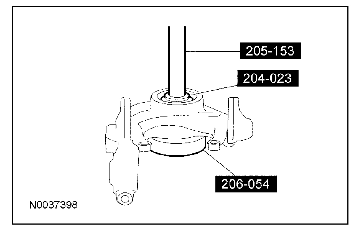

This sounds like the hub bearing in the spindle where the brake rotor is located. I attached the procedure below for you for the repair.
https://www.2carpros.com/articles/bearing-hub-replacement
https://www.2carpros.com/articles/bearing-press-how-to-use
Dust front brake material gets into the bearing and wears it out in a short period of time.
Removal
1. Remove the wheel knuckle.
2. Remove the circlip from the wheel knuckle.
3. NOTE: After the wheel hub is removed from the knuckle, the wheel bearing must be discarded. The bearing inner ring will remain in the wheel knuckle.
Using the special tools, remove the wheel hub and outer bearing race.
4. CAUTION: The special tools must be used to prevent damage to the hub. If the hub is damaged, a new hub must be installed.
CAUTION: Do not use heat to remove the bearing inner ring or damage to the bearing may occur.
Using the special tools, remove the bearing inner ring from the wheel hub.
5. To aid in removal of the bearing outer ring, install the bearing cage onto the inner ring and install the assembly into the wheel knuckle.
6. Using the special tools, remove the bearing outer ring from the wheel knuckle.
Installation
CAUTION: To prevent wheel speed sensor ring damage, make sure that the sensor ring is clean. Make sure that the sensor ring does not make contact with metal surfaces and avoid any impact on the sensor ring.
1. NOTE: Make sure the wheel bearing is installed into the wheel knuckle with the wheel speed sensor ring, colored black, at the wheel speed sensor end of the wheel knuckle.
Using the special tools, install the new wheel bearing to the wheel knuckle.
2. Using the special tools, install the wheel hub into the wheel knuckle.
3. NOTE: Make sure the circlip does not cover the wheel speed sensor or damage to the sensor may occur.
Install the circlip into the wheel knuckle.
4. Install the wheel knuckle.
