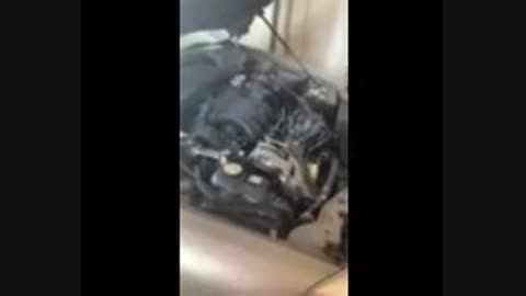

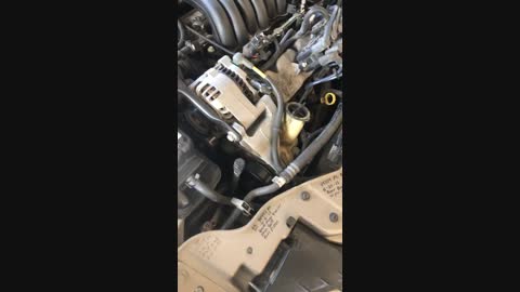

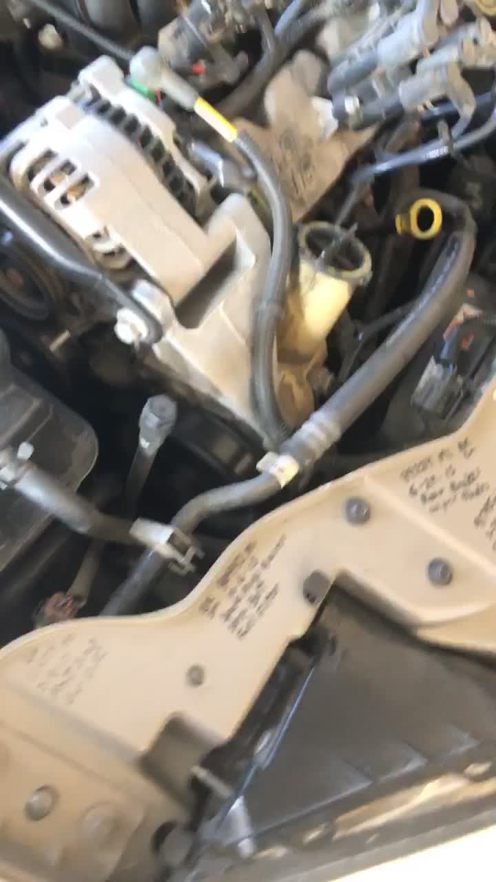

My engine is making a noise it’s like coins in a jar type of noise and I’ve checked the transmission fluid and the engine oil and they both are fine. I took it to the shop and I thought it was something with the brakes but that doesn’t make sense because it’s when I could start the car not when I push on the brakes, any ideas on what it could be?

Sadly on a cold start the sound would be much louder, but this isn’t it on a cold start. It is the kind of higher ringing you can hear.

Here we go I got a good sound of it.
Jul 5, 2019 at 5:11 PM
Okay. That is better. I would have the belt removed and see if it does it. That sounds like a bearing to me. The other thing you can do is spray some WD40 on the pulleys as they are spinning and see if it quiets down. This will indicate a pulley is failing and the noise is the metal on metal of the bearing.

It was the A/C compressor for future reference.
