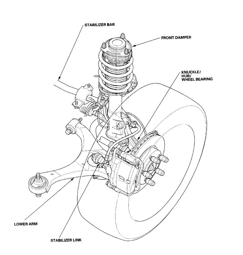

I have had inner and outer tie rods replaced on both sides. New struts, new passenger ball joint. New lower control arms and bearings on both sides replaced. But I still get this pop noise when I rotate the wheel. A clunk noise when I apply brakes and then again when I apply gas. And then it squeaks now as I drive at times. It shudders at low speeds. What is wrong with my car?

it sounds as if the mechanic that did the work may have left something loose. i would get the car back there and get them to road test and recheck all their work, start here.

As you can see by the diagram below you have replaced pretty much everything. As odd as it sounds, have them check your motor mounts as well... if the engine moves around when you are off and on the gas it changes the cv joint geometry and will cause vibrations and shuddering as well as the engine making noise as it moves forward and back
Check out the guide below, it will help you figure this out
https://www.2carpros.com/articles/popping-noise
Suspension diagram attached below
