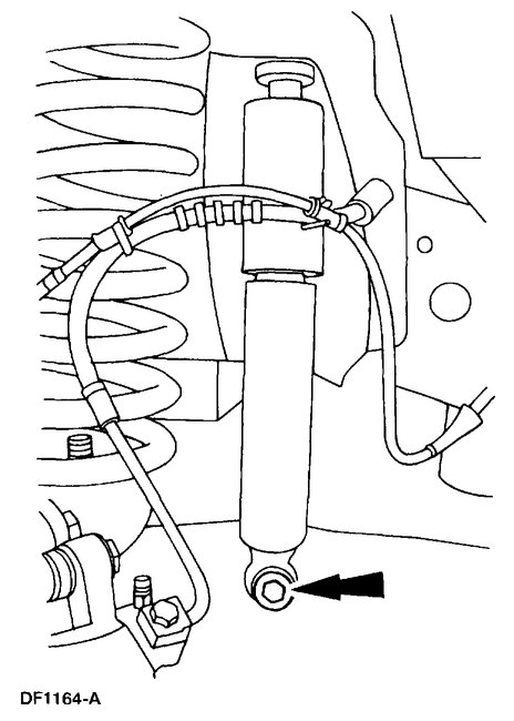

When driving at low speeds like 30-40 MPH and hitting a small bump in road at times I feel the front end bouncing. I also can feel it in the steering wheel. But once a brake and slow way down it goes away and drives normal. I live on gravel and have checked the wheels for build up of gravel dust. It also doesn't appear to have any missing wheel weights. Could this be ball joints, shocks, or what? Any information would be appreciated!

Try this simple test. Bounce the front of the vehicle. When you stop bouncing it, it should stop within 3 bounces. If it doesn't, the shocks are bad. Things like ball joints won't cause it to bounce.
If you find they are bad (and it sounds like they are), here are directions for replacement.

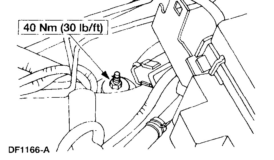

pic 1
1. Raise the hood and remove the upper shock absorber retaining nut and upper shock absorber insulator.

pic 2
3. Remove the lower shock absorber retaining nut and remove the shock absorber

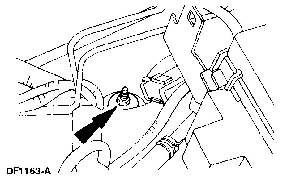

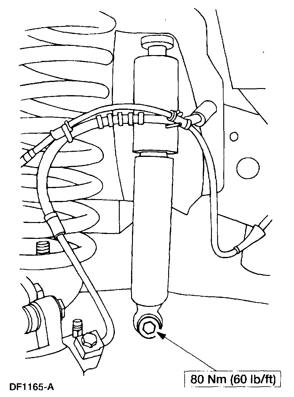

Installation
pic 3
pic 4
1. Using new fasteners, follow the removal procedure in reverse order.
