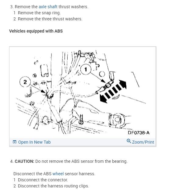

When in four-wheel drive it binds up and clunks and when in two-wheel drive. it floats all over the road are these related to each other and how to fix?
Mar 4, 2022 at 10:39 PM
Good morning,

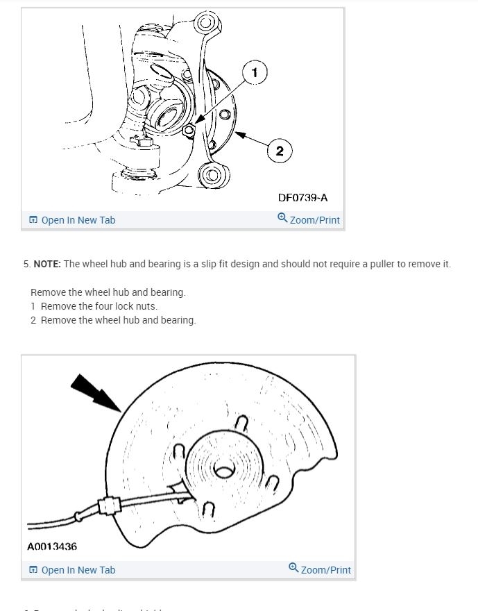

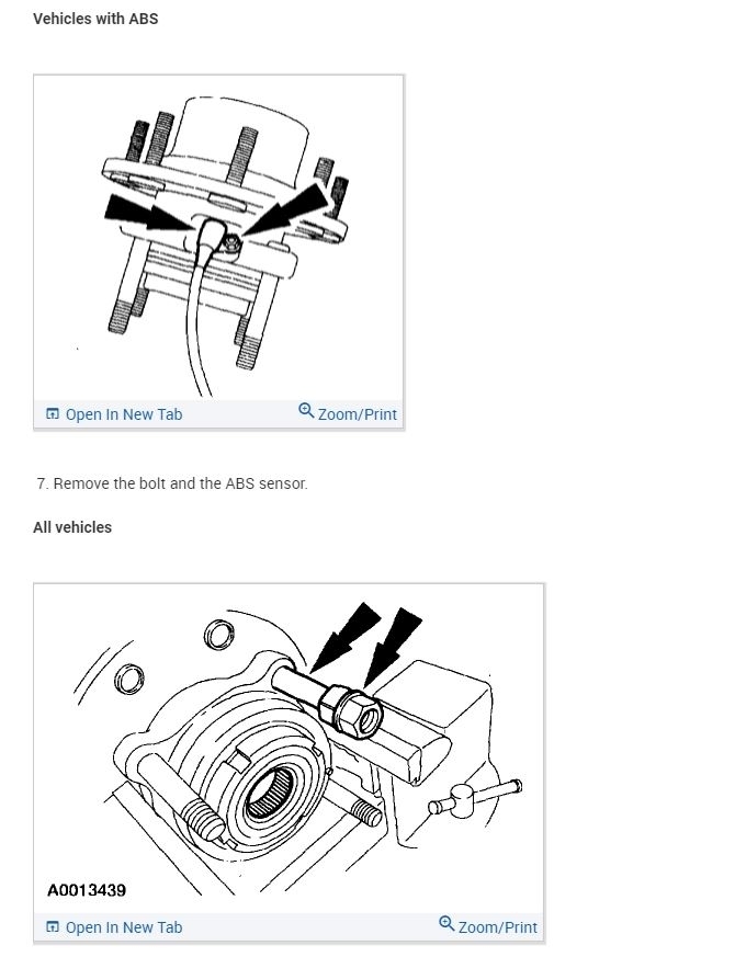

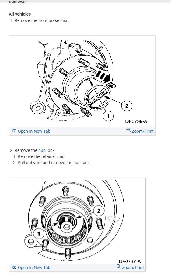

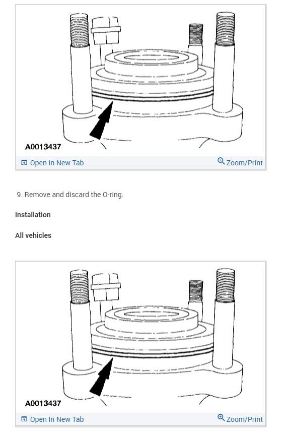

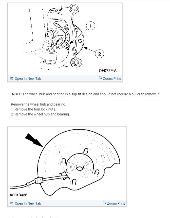

The first thing I would do is to replace or service the wheel bearings on the front wheels. Old hard grease will cause this issue.
https://www.2carpros.com/articles/how-to-replace-front-wheel-bearings-and-seals
Due to the age, I would replace the inner and outer bearings and races.
I attached the procedure for you for this.
