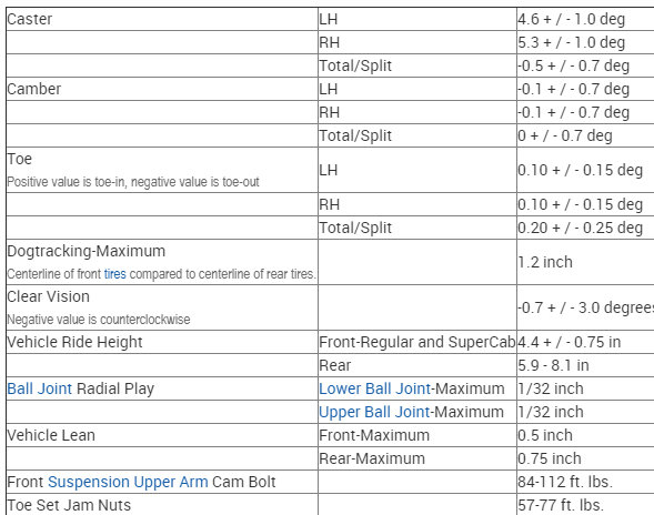

What are the alignment specs for the truck listed above?
Oct 16, 2019 at 3:02 PM
DANNY L
Experienced Mechanic
5,648 POSTS
Hello, I'm Danny.
Here is the specifications you've requested.Picture is attached below.Hope this helps and thanks for using 2CarPros.

Thanks Danny I appreiciate your help.
