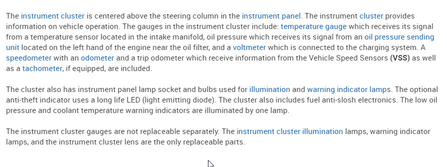

Only engine check and battery lights are working. I checked all fuses and sims they are okay . Question, could be a relay? but i don't know which one? Thanks in advance for your help and cooperation. Best regards
Jul 6, 2019 at 2:33 AM
Hi Gemma44

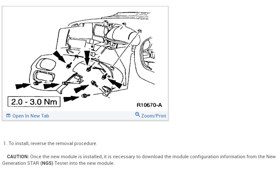

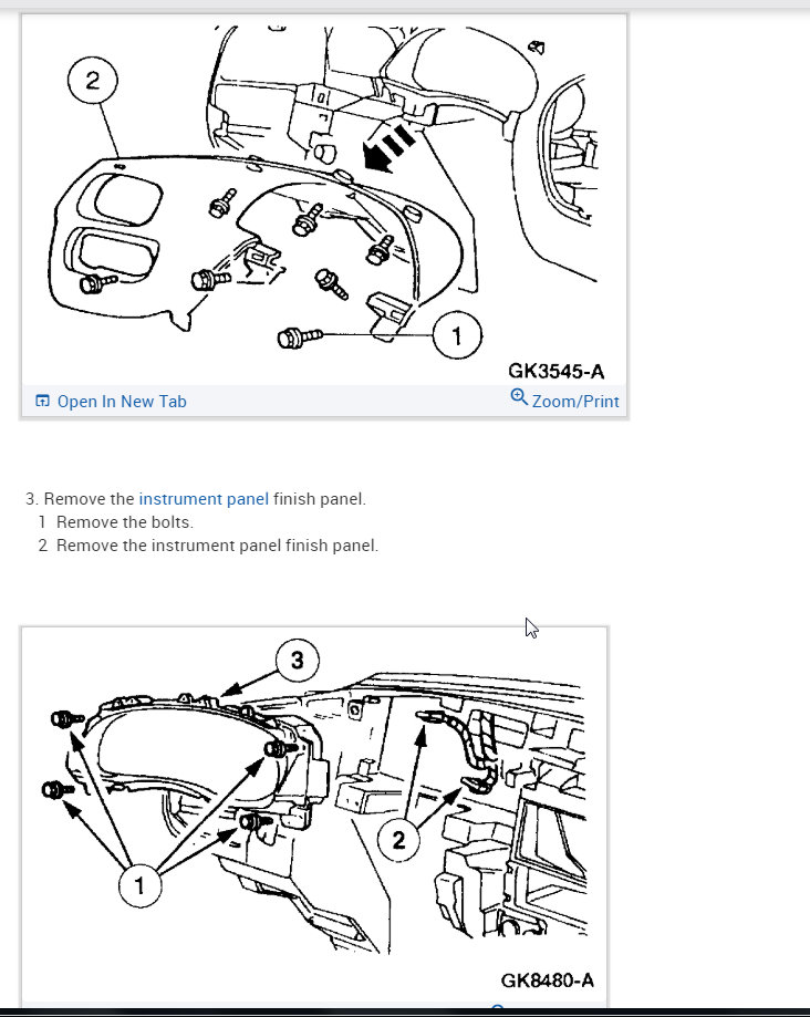

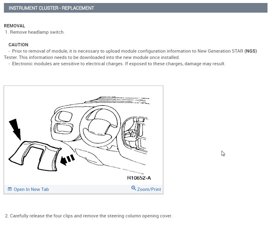

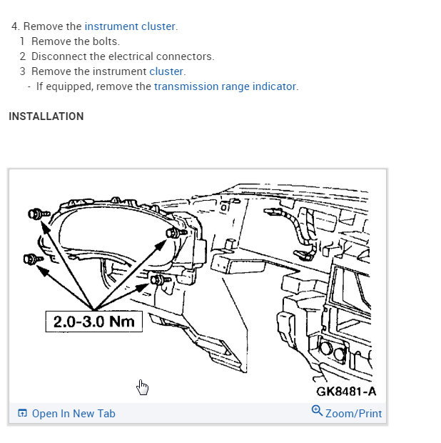

Unfortunately the way your gauges and lighting works is they are contained in the cluster. Each gauge gets a signal directly from the sensor so to have all of them out, the only common denominator is the cluster.
There are no relays for the cluster so based on this information, I would put a cluster in it. Let me know if you need more information. Thanks
