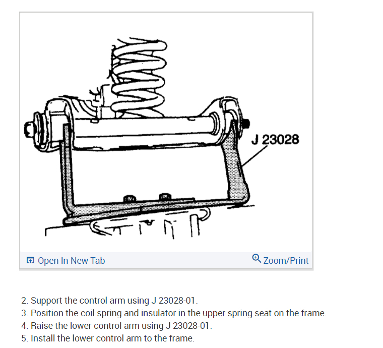

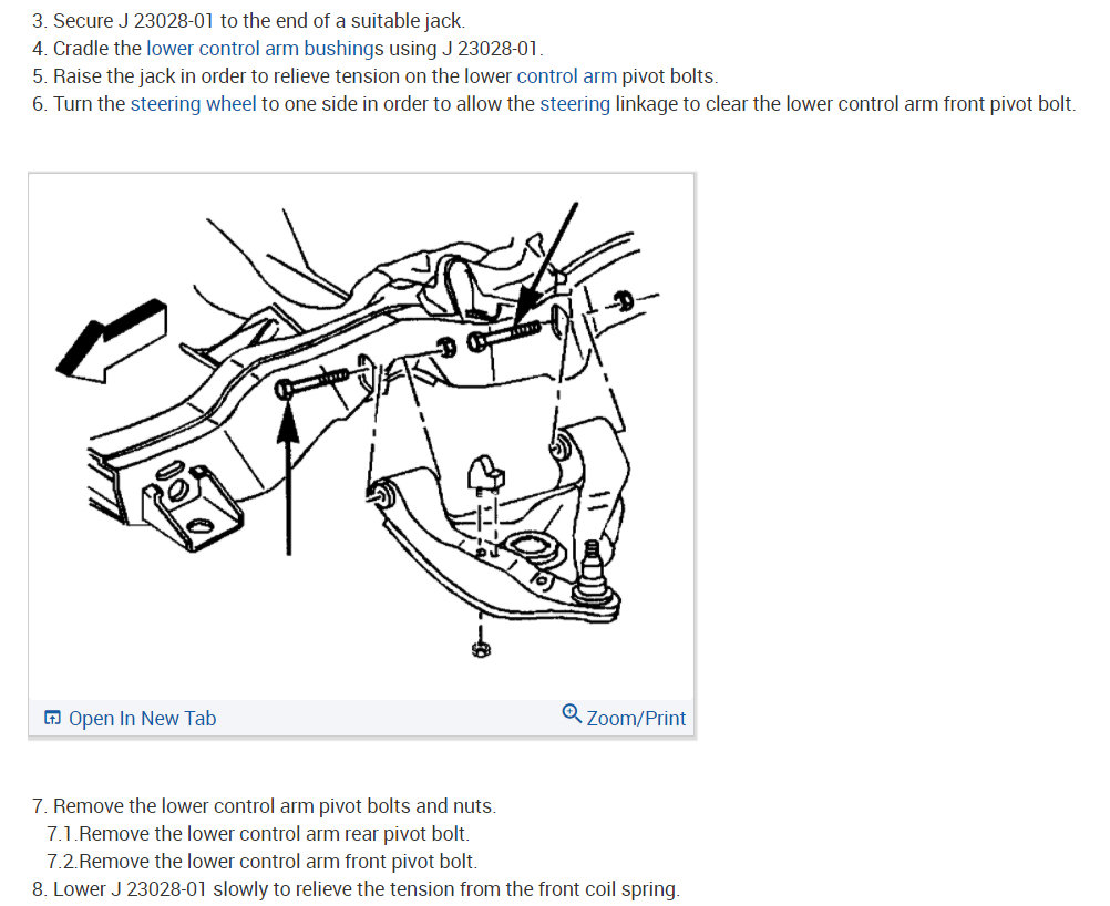

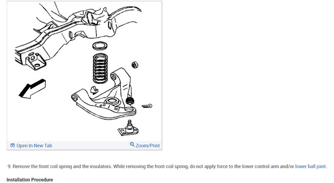

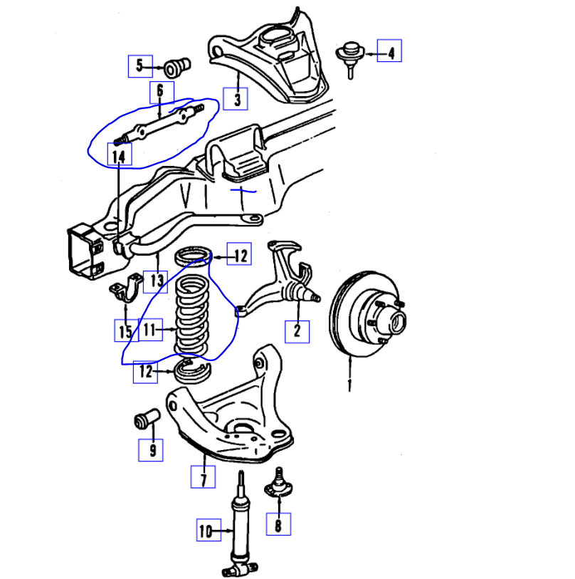

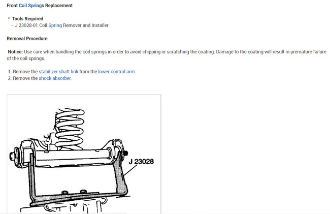

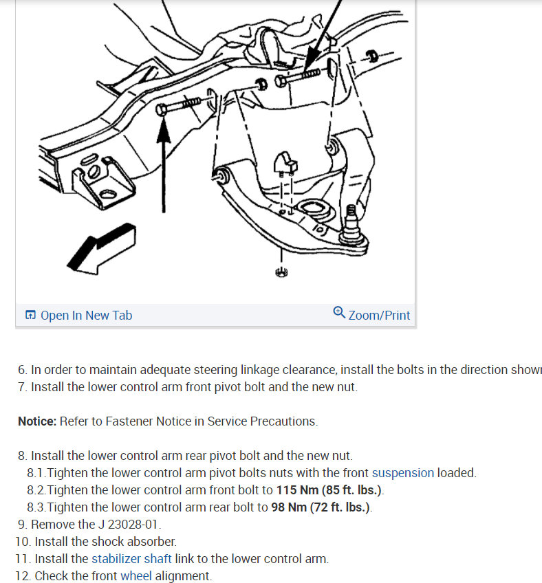

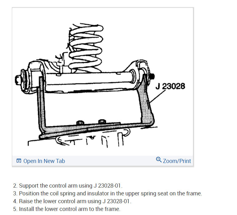

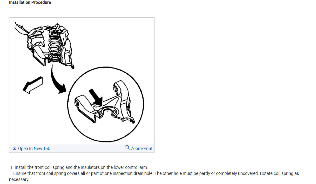

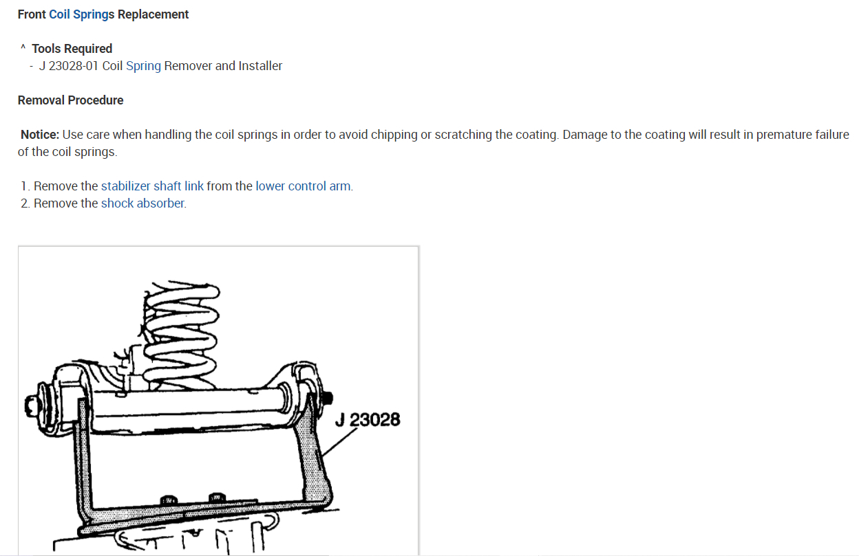

The front driverside looks as if it's a couple inches lower than the rest of the truck. Looks as if it's leaning. Also the top of the driverside tire seems to be tilted in at the top.
Apr 13, 2021 at 8:22 AM
Good evening,
This sounds like a weak coil spring for sitting low. I attached the procedures and some pictures for you.
https://www.2carpros.com/articles/popping-noise
You will need a wheel alignment when complete to straighten the wheel up.
