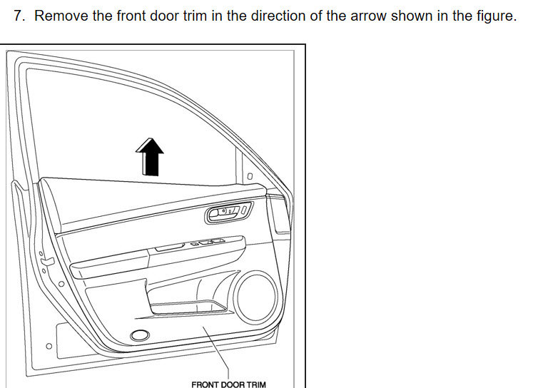

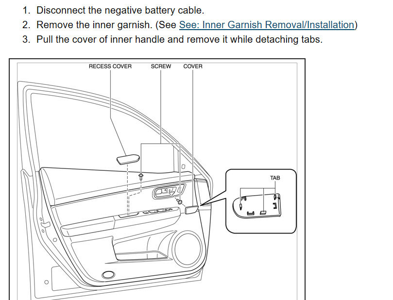

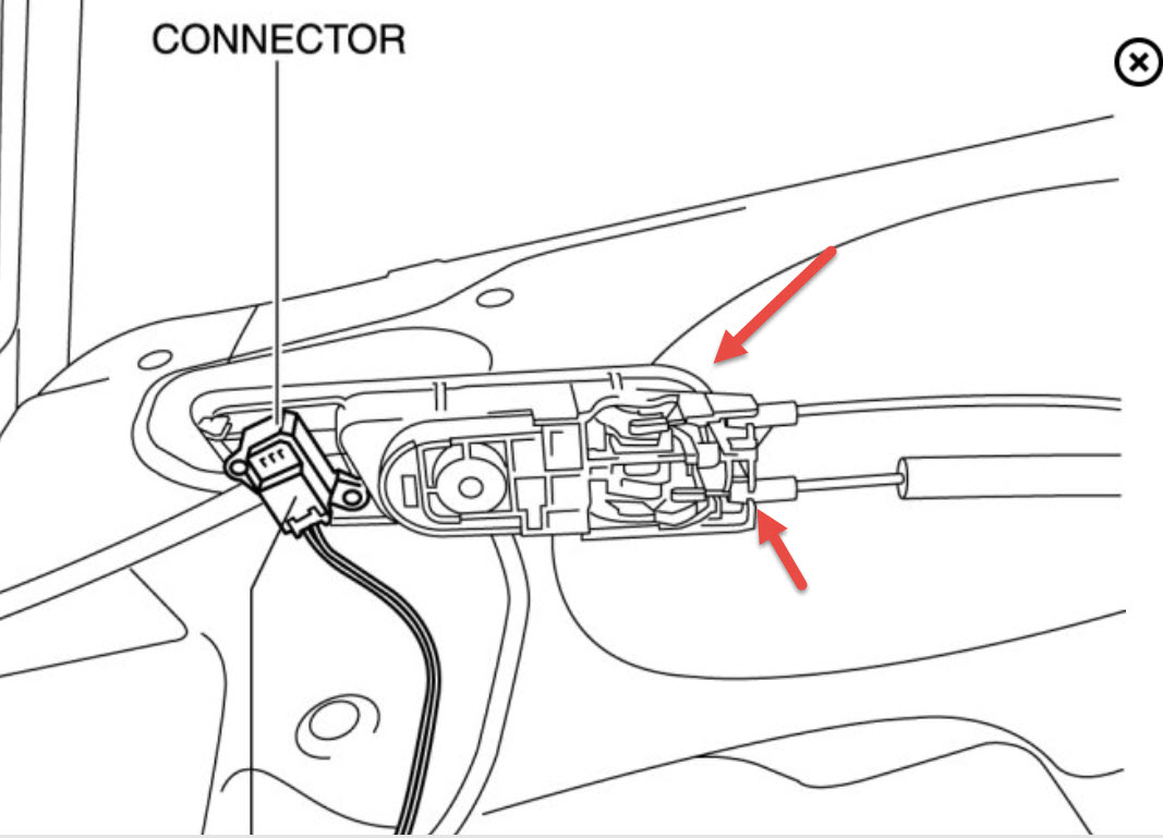

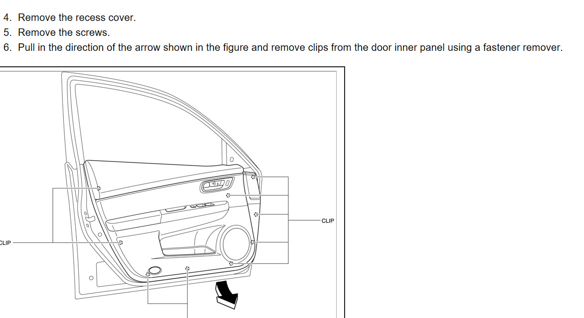

You can not open the driver's door from the inside to exit the vehicle, you can open it from the outside to get in. you can lock and unlock it.
Mar 30, 2017 at 5:04 AM
HMAC300
  • 48,601 POSTS
you have to take the door panel off the inside then check for a broken cable or slipped out from handle or latch. Check out the diagrams (Below). Please let us know what you find.
