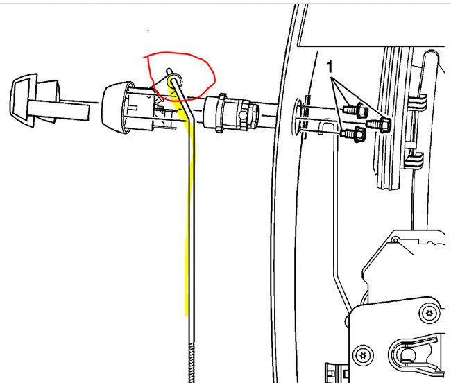

Chances are the either they broke the linkage rod or caused it to come disconnected. If you look at pic 1, I circled where the linkage attached to the door. I highlighted the linkage rod I'm referring to. I suspect that rod is disconnected at one side or the other.
What needs done is to simply remove the door panel and inspect that rod. They could have broken the handle, but that is unlikely.

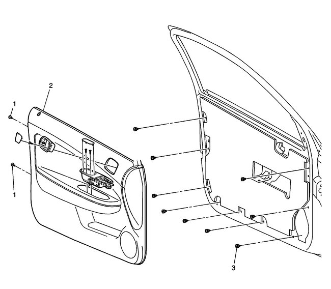

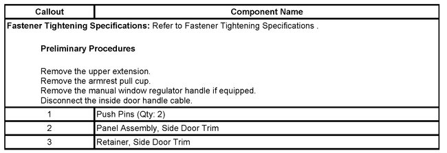

For door panel removal and replacement, refer to pics 2 and 3.

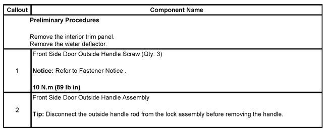

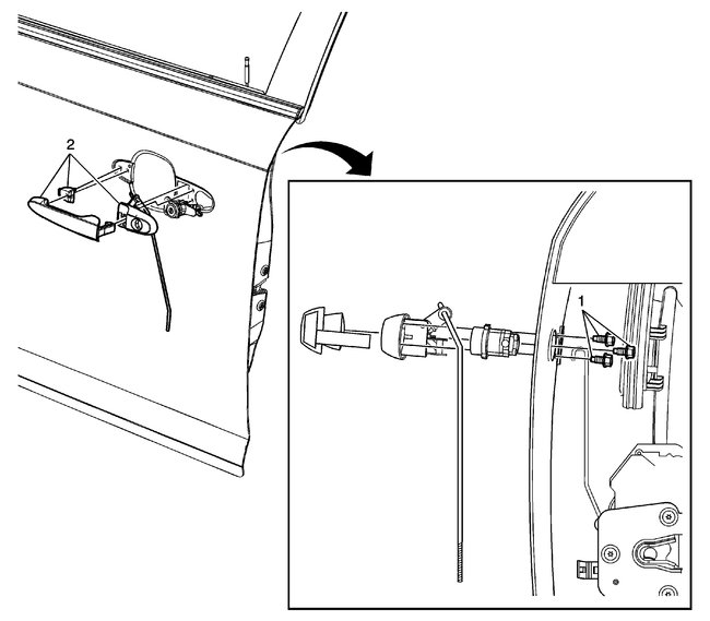

If by chance the handle was broken, pics 4 and 5 explain how that is done.

Inside the door panel there is a skinny rod. It's attached to something near where door breadbasket m handle is, the bottom of rod is just dangling. Should bottom of rod be loose or attached to something?
Apr 28, 2020 at 1:53 AM
  • 110,248 POSTS
That should be attached to the door latch assembly. That is why it isn't working. There should be a lever on the latch assembly it attaches to. If you can't locate it (I can't find any good pictures) let me know.
