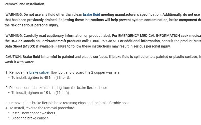

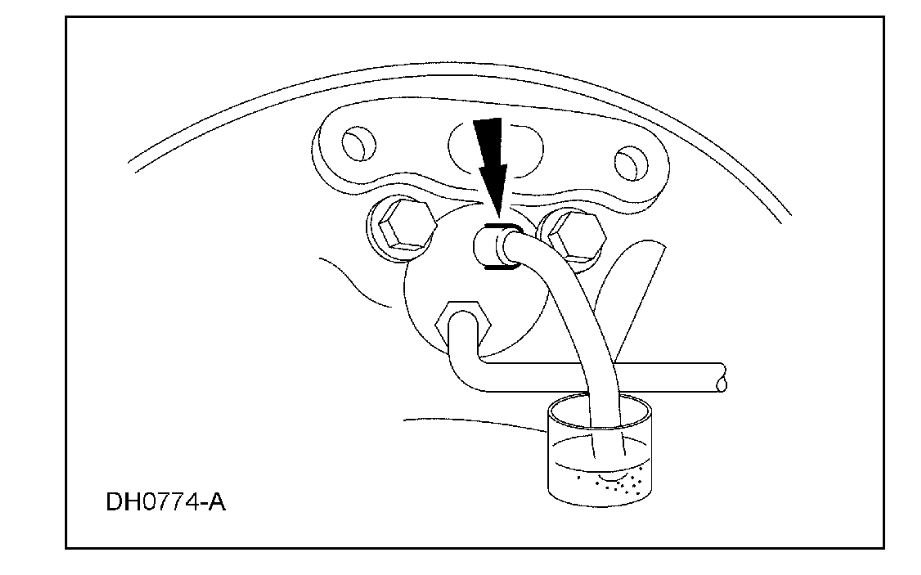

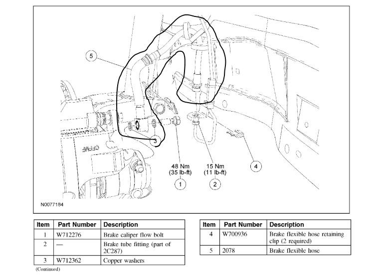

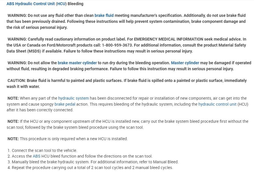

Good evening,
Good chance the brake hose is collapsed causing the brake to lock up. I would change both sides and flush the brake system. The old dirty fluid is what causes this issue. This happens when the brake booster push rod is adjusted out too far which does no allow the brake master to return fully holding the brakes on . To confirm the issue loosen the brake master mounting bolts 3 turns to see if the car starts to roll again, if so remove the master and adjust the booster push rod inward. Also a brake flex hose can come apart internally causing a short of check valve in the system but this is usually isolated to one brake either front or rear.
https://www.2carpros.com/articles/how-to-bleed-or-flush-a-car-brake-system
