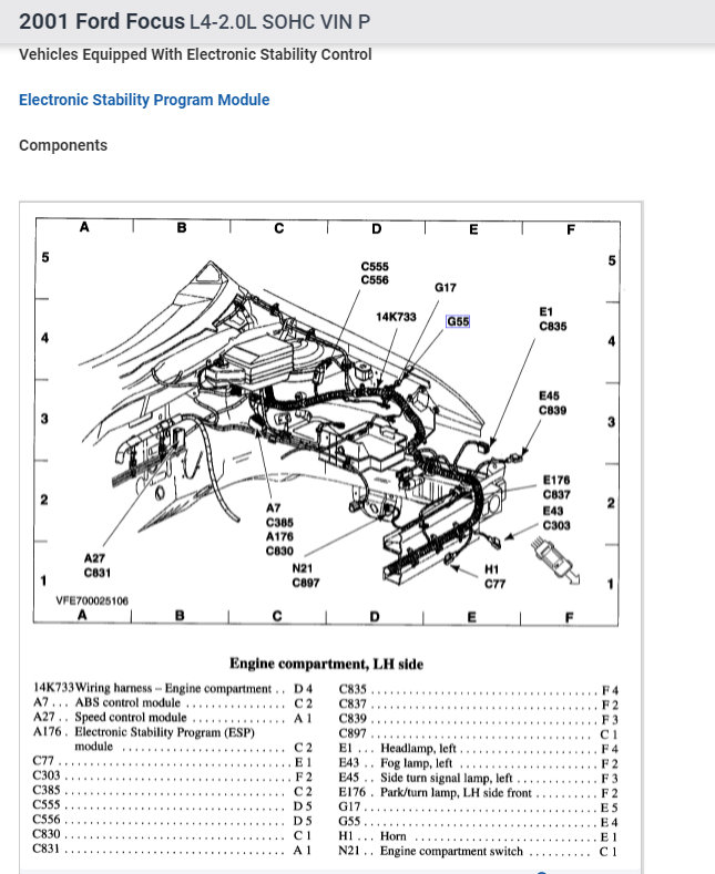

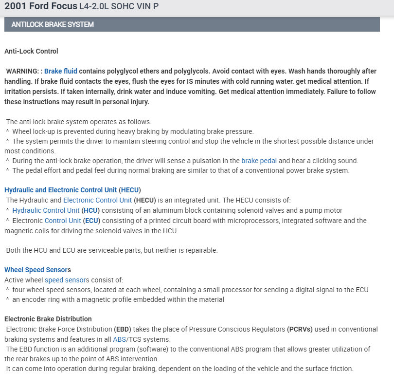

It sounds like the lock up might be getting triggered by the ABS system.
The ABS module could be malfunction as it gets hot and triggering the lockup.
You might want to scan for ABS codes if the light is illuminated. It can help with the diagnostics.
