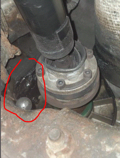

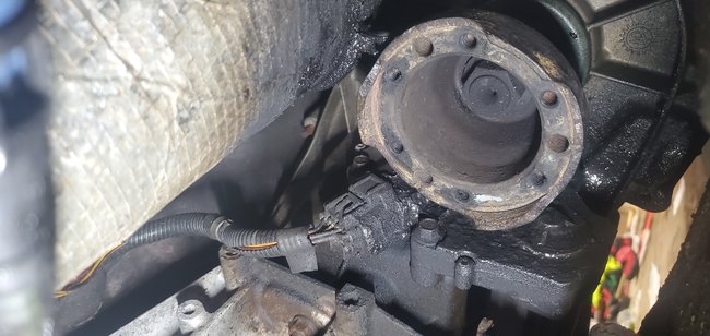

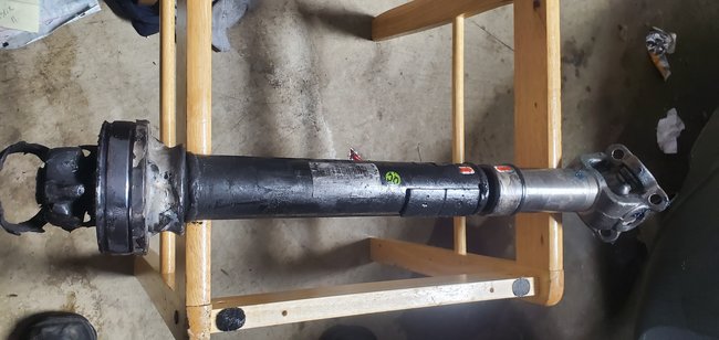

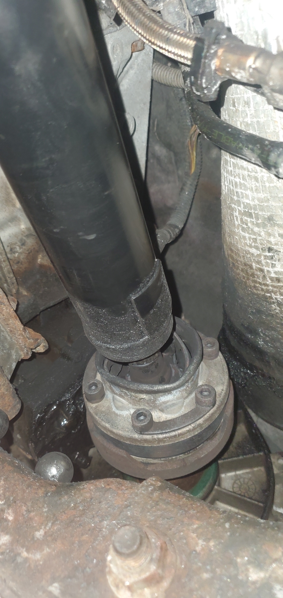

So I checked the transfer fluid and it was maybe 1/2 qt low. I did check the drain. Plug just to see how the fluid looks. It doesn't look burnt or smell burnt and looks relatively clean. I checked for play in the output flange on the transfer case and it seems pretty tight has some backlash play when I spin it in forward and reverse. The front differential flange is tight as well. Again some backlash in it. I did engage and disengage the transfer case and it does lock up like is should to engage and disengages properly. So I know that it not like it's hanging up. Here's a couple photos I took before I took the driveshaft off you can actually see the bearing sitting on the cross member. And how the end of the drive shaft look after I took it apart. And I never saw the photo of the fill and drain plug on the transfer case but I'm pretty sure I checked the correct one.

I attached one of your pics and circled what looks like grease. Is that the grease from the CV joint?

Yes it is. The driveshaft actually had a rubber boot on that end that came off and flung the grease under the truck everywhere. I'm not sure when the boot actually came off because it was only on the truck for less than 3 weeks before it went out.

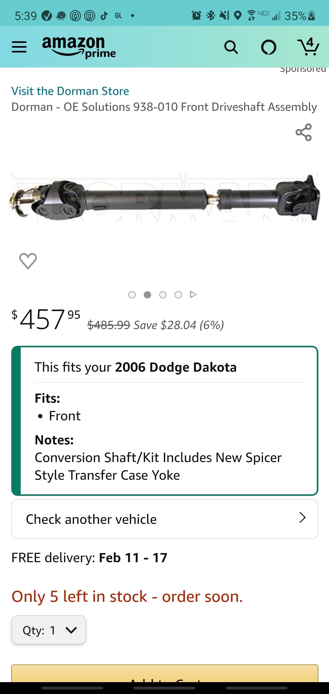

I purchased a complete driveshaft from bodeman. Completely assembly with grease on it. It was just under $200.00. I'm think about trying to upgrade the driveshaft which I will change the yoke on the transfer case. Picture below is what I'm looking to purchase. I'm not sure how difficult it is to change the yoke on the transfer case though.

When you say yoke, are you referring to the female end on the driveshaft? Also, was the vehicle ever in an accident or did you check to make sure transmission mounts are good? I'm starting to question if something isn't properly aligned.

When I said yoke I meant output flange on the transfer case. I would have to change it to replace it so that I can put an actual u joint to the transfer case. The mounts looked okay. I was actually looking at those today. I'm not sure if the truck was ever in an accident I'll have to see if I can pull up a carfax report to check.
